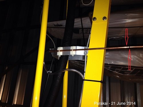

Seriously though...I have been experimenting (and reading what I could find on the internet) with a static on my gyro where the ASI has always over-read by 10- 15 MPH for the reasons posted above - ie. no static and a negative pressure build up behind the panel.
I took a copper tube, drilled four holes and blocked the front of the tube. The 'secret' I finally discovered is to place an O ring in front or behind the four holes to create a high or low pressure which will 'adjust' your airspeed indication. Be aware of your altitude above sea level. I am at sea level which makes it easier. A 1mm or less movement of the O ring makes quite a difference to the ASI reading.
O ring in front of the holes for ASI (creates lower pressure) over reading and behind (creates higher pressure)for ASI under reading.
It took around four flights to find the correct position for the O ring. My ASI is now accurate to approximately 2-3 MPH at sea level.
A small collar around the tube would be a better long term solution as I expect the O ring will deteriorate over time.
