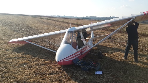

Postby Luan » Tue May 20, 2014 12:43 pm
So I finally found someone who has flown a few challengers and has done instruction on a clipped wing 503, and was about to start my training, just the fairy flight with my new instructor in the way... and so I present crushed hopes and dreams in visual format:

Sorry about your oops. Dont let this small event kill your dreams. From here the Challenger looks very fixable. Were are you situated. Lets see if we can help.

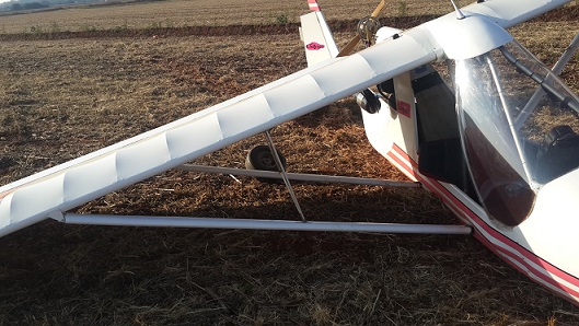

Thanks guys you are a real great bunch of guys! No one was hurt, and that is the most important. I was not on-board, I was half way to Rhino for my first flip! What happened was: The plane was flown solo by 3 other pilots in the last month or so, other than not climbing to well with the 503 they all experienced a buffet/oscillation at around 70mph. Neither under nor above. When my new instructor felt this he thought the tail and/or elevators were coming off and made for the nearest mielie field.
Now why the buffet, having never been able to fly the thing I have no idea how to describe it, but talking to Pieter De Necker about the belt drive and its ratio he remarked that a drive and gearbox should never be exact numbers, such as 2.0 or 2.6, otherwise at a certain speed and rpm there exists a resonant frequency which would cause all sorts of vibrations, but only at a certain speed/rpm. After sending some pictures to the Challenger factory they asked where my trim tabs on the elevator are, there must be one each elevator one trimmed up and one trimmed down, the person I spoke to simply builds them, and cannot tell me why they must be there. Perhaps someone a little more knowledgeable could comment?
I thought it was going to be millions and billions to fix, as I was towing the last pieces of her out of the mielie field with a flatbed trailor at 11pm, stopping at a robot they smashed my window and also damaged my car a bit, I was ready to call it quits. I woke up, saw the wreck in my yard and before I could help myself I was emailing Challenger in America. The good news is its a kit aircraft and the parts are all still for sale, I will have to learn a lot, for instance how to patch that Ceconite stuff its covered with, I will need to find a building area close to my house other than the garden, dismantle large parts of the fuselage to replace the broken brackets and so on... it will be a slow process...
Thanks for all the support guys!!!

If you live in the Gauteng area I have a friend that can repair the fabric for you. He is an aircraft rebuilder / builder. He has just repaired a damaged Challenger for us.
The only thing I can think of that would cause an oscillation at that speed is that the elevator cables are to slack.
Check the tension before anything else. There must be no play at all. Do not over tension them as well. Just enough that all the play has been removed.
