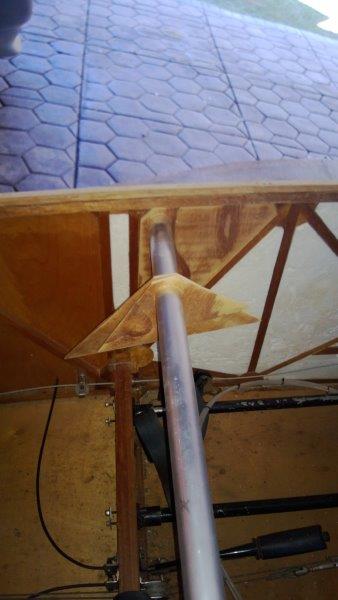

Re: Rotax 532 powered KR2

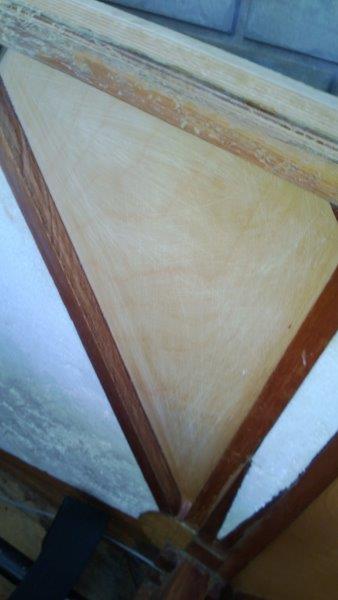

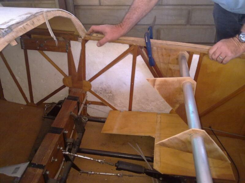

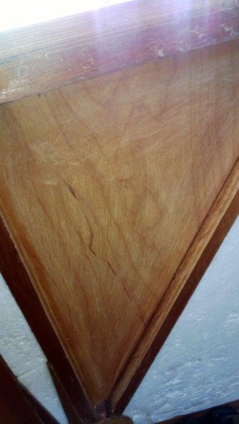

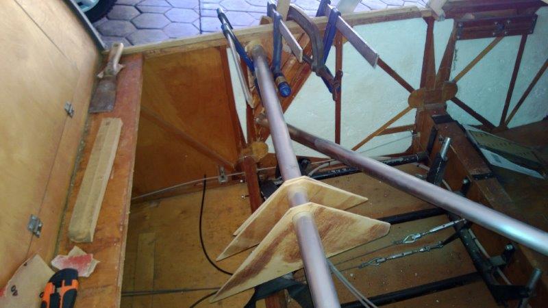

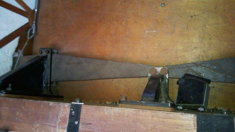

Hi Andre,
Ja, dit spaar my om brackets te maak en sodoende hoef ek ook nie gate in longerons te boor nie. Verbasend hoe lig alles is. Ek is seker dat brackets meer sou weeg. Boonop word die las nou oor 'n groot oppervlakte verplaas, so dit behoort nogal redelik sterk te wees. En dit moet wees, want ek wil die skouer harnasse daaraan heg.
Lekker nagrus vir jou my vriend,
Henni
Henni

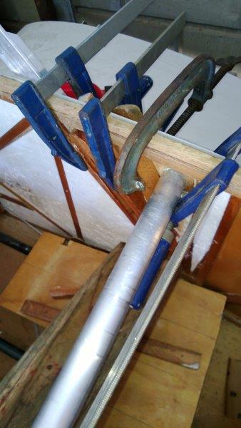

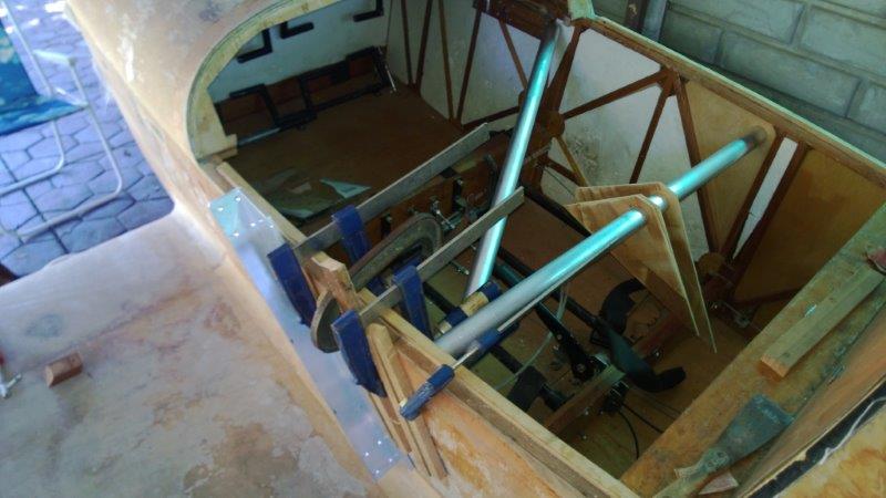

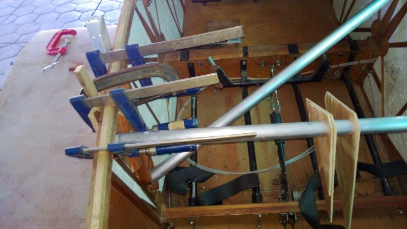

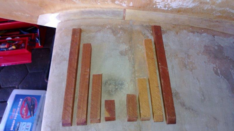

Hi all,

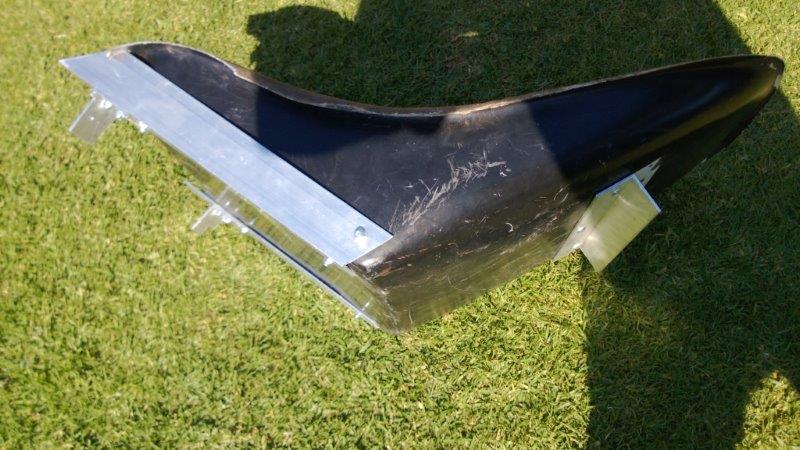

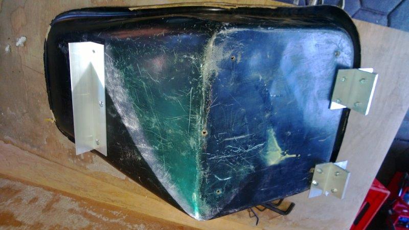

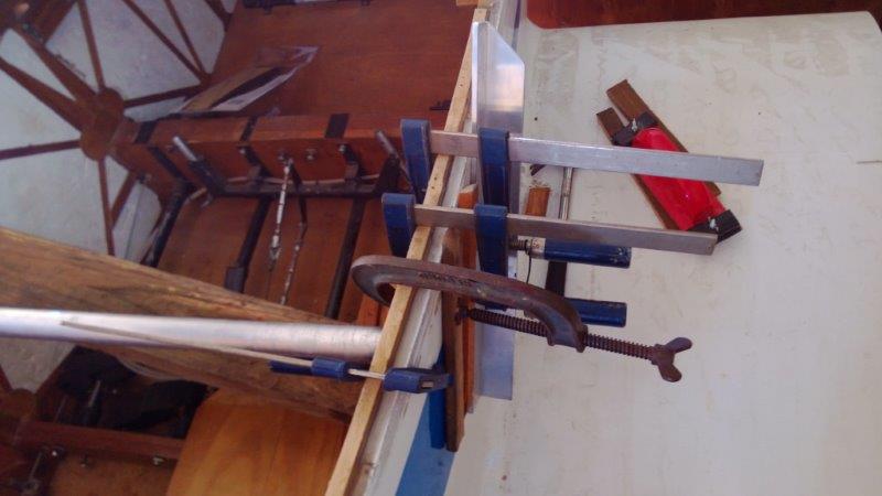

This is where I stand after today. I can only do the one side for the day as I want to make sure the glue is set completely before I tamper with the other end of the tube. Late this afternoon it was still tacky, so I'll rather leave it till morn.
I had my hands full between the clamps & the clamping blocks - I needed more hands to hold everything before I clamp it, but managed in the end. When done, I'll stand on the tube to verify the strength of the installation. As always, the caption below the pics says it all.
Man, it's so frustrating that such simple tasks take so long. I don't want to build, I want to fly! The only reason I'm building is because for the moment it's the only way towards flying...
Keep well all,
Henni
Keep well all,
Henni

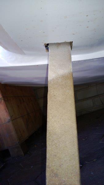

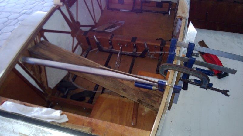

Hi all,

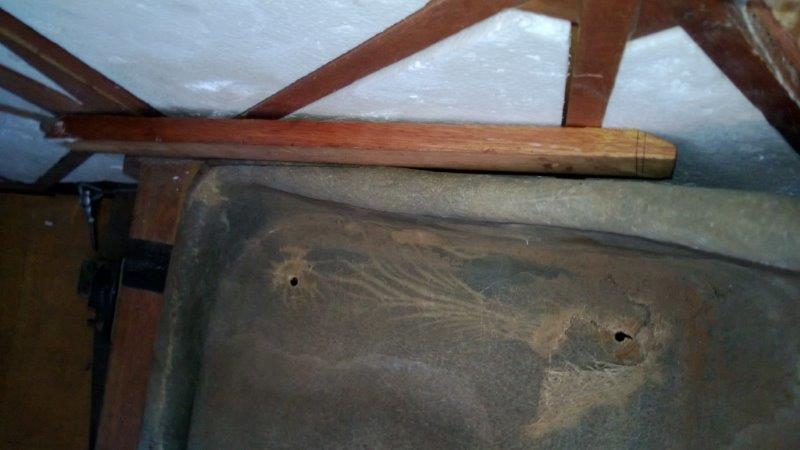

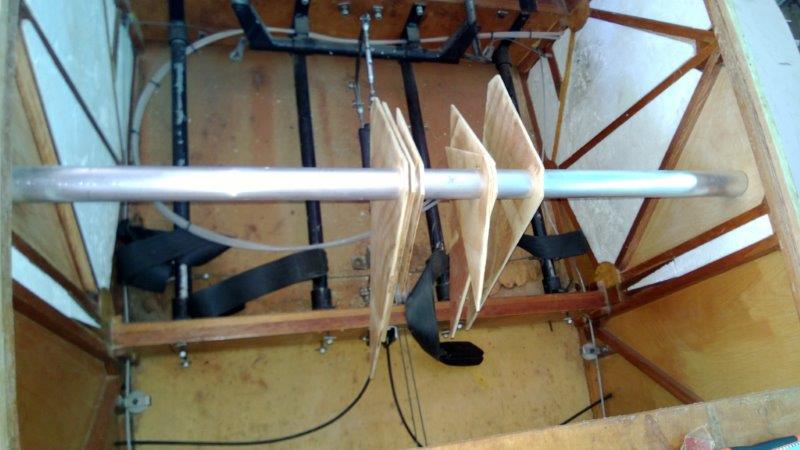

Amazing how quick this side took compared to yesterday. Was finished by early morning. Seeing that this is a critical bond and also that it is a public holiday, I'll leave it at that for today. I am not only going to support the seats to the rear with this tube, but also downwards. I'm going to attach a bracket behind each seat that will allow it to also hang from the tube. The only other support to the seats will be the strong hinges I'm going to make to the forward spar attaching to the forward section of each seat. On top of this, it will also be the support for the shoulder harnesses. So this tube has it's job cut out for it in a serious way! I had a real shock when one triangle block did not fit after I've applied the glue - had to sand it to fit in a mad rush!
I'm changing my mind as I go along. Because the wings are built completely out of wood, I have no easy way to create a walkway without opening the wings. If I have to open it, I might as well build fuel tanks into the stub wings. I have some idea in mind how to do this neatly and easily. Will explain more when I get there. If I do this, I can use the space below the seats for luggage. It will easily accommodate a rather big suitcase on either side, if the engine can lift it from the ground. Keep in mind that this KR2 will be at least 150-250lbs lighter than most others and still has the full 64hp available that it was designed for.
I'm also doubting whether the added weight of a nosewheel will make a big difference to the landing gear weight in the current configuration...maybe I'll even leave as is. The current landing gear is built and attached like a tank. Will absorb bad landings with ease! In any case, will finally make up my mind when I get around to that section.

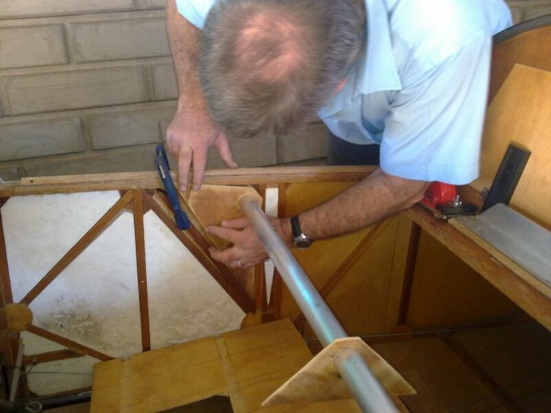

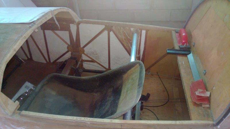

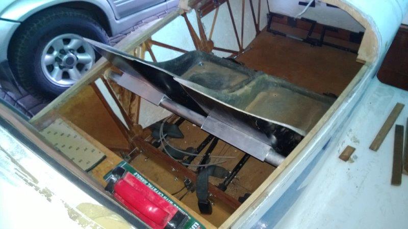

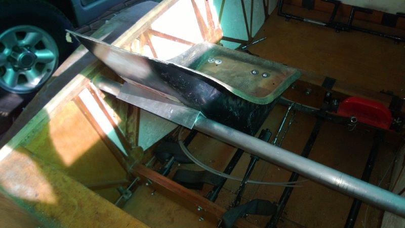

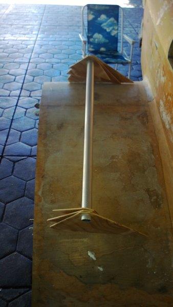

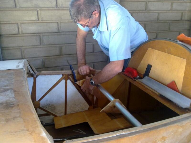

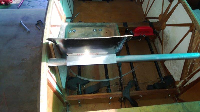

Hi all,

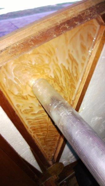

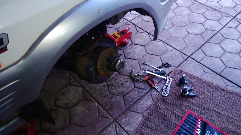

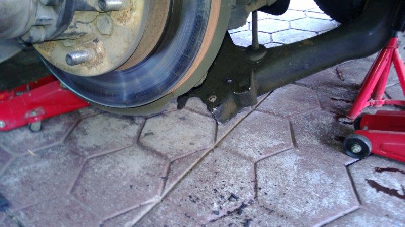

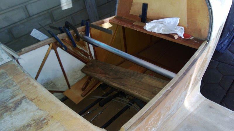

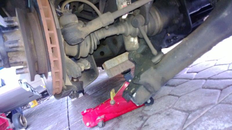

Today, my task for the day was chosen for me & I had no say in it. Last night, when we travelled back from visiting, the lower ball-joint failed on our vehicle. It happened as we pulled away from a robot. The result was that the wishbone stuck into the ground with the wheel stuck to the top inside of the fender. Had it happened on the open road, she would have been a write-off & we in the hospital.
Two weeks ago we were running late for an open air outreach. I always drive at the speed limit, but then we did 160 km/hr for 70 km. Had it broke then, we would have been dead for sure!

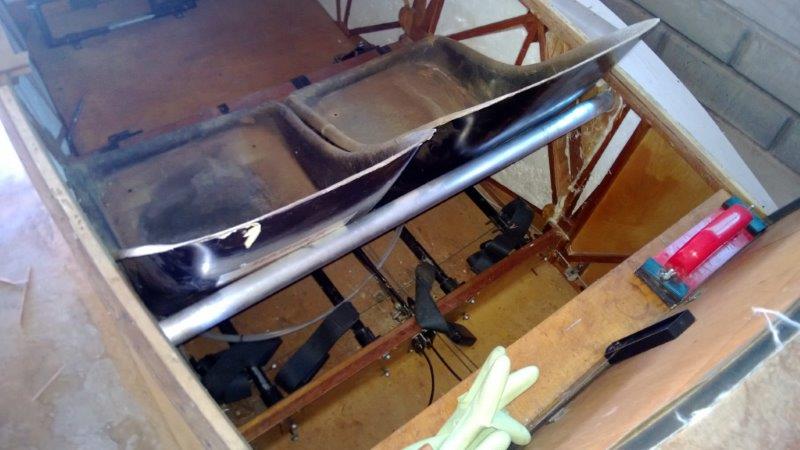

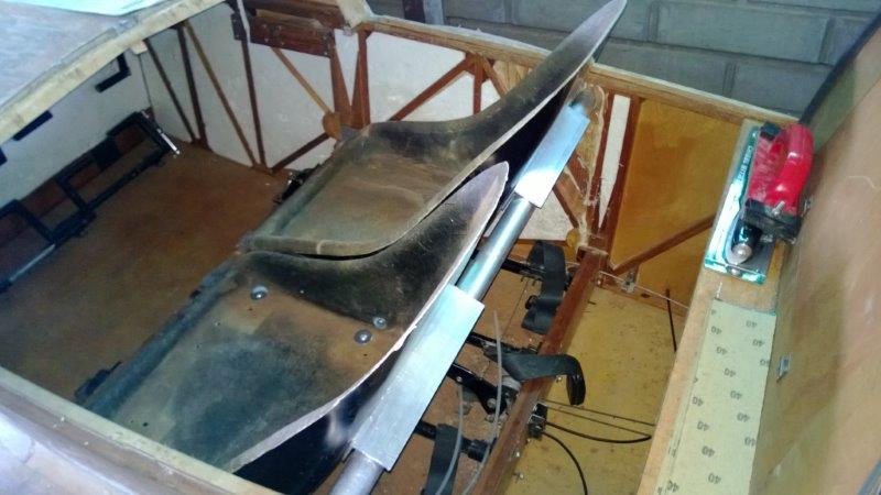

So, finally my seat tube is in. I must still clean off all excess glue, but the pics tell the story for now. Next is to make the seats fit next to each other and then to make the strong front hinges from 6mm thick angled aircraft aluminium and attach these to the main spar and to the seats.
Just see how much space is left below the seats! Ideal for a luggage or fuel compartment. All in all it worked out as planned and I am more than happy with my idea. Hope the others work out equally as well. I'm anxious to start with the canopy widening part as after all this is REALLY what this is all about.
Cheers everyone,
Henni
Cheers everyone,
Henni

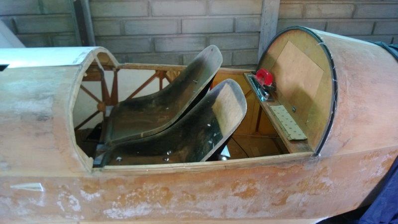

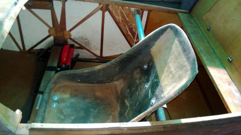

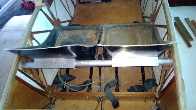

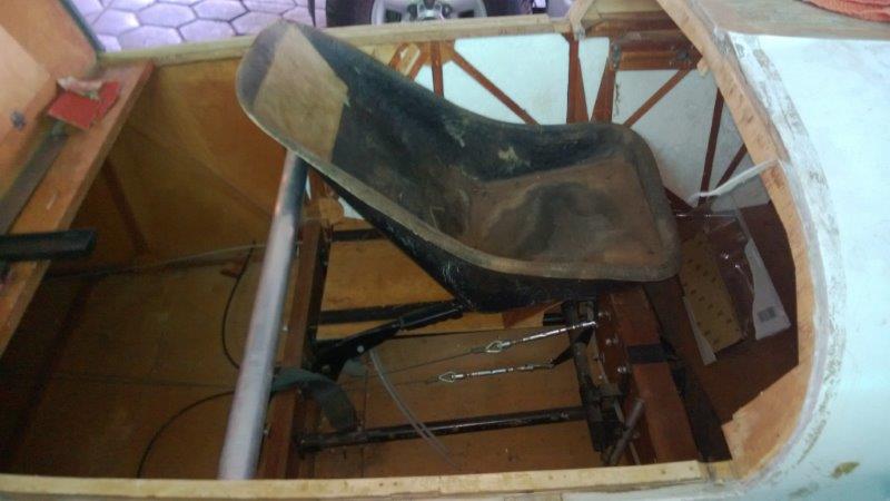

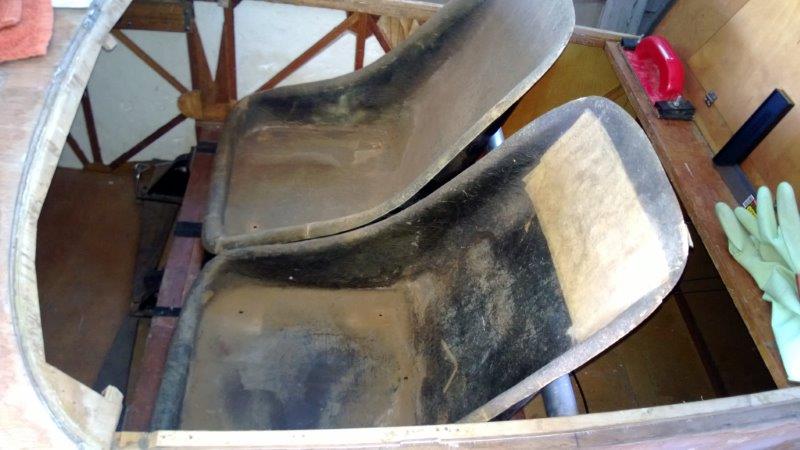

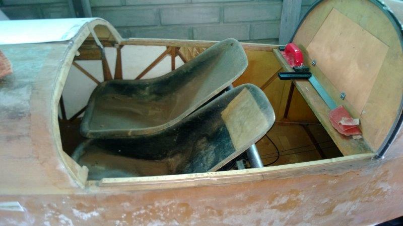

Hi everyone,

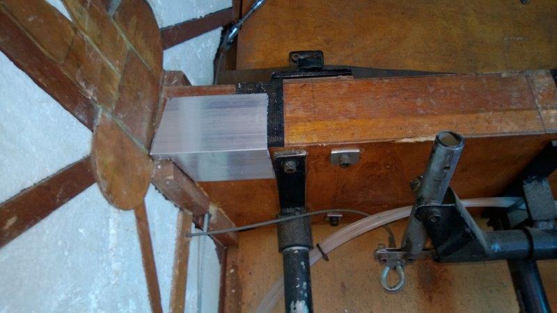

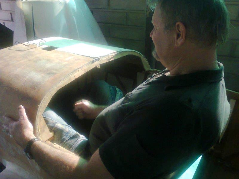

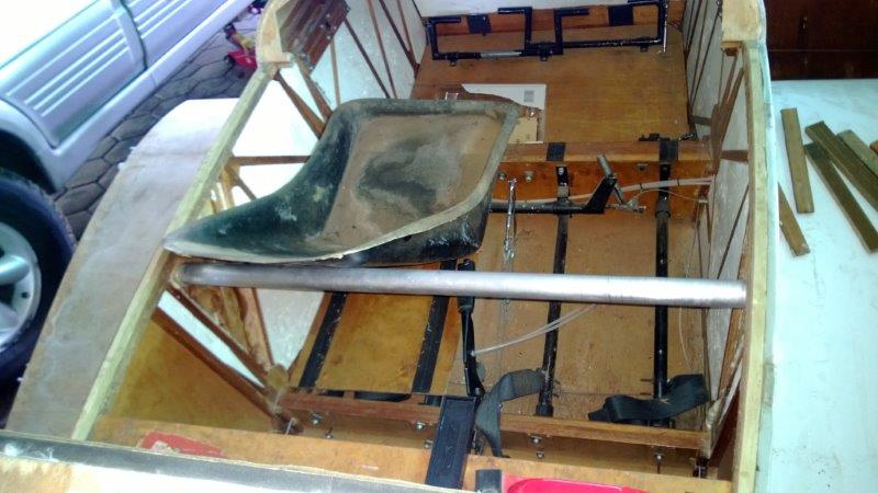

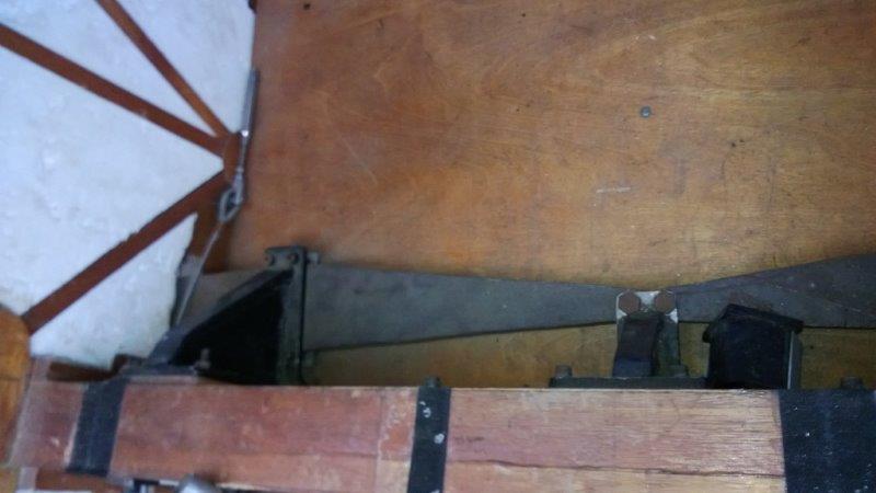

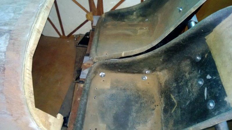

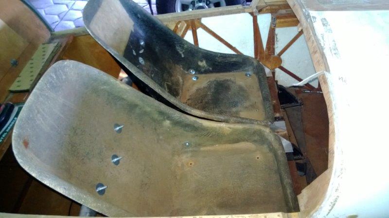

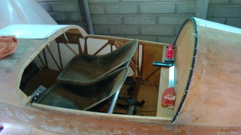

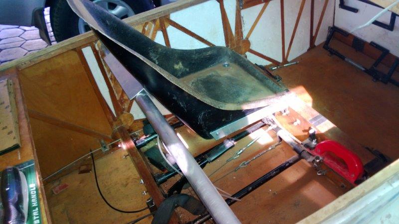

First seat is in permanently. Decided not to hinge them. Instead they clip into position. I can just lift out if it should be required.
As always, the caption below each pic says it all.
Cheers all,
Henni
Cheers all,
Henni

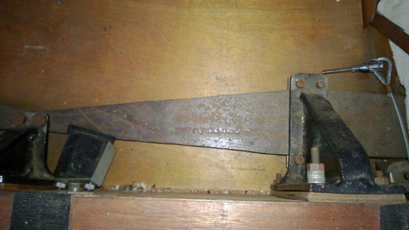

Hi Henni!
Glad you did not have an accident with the lower ball-joint failure!
I see your landing gear mounting is the same as VYZ, it is really solid, I can attest to that......
The seat is looking good, at this rate it won't take long to get the mod done, then you can get stuck into the engine and panel installation.

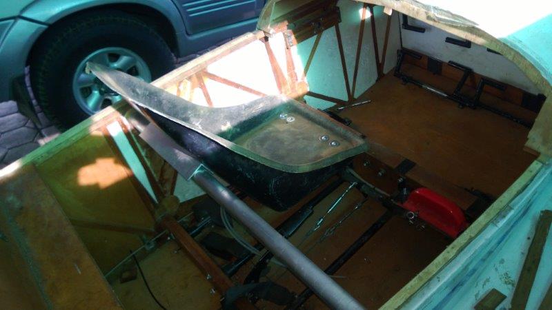

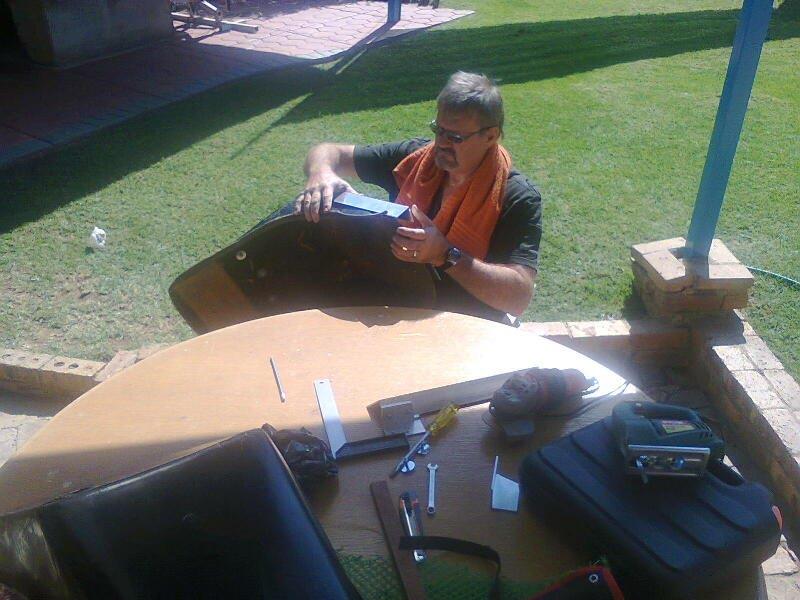

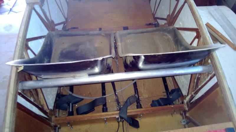

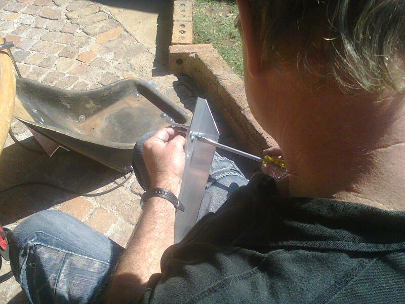

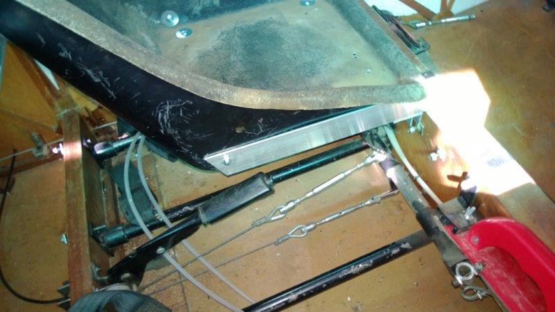

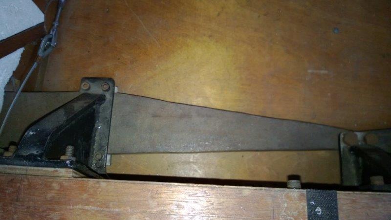

Hi all,

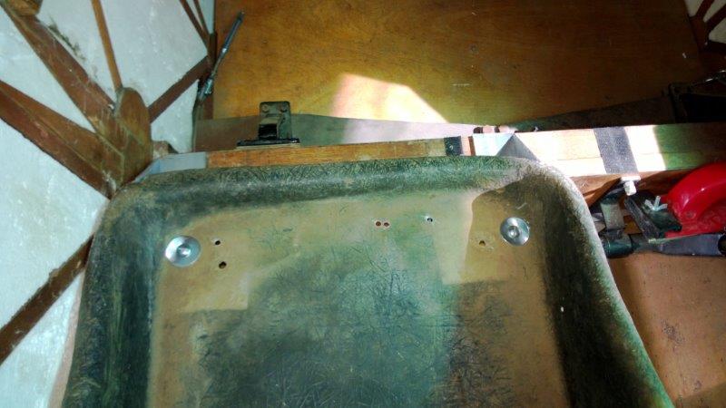

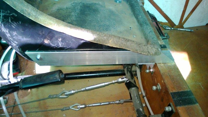

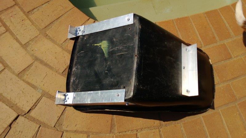

Wasn't happy with my seat attach brackets. There was no ways that it could withstand 7g's! So today I made a complete new set. Now they'll withstand those g's along with the rest of the aircraft.
Yeah, I know, waisted as whole day. But at least now my seats won't give in from under me during high g turns. All in all I'm glad I re-made these.
As always the caption below the pics says it all.
Keep well all,
Henni
Keep well all,
Henni

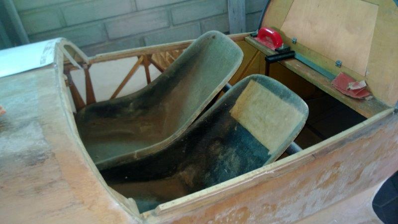

Hallelujah!!!
The other seat is 90% done! I am elated - soon I can tackle something else.
Cheers all,
Henni
Cheers all,
Henni

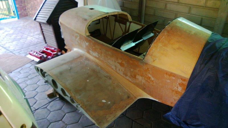

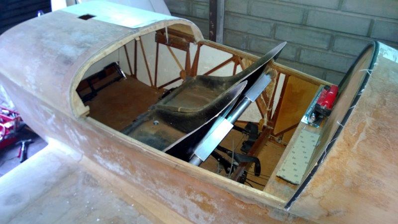

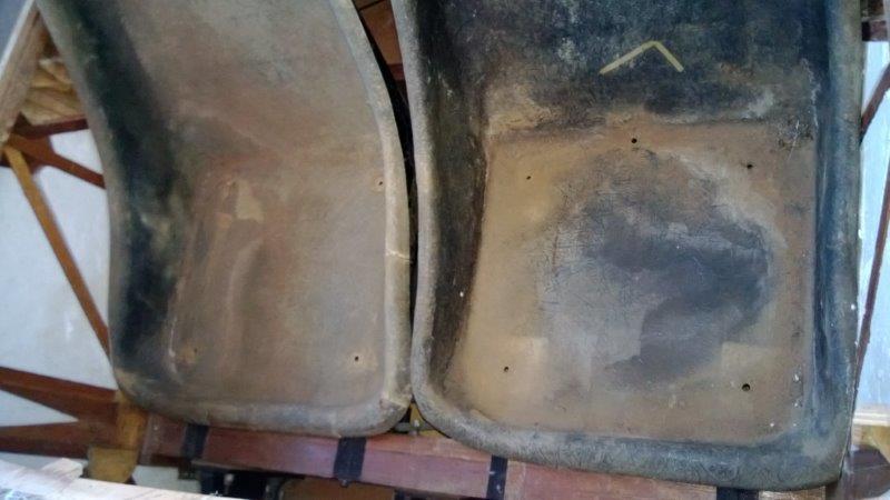

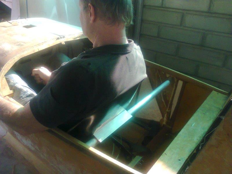

Hi all,
Just for fun: Some before & after pics.
The centre flap handle clearly shows how far forward the seating position has been moved. Next is to finish off the 2nd seat, make holes for the control sticks. Then I can cut away the forward turtle deck, cut open the firewall, move the rudder pedals forward and then start with widening the canopy.
When done I'll add the fuel tanks below the seats (hopefully standard off the shelve plastic fuel containers). Then I can start to concentrate on the engine installation. Slowly but surely my idea is coming together.
I just had an excellent weight saving idea to replace the wing walk area: I can mount a foldable aluminium step to the side of the fuselage just forward of the wing. Should be easy to make, have very little drag & be very light. With my seats being so far forward, this would be the ideal position to step onto to get inside the cockpit.
For whatever it's worth, I've gained close to 100lbs just by my engine choice alone! The rest of the airframe is built very light. The canopy windows will be made from lightweight lexan with a centre piece down the middle front to help with the wind pressure. I'll start weighing everything soon with the engine on the seats and then post the figures over here. It should give a rough indication of where I'm headed.
