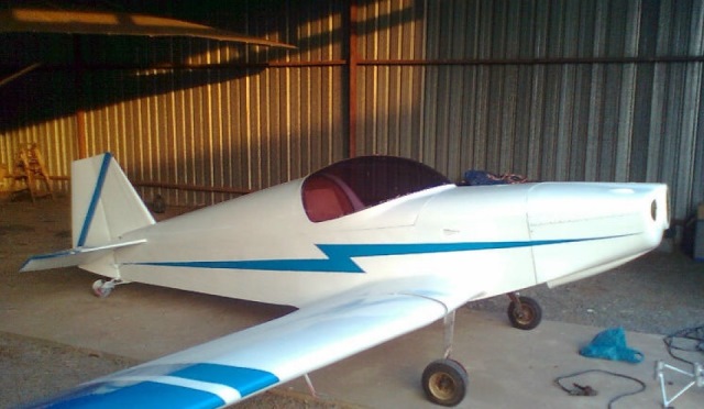

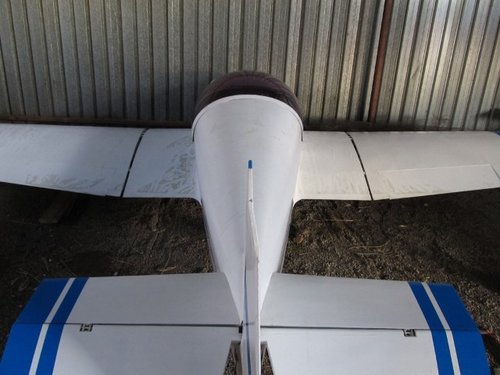

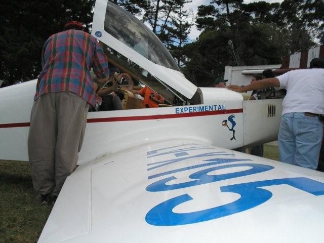

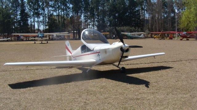

Hi all,
This is a 582 Rotax powered KR2 from another part of the world.
Henni

OK is it just me or does that cowl look FUGLY.

Yip J,
It certainly does not look modern. I'll try my best to keep the top cowl flat. The Rotax uses a longer prop. so I'll mout engine as high as possible with maybe increased gear lenght. Will see when I get to it.
As you can see the ailerons are wider, but not full span. She also has split inboard flaps which is great. I'll fit VCs on top of wing for even better stall performance. I think she'll turn out light, stall right on design figures at around 40 - 45mph & not require too much runway. Top speed wise she should be the same as a normal aspirated VW KR2 as she'll be much lighter and fly at a lower aoa. At the light weight, she should also be a breeze to fly. Really looking forward to completing her.

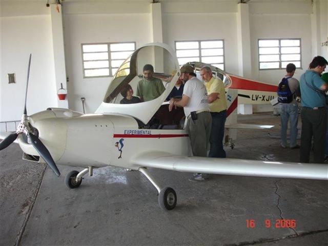

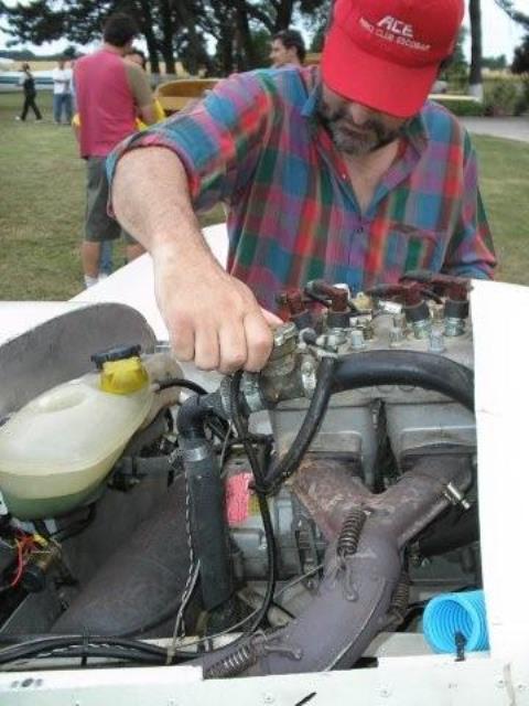

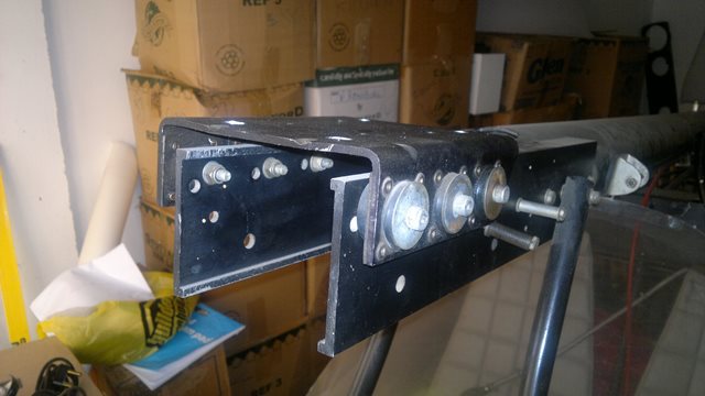

Hi all,
Here's my previous attempt at something similar.
I have a few questions please:
1. Where can I buy aircraft grade aluminium angled strips to use for engine mount?
2. Where can I buy flat, thick aircraft aluminium to bolt onto engine attach points?
3. Where can I buy rubber engine mounts for same?

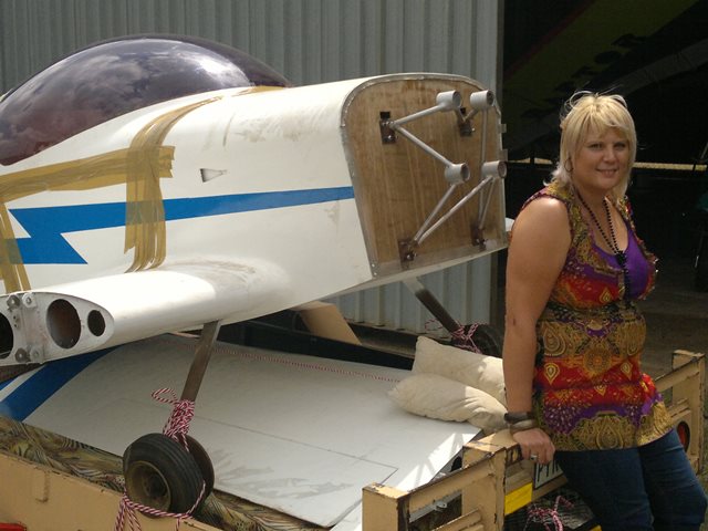

4. I am thinking of installing fuel tanks in front of cowling behind engine for cg purposes. May this be done? In most older microlights, the fuel is stored directly next to & above a running engine. I'll use 25l plastic containers for this if allowed to do so.
Pic shows how I intend installing the engine, same as Lance did over here & shows what materials I am enquiring about above. Mine will just be much further away from the existing firewall.
That will be it for now. Tx for any replies & advice.
Henni

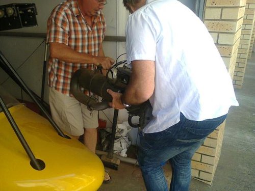

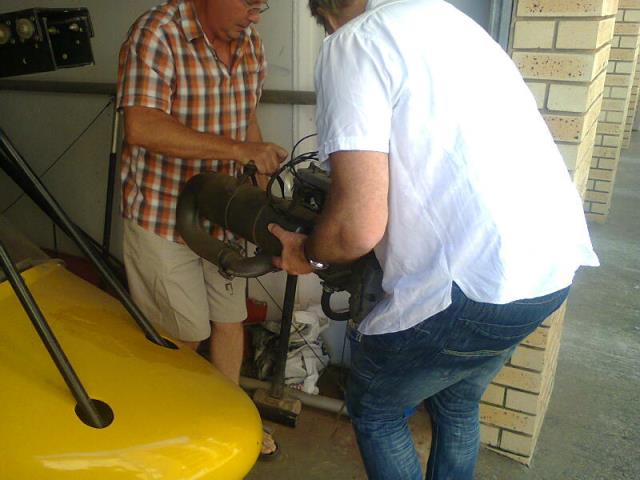

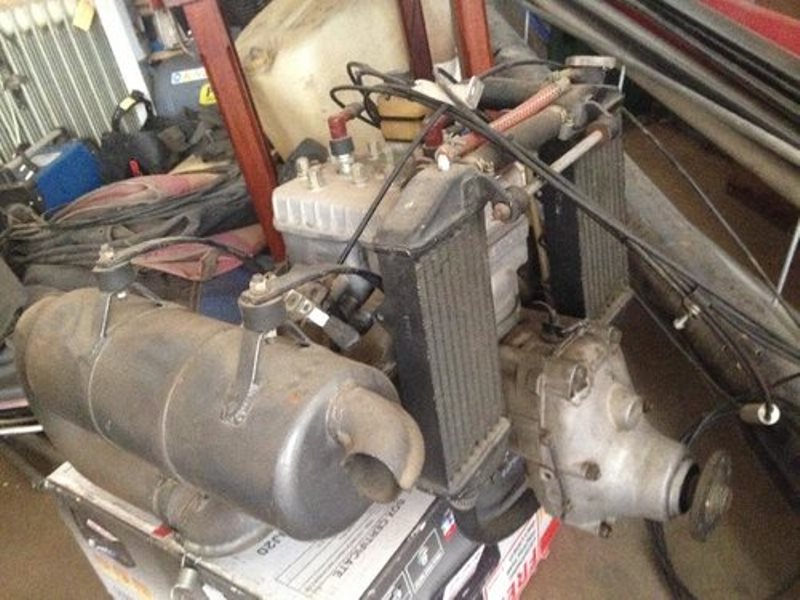

Postby Henni » Fri Mar 21, 2014 3:44 pm

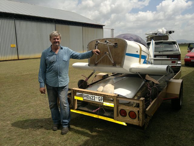

Fetching the engine. Now I need to fabricate a similar mount.
Henni
Posts: 807
Re: Rotax 532 powered KR2

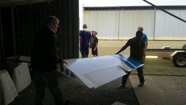

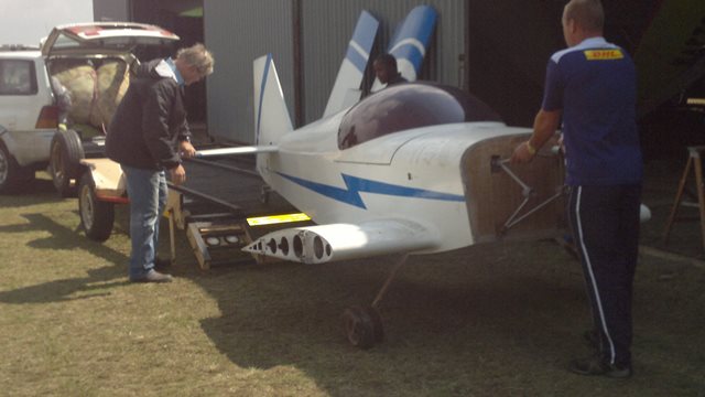

Postby Henni » Fri Mar 21, 2014 5:45 pm
Fetching the KR2.
