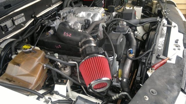

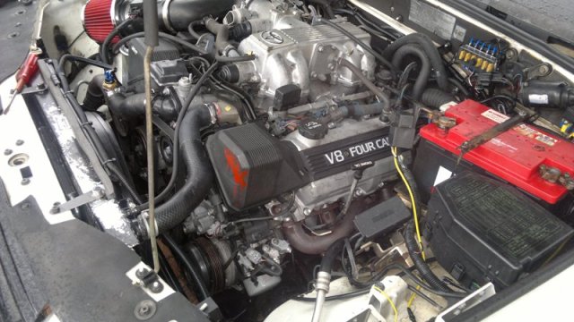

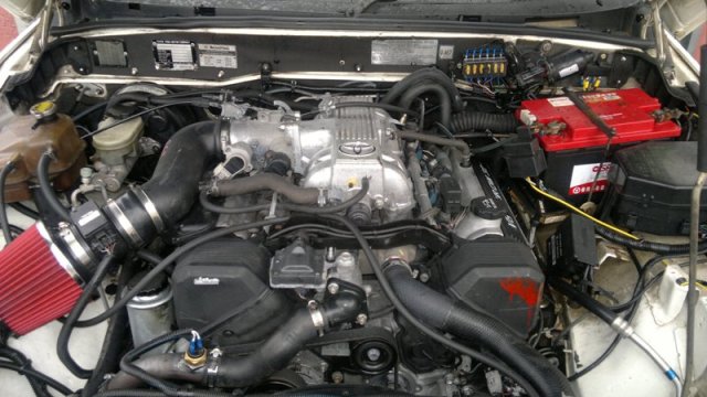

Hi all,
We recently had a Lexus V8 plus auto box fitted to our broken SsanYong Musso EL602. The company who did the conversion, quoted us R23 000 less than the normal price. Everyone warned me against it and said it could not be done at that price.
Well, we've got her back for a week already & every time I start her, I'm thrilled all over again. I should have done this long, long ago. It was worth every penny & she performs like a dream. If any interest shown, I'll post some pics & more detail of the installation.
I plan to look out for a broken SsanYong in a otherwise mint condition & then have the same done to it. Unfortunately ours is not in such a mint condition, but she is now at least sound mechanically.

It seems to be exactly the same. I got around 550km out of 60 litres with the diesel. I seem to be getting the same with the Lexus. Keep in mind that this is at much better speed. The diesel fell back to 80 kmh on many uphils, the Lexus does not even so much as flinch ... I've filled up twice now. Yes, my foot is still a little heavy on the V8 as it thrills me, so I might even do a little better on the fuel in the long term.
I am extremely happy with the installation. Done about 1000 kms now, no problems of any sorts. Stays cool, lots of power. They used the standard Lexus electronics. No fancy buttons for anything. The auto box kicks down smoothly when needed and gear transfer is very smooth indeed.
They quoted R35 000. In the end it cost me another R2200 as my exhaust system was shot & they had to replace completely. So all in all under R38k. Closest other quote was R58k, so a huge saving for me.
From beginning Jan this year to now they've already done 13 installations. When I collected, they were busy with another 4 conversions in one go. Yes, their premises looks like a scrap yard, but their workmanship is excellent. I will refer anyone to them anytime.

WOW, nice conversion Henni! I agree, the V8 can be thrilling! After driving mostly inline 6's for many years I recently changed to a V8 and yes, I am a bit heavy with the foot but the sound and the acceleration puts such a smile on my face I do not care about fuel consumptionHenni wrote:Hi Jean,
All the best my friend,
Henni

Shes old and worn, but now at least shes willing. Today was her first long drive and that with a one tonne trailer behind. Went like a breeze. All in all I am very happy with the conversion.

I prefer diesels. ( operational requirements, and grew up with diesels
But I must agree, the change from a inline 6 to a V8 ( still diesel) seriously affect the way you pull away at a stop street or robot.
It just happens !!
The installation looks nice and clean - enjoy.
That SsanYong will def surprise a few youngsters at the robot!!!
