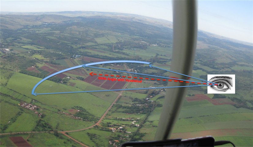

In the example below of a simulated engine-out (engine idling), I am approaching Sue Singleton's airstrip in Hekpoort. Consider that there was no tape on the compression strut, making Sue's airfield is somewhat hit and miss!

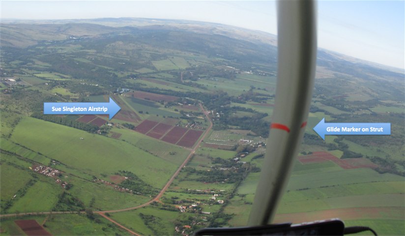

However, in the next example in which the photo was taken from my eye level, you can clearly see that by using my piece of red tape I can make the airstrip. There was a slight headwind component, so the dotted red line is estimated as the point of touch down, BELOW the glide-slope indicated by the tape on the compression strut.
Finally, practice engine-outs OFTEN and test this simple piece of equipment with headwind and tailwind components!!
Remember, rather be too high and bleed off altitude by slipping/turning, than land short!! :shock: THIS TAKES PRACTICE!!!
