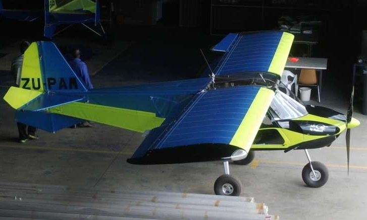

The cheetahs are all awesome, the little experience I have with them. So I got my own. what you think?
This is the new BushCat. Only Change the wheel size, Undercarriage and brakes.
