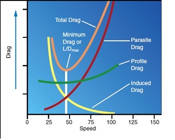

The lift formula is:
Lift L=CL ½R S V²
We can only influence CL – angle of attack and V² which is velocity of airflow.
You have adjusted your velocity down that means that if you want to achieve the same lift you can either change the angle of attack – back pressure on your stick or reapply power. In this case you will apply back pressure.
This will result in a high nose attitude at a reduced airflow.
Induced drag will now increase due to the slow airspeed.
You will see from the diagram that induced drag will shoot up at slower speed. The yellow line.

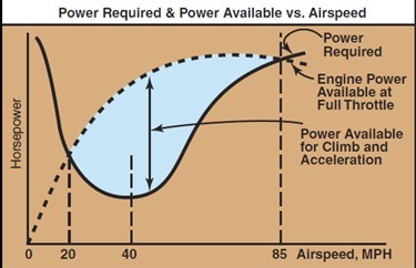

This bring us to the power curve
P curve.jpg (30.69 KiB) Viewed 4683 times
You will notice that your power required at low speed increase exponentially.
You will also notice that below 20 mph per the graph you would not have enough power available. This area of the graph is where you are flying behind the power curve.
Let say that your power available is equal to power require – where the two lines cross on the graph.
You can then hover at this point until the power required is increased due to sink or engine power is reduced due to turbo exceeding engage time.
Your only method of recovery now is to reduce the power lower the nose and apply power. Whereby airflow will increase and increasing lift and angle of attack reduce reducing induced drag.
Why reduce power for recovery if you are already behind the power curve ? The reason is that you can experience a Power Push over by reducing the attitude dramatically at WOT “wide open throttle.
