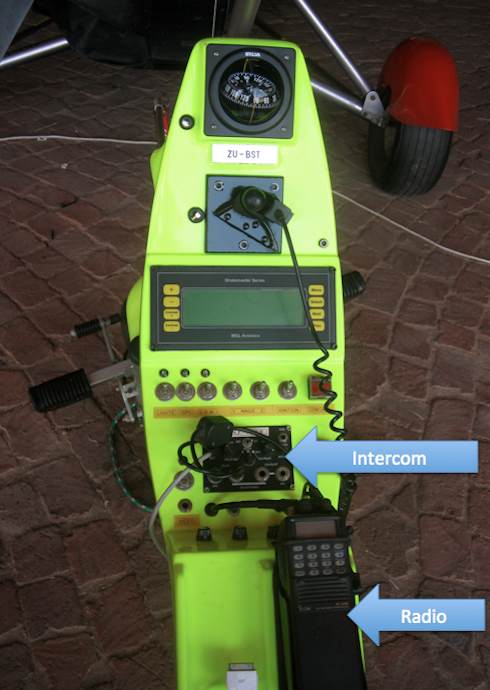

A picture of a typical trike radio & intercom might assist Phislet in grasping the setup . . . . courtesy of the Beautiful Seductive Temptress! :wink:

Alan has answered quite fine. The VXA series radios can scan multiple frequencies and have a priority watch, they probably have more features than a panel mount radio. The main issue with trikes comms are (were) with the antennas, however we seem to have got that nailed now...
Spend a week of your holidays with Laston and he will teach you the fundamentals.
