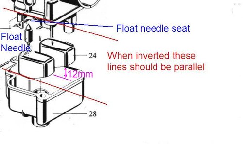

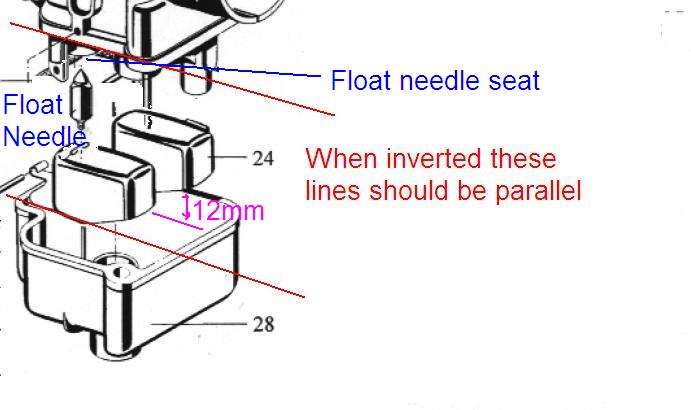

Re: Carb flooding
Postby Morph » Tue Mar 19, 2013 11:50 am
Your float needle valve is not closing properly.
With the engine off, run the electric pump and it will start overflowing through the overflow tubes. Stop the pump, open the float, and bend the little tag on the float lever up a small amount. Close up and switch the pump on again. It should stop when the fuel is about 12mm from the top of the bowl
If it does not the the needle, or seat or both are worn.

Hi Morph, thanks! It's a much more convenient way of setting the float levers. Will try it, the carbs do flood when I switch on the electric pump.
The needle (vitton tip valve) is new. I figured that the valve seat might be worn or damaged, but it doesn't seem to be a replacement part in the Bing 54 - at least I can't not find a part number for it. Is it serviceable?
