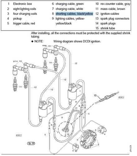

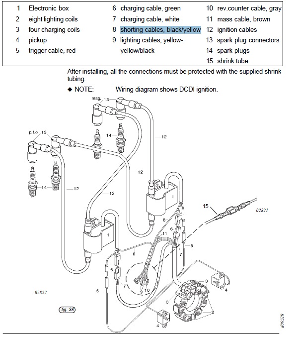

Postby Morph » Wed Feb 27, 2013 4:15 pm
Here is the wiring of the motor
Connector 8 is the one we are looking at
