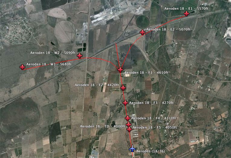

With this in mind I set out to test a GPS-approach landing. I started by establishing an EAST and WEST approach to Aeroden 18. A direct-in approach is not possible due to the open-cast platinum mine to the north of Aeroden.
The steps were:
Step 1: Establish the approach paths
Step 2: Establish waypoints along both east and west approach paths (waypoints on final approach was common to both), right down to touch down (TD)

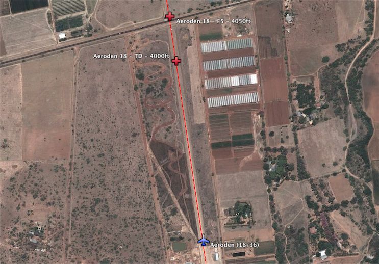

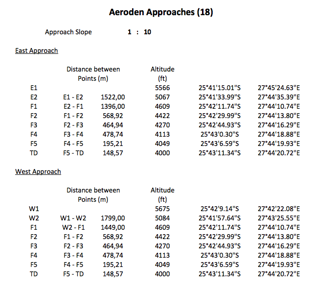

Step 3: By calculating the distance between the waypoints and using a 1:10 glide slope, work backwards from the touch-down (TD) point to determine the altitude of each waypoint

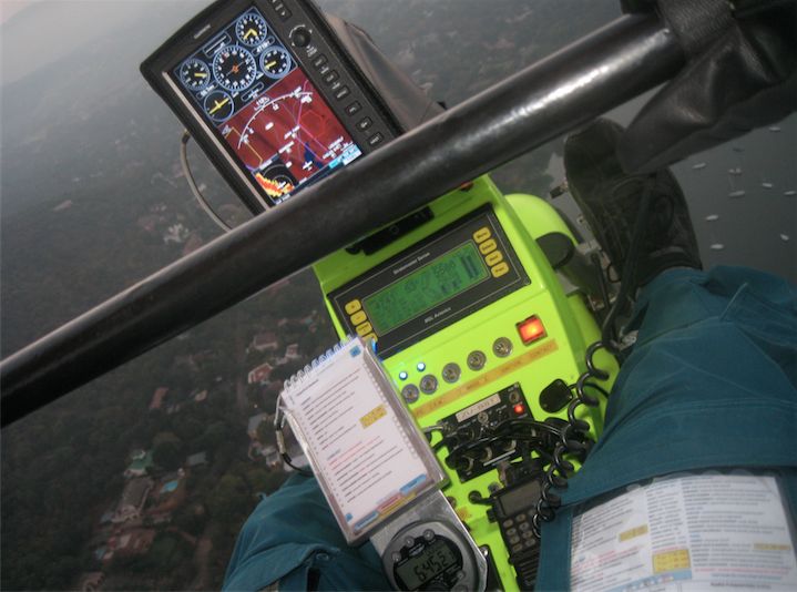

Step 4: Input the waypoints for each approach into the GPS, including the ALTITUDE in the waypoint name, for easy altitude reference when flying the approach.
