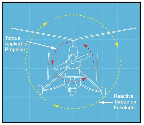

Postby Gyronaut » Tue Dec 20, 2011 6:27 am
While I agree with Gert that it probably has more to do with falling out of the cot as a baby, I suspect we can justify it with the same reason a Gyro 'prefers' turning one way than the other - also applies to Trikes.

Got the same “problem” At first I thought that it was because I trained mainly on a left hand circuit, but later found out that this was not the case.
Standing behind my trike the prop movement was to the right (clockwise) This resulted in a definite reaction to the left while flying. It was much easier to bank to port than starboard.
