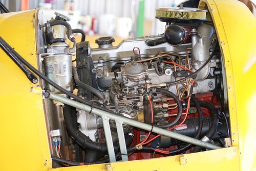

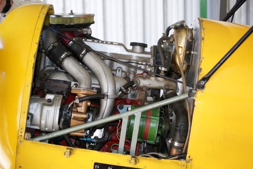

I meant of the engine and under the cowls.... (maybe even some specs) I know what a piet looks like...
- John Boucher
- Posts: 4330
Re: Pietenpol Aircamper
George, I posted a pic of the engine there as well but do so again for everyone's benefit...

Nice...
Thanks
Thanks

Koenie
If I may, then I'll oblige with the photos. I think the engine weight will rule it out for a trike George and before I talk nonsense again I'll leave that to Koenie
