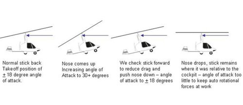

I am proposing some debate around High Speed Blade flap. This hidden phenomenon can bite any Gyro pilot on take-off when least expected if not well understood and happens in an instant causing a violent roll-over.
I have a theory/hypothesis I would like to share for debate.
The theory applies to all Gyro's but is more prone to happen to shortly-coupled side-by-side machines.
We all know that a rotor must have a positive angle of attack into the apparent wind in order for the auto rotational forces to work. Without a positive angle of attack the rotor will lose RPM and will not fly positively. Once in the air, it is only possible to achieve this state by 'unloading' the rotor. (Negative G's - absolutely forbidden of course)
The moment-arm of these new-generation gyro's is very close to the Center of Gravity resulting in the nose popping up far quicker than in the tandems during take-off. Perhaps the wider, flattish-bottomed, fuselage's/cockpits generate their own lift and contribute to the cause by adding to total lift up to a point that the rotor takes over all the lift - thereafter it (the fuselage) is pure drag. In a typical take-off roll, the stick is full back and the rotor is loaded as the drag increases with forward speed. The rotor speeds up to the point that the nose lifts and we check forward on the stick to hold the nose down and to avoid getting airborne behind the power curve. As the nose drops again, the stick position may remain the same relative to the cockpit resulting in the angle of attack becoming too small. This is the same as taking off with the stick forward which we all know WILL result in blade-flap, regardless of rotor RPM. The disc happily skips along as the airspeed increases rapidly because there is no drag. The rotor is unloaded at this point. We then decide to take-off because we have adequate speed and come back on the stick. The rotor goes from an unloaded condition to fully loaded in an instant, the rotor speeds up rapidly. As a result of the high airspeed the advancing blade is exposed to a lot more airsflow than the retreating blade during this transition. The advancing blade 'flies' happily while the retreating blade 'stalls' and BAM, roll over to the left (in an anti-clockwise rotation) is the result.
Disclaimer: I am particularly poor at trying to draw things on a computer so please forgive the amateurish effort above. I also hasten to add that the gyro represented in the picture is a generic creation of my own and is NOT intended to represent any specific make or model of gyro. It is for illustration purposes only. (Before some agents/manufacturers throw a hissy-fit again)
I have often heard pilots say that the wind must have thrown them over on takeoff. The wing tip speed (lift generating portion) of a typical rotor is in the region of 650km/h or 400mph at typical flight speed. A cross-wind of at least this speed will be required to throw it over. Anything less will push the gyro off course downwind but will not flip it over - or am I wrong here?
If my hypothesis proves to be reasonable, then it follows that the safest method of takeoff is to ensure that the rotor is loaded throughout the takeoff roll until the gyro is airborne, whether it is behind the power-curve or not. In other words, you must feel rotor drag throughout the takeoff roll. Once the wheels are off the ground, blade-flap cannot happen in steady flight. The best method then would be to push the nose forward, gain adequate airspeed and only then begin the climb out.
Avoid climbing out steeply at the gyro's best angle of climb, stick to best rate of climb. The reason for this is, again, more pronounced in shortly-coupled side-by-side gyro's as opposed to tandems. If the engine fails while in a nose-high attitude, the airspeed will decay very rapidly. Pushing the nose forward to regain flying speed (45mph+) may take too long to avoid making contact with terra firma before the gyro is 'flying' again and it may not be possible to round-out, flare and land normally. In other words you may be forced to 'mush' onto the ground hard, resulting in all sorts of gyroscopic effects taking over and spoiling your day.

Len, thank you for starting this post !
I would like to see training for take-off in a short-coupled gyro change. I have changed my method differently to what I was taught. We must stop with the shortest take-off as possible. A gyro is not a helicopter and will always need a runway. Yes, my method takes a longer runway but I am still shorter than a 747.
1 - Prerotating high RPM hides the feel of "nursing" the rotor. 180 RPM is absolutely sufficient.
2 - Very gradual power instead of full blast with turbo on from stand still position. The advantage comes next, that the dreadful moment of seeing the nose wheel "jump up" becomes a non event, and then the subsequent mistake of trying to preempt it and forcing the nose wheel to the ground disappear. The wheel will come up slowly like in a tandem gyro, and no need to porpoise the angle of attack in search of the correct attitude.
3 - Once the attitude is correct and balanced, full power and the rest happens by itself as you have explained in your first post.
Yes, I will use more runway, but few meters extra will not hurt. It will still be considered a short take-off compared to most other flying machines.

I couldn't agree more VT! Points 1, 2 & 3 are spot on.
Pre-rotating higher may save you a metre per 20 RPM, so what, big deal. Airspeed does the same PLUS saves your pre-rotator system a lot of unnecessary wear while having the added advantage of 'loading' the rotor evenly, allowing it to find its own happy place gradually. By now we all know that the rapidly changing angle of attack to the blade can cause a stall at any speed. Speed of the rotor is irrelevant (beyond a point), angle of attack is everything. A violently flapping blade will find a place where it stalls in the revolution. (As I see it anyway).
Keeping the rotor loaded (balancing the machine on the back wheels as long as possible) also results in a nice level lift off rather than experiencing the right wheel drop of the prop-torque transferring to the fuselage in an instant, which needs correcting. This happens in all Gyro's but is more pronounced in the side-by-side machines.
