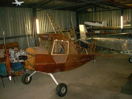

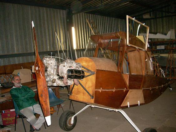

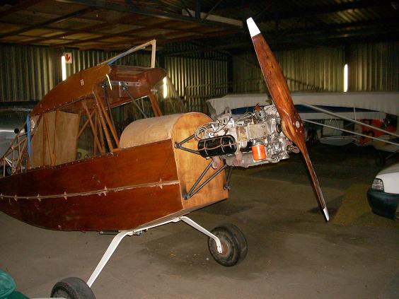

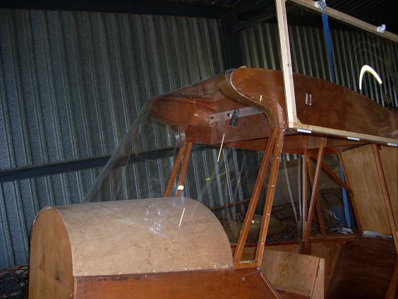

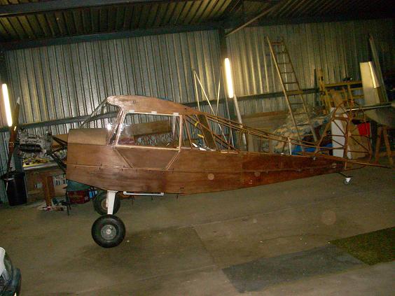

Last night I got so stuck into this plane and the session didnt end at the regular time of between 1 - 2 am I went right through till 6am and the work flowed like a river. I was braaing at 2am LOL. Got the controls finished with some new parts made and joysticks also made. Fitted locking latches to the inside of the doors, Fitted final hinges to the doors, Bolted on some new Ali parts which wont get in the way of covering with final AN bolts, Built the passenger seat, The BAD news is that I also managed to crack the windscreen Was the moering with myself which is prob why I decided to work later as punishment LOL.
For some reason not all the pics got saved but here is what got

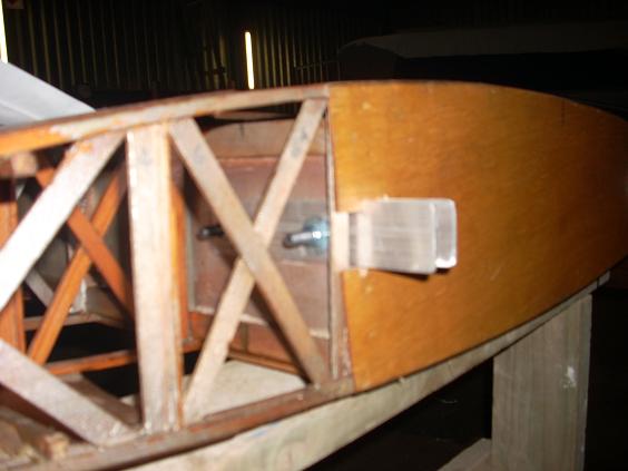

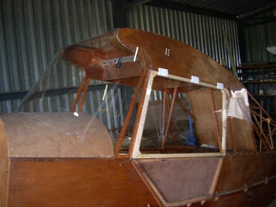

spend a good few hours working Friday evening then slept over in the hangar and continued working on Saterday got plenty of small things done. To be able to dis-prove abandonment I have to spend atleast 4 hours/month with the family and will have to take care of that today so sadly no work will be done .

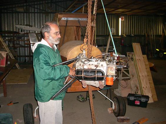

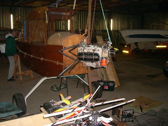

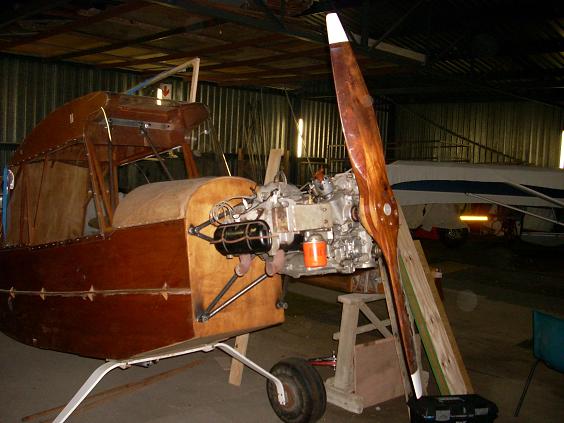

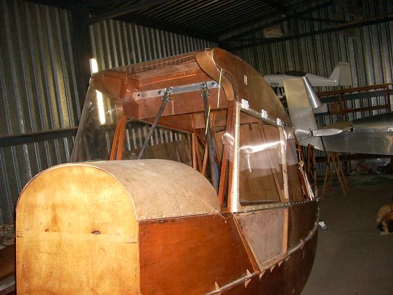

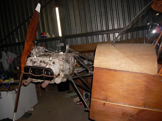

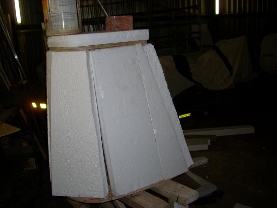

Funny thing is that I w writting this post at 4am after downloading the pics off the camera and I totaly fell asleep infront of the pc

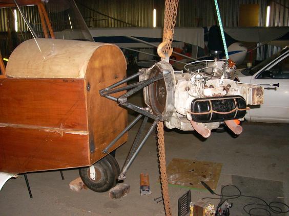

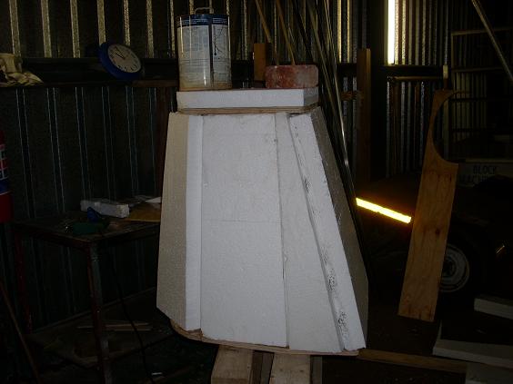

I got in a goodsession yesterday from 7pm to 3 am with very little downtime. The task was to map out and manufacture the mild steel engine mount. We achieved this and at 2 am the engine was hanging on its own mount. This mount will be removed in a few days and a copy will be made from crome molly. I also decided on changing the elevator system from the single ali tbe pushrod to a dual bowden cable like the Jabi ( although I think the Jabi only has 1 ) this will be easier to install and offer 0 slop or play if installed correctly. Then I also decided on the way forward with the rudder/brake pedal and instead of using a heel or toe brake I will have a split ( 25mm ) brake pedal next to the rudder pedal on the inside.
Some pics
Some pics

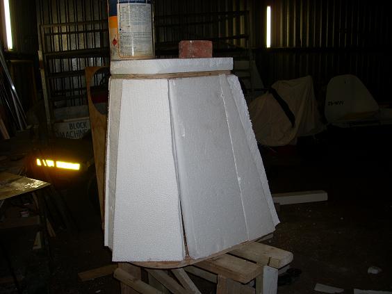

Fnished up a bit early tonight worked until 11, felt a bit moeg today. Got the cowl plug started tonight
