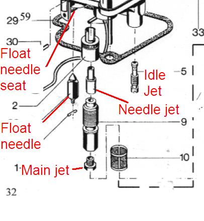

One thing that does puzzle me is why the idling is down as well. Could be fuel restriction feeding the carbs or a crack in the vaccum pipe that operates the fuel pump. This is the pipe that connects from the engine to the centre bottom of the fuel pump. Do you have a backup electric fuel pump? If you do switch it on and see if the engine comes to life.
Did you take the carbs apart when you cleaned them?
If not, take the airfilters off and look into the carbs. Get someone to move from minimum throttle to max and watch the slide movement. Is it going from the bottom all the way to the top, or does it stop half way? If so then this is your problem
Otherwise you are going to have to look at all the jets, fortunately they are all accessable from the float bowl side.
See pic. Remove the float bowl
Remove the main jet and the needle jet, it would probably be one of these. Check and clean. If this still does not work then you are going to have to strip the carbs completely and clean them out.

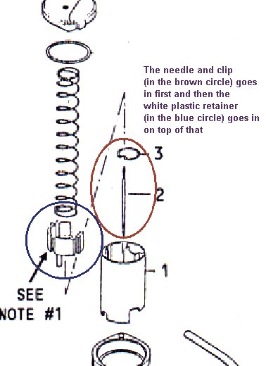

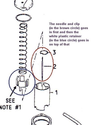

Alpha wrote:Ok Yes I did take the carbs apart and when reassembling all the elements together I made sure I put the plastic slides and needles and clips the correct way round. You can only put them in one way without forcing anything.
True, but you can put the white plastic retaining cup in wrong by fitting it below the needle. Go have a look again. You should have the plastic retaining cup ON TOP of the needle and clip.
Will post a picture soon

Postby Duck Rogers » Sat Feb 19, 2011 10:27 pm
Like so........
