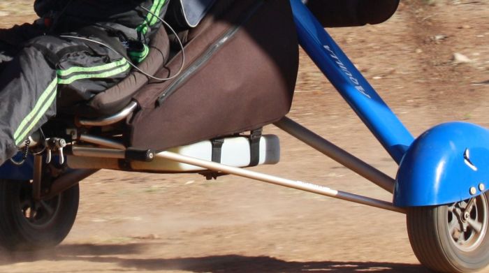

Martin, after our discussions, have given this some thought, now we can make the tank any thickness, we have the caps tooling and fittings etc. When we originally discussed the EOD/IEDD cooling suit bottle that you saw, we investigated the potential of using a co2 charged aerosol can. It works well is self priming and is very efficient. Plus the ice does not upset the submersible pump. Problem is sourcing cans after we supply the kit. So this fell away (also the risk of secondary shrapnel). Anyway, it would not be difficult to obtain a charged can (similar to air horns) and instead of expensive pumps, cables and other complicated delivery devices. Why not pressurise the auxiliary tank and use that as a very economical simple light system for fuel delivery. Basically mount a air fitting to the tank and then a option exists to fit the aerosol delivery valve and canister. Obviously as a propellant use something such as Nitrogen, CO2 or similar ? This makes a universal product and would be very cheap to produce. Probably one canister per tank. The delivery rate will be much higher than a pump as well. Mount the canister next to the pilots seat for ease of use.
Any ideas welcome.

Chaps, if we are to consider making this "kokok" then I will need at least 25 confirmed orders for a roto- moulding tool. I have the caps and seals etc.
I would insert the pump, probably a Huco in the integrity of the unit and have a cover plate with connection devices that would allow it to perform as a huge fuel container. It will need to fit Gyros and GT450s which have smaller seats than Aquillas. Probably Cheetahs as well. So a wood mock up will be made first.
If we get around to production then I will call it without question a truly South African name "kokok". It would be 60 litres and usable 50 litres.
PM orders so we can see if its viable...
Zulu1
Zulu1
