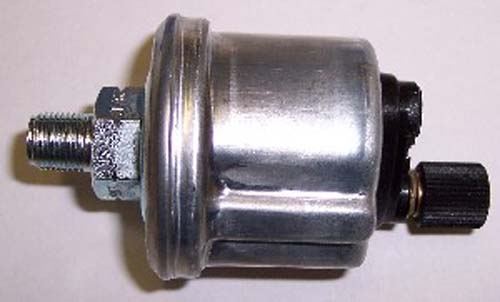

VDO have various sensors. The 912 has a max bar of 7. Use the sensor with the 0-10bar range, readily available at any MidasRudix wrote:It turned out to be the sensor that failed, a quick replacement and all was well. The one on my 912 was a VDO sensor that I replaced with a VDO unit from Midas, works fine!
360-004 VDO Oil Pressure Sender 150psi / 10 bar
- VDO Oil Pressure 360-004large.jpg (20.13 KiB) Viewed 24029 times

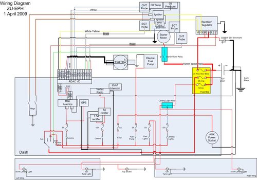

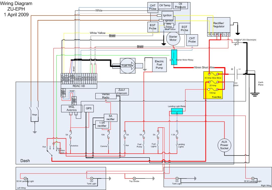

Re: Rotax 912 Oil Pressure Sensor Problem
No problem then,
You will find the Honeywell, if it has 2 wires is probably wired one wire to the MGL and the other to earth
just use the MGL link, the engine earth will be the other wire. The MGL uses an RDAC for all the wiring. This only has one input for the oild pressure sensor
check my Aircraft wiring diagram below. The black (labeled white) wire goes the the top right of the engine and the oil pressure

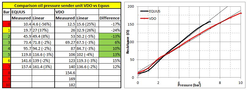

Cheaper elsewhere for me, please. My VDO oil sender unit also broke, giving wildly erratic readings. Luckily I had previous experience with loose instrumentation cabling and decided to limp to the airport instead of making a precautionary landing. My life, so extended, was made miserable by VDO prices, so instead of forking out a thousand bucks for a new sender unit I bought an EQUUS sender unit for 80 bucks and spent the R920 so saved on fuel. The EQUUS also has a 1/8-27 NPT thread, but only a 0-7 bar pressure range, versus the VDOs 0-10bar. Since 7 bar is the maximum allowable oil pressure on a 912 UL, this is acceptable, for me at least.
Unbelievably EQUUS is not able to provide calibration data for their oil sender unit model 9832, so I checked the resistance versus pressure by connecting the sender to a compressor and recording the resistance readings at various pressures. The results are below. Please bear in mind that the calibration was done with backyard (not calibrated laboratory) equipment. It is evident that, if the EQUUS is used as a straight drop-in replacement, your deviation in the relevant range 2-5bar range will be a maximum of 13%, which is really good enough for me. My MGL Odyssey allows me to define any linear pressure-resistance characteristic, so the error of the EQUUS drops to below 8%. Even better.
