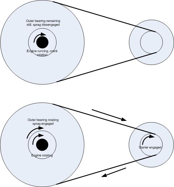

It's important to use a sprag bearing (one way bearing) on the crank side. This will allow the crank to run freely when the engine is running without turning the starter motor. When the engine is off and the starter motor engaged, the bearing sprag will engage and the motor will be cranked. These are readily available from bearing man. Call any of the timing belt suppliers and they will be able to put you in touch with a company that makes the sprockets.
see pic
Top pic is when the engine is running and the crank is freely rotating in a clock wise position. Here the rest of the system stands still
The second image is the engine being started. Starter rotates the small sprocket, which via the belt rotates the large sprocket. The sprag clutch engages and the crank of the engine is rotated. as soon as it starts, the crank will run faster that the starter motor and the sprag will dissengage.
I used a starter motor from a Nissan 1400 bakkie, bought it from a scrap yard for R300
see pic

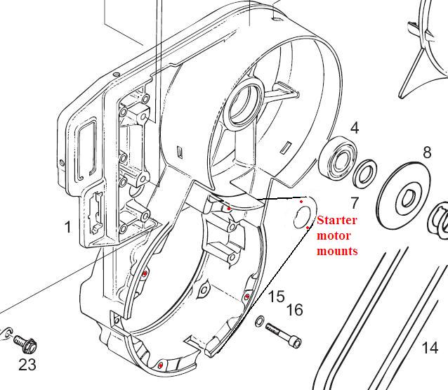

You are going to have to make up a plate that mounts on the same 4 holes that the pull starter uses (See the red spots on the image. The starter must be on the exhaust side of the engine, you don't want sparking electrics on the intake side near the fuel
. This can be made out of a fairly hefty alluminium
