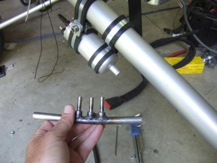

Fuel manifold- a three into two arrangment

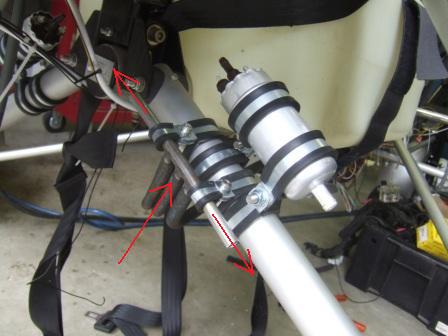

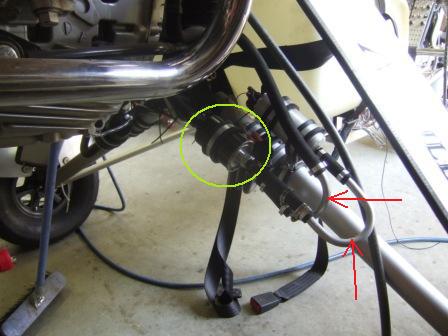

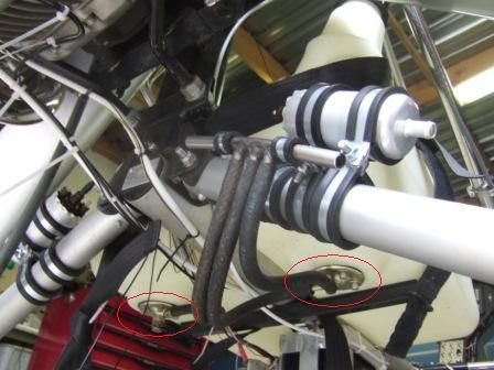

Here are some more pics of the fuel system; there are two pumps that feed from either side of the fuel manifold. The manifold allows the integration of the three tank outlets, about 6mm in diameter, to the pump inlets, of a larger diameter.
The pipes to the fuel pumps had to be integrated with aluminium pipe to allow for smaller bend radii (see photo Fuel5).

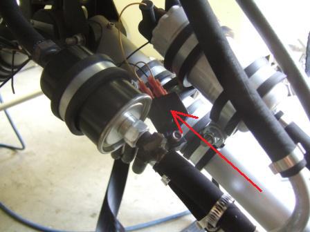

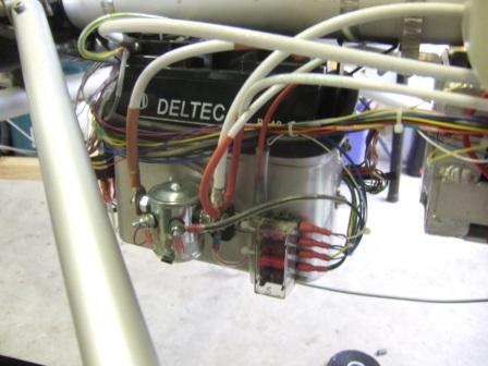

Fuel8 shows the relay that controls the starting of the main fuel pump- controlled by the E-Boxi; the standby/ backup pump comes on immediately when you switch over to the backup ECU.
Pump and manifold mount
tank outlets circled
Filter, circled, pipe bends, arrowed
Fuel pump and relay

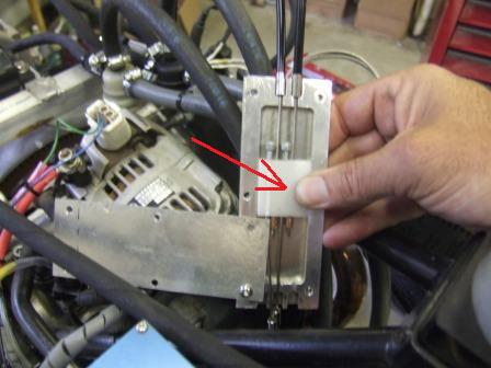

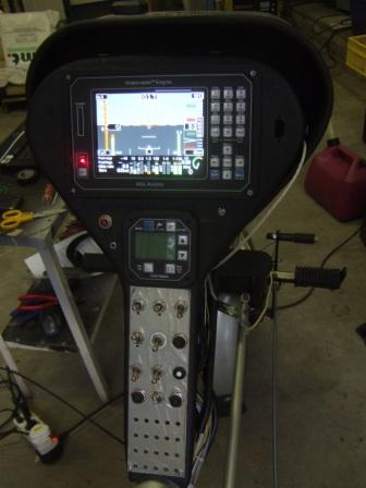

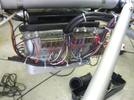

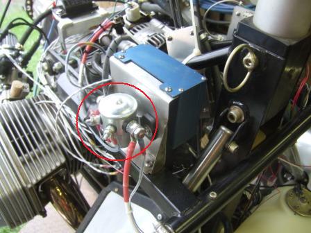

Here is the wiring system and some more of the components. The first is the E-Boxi mounting point; the circled item is the alternator contactor. Each battery and the alternator may be isolated from the system by using these contactors.

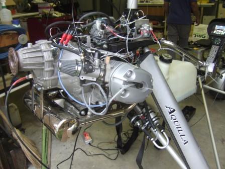

Here is a general shot of the engine

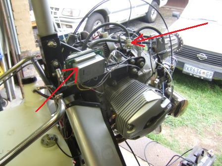

Another general shot showing the RDAC and IO Extender mounting on the left and the fuel pressure regulator on the right.

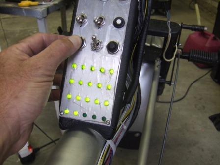

This is the FAP- the Fuse Annunciator Panel; it gives you the status of all the fuses by pressing a button; a dead LED indicates a blown fuse and the panel will eventually be engraved with the location of the fuse.

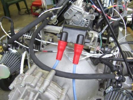

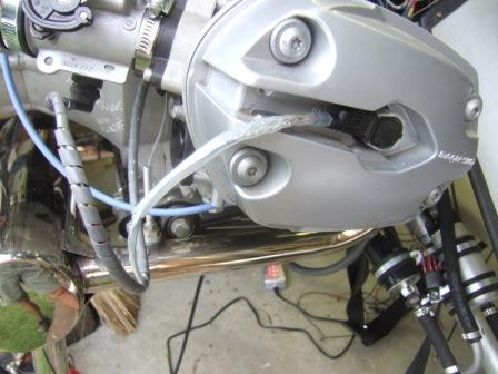

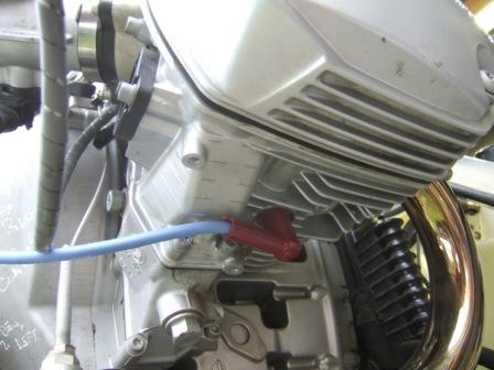

Here is the backup HT coil mounting; this supplies the second plugs with power- the first ones use a coil on plug arrangement, as seen in the second photo
This is the panel- a bit funny looking as it is not screwed in yet

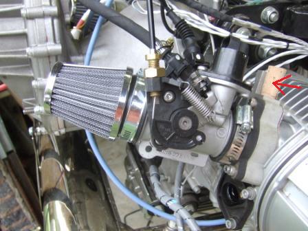

Here is one of the throttle bodies; the cork seen on the right is to close the second injector hole as we are waiting for parts. The engine ran just fine like this although it tends to spit the cork out as you switch off sometimes!

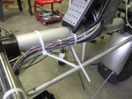

Pictures of the wiring and batteries

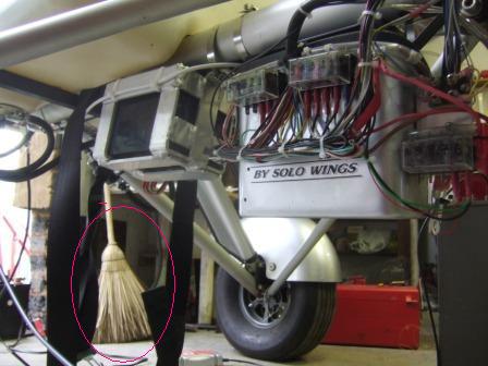

From the attached photo it seem as if someone's mother in law paid you a visit at the hangar!

We should be able to fly it in a couple of weeks now; just moving the oil cooler to a position that provides it with more airflow. I'll post pictures, sans broom :wink: later.

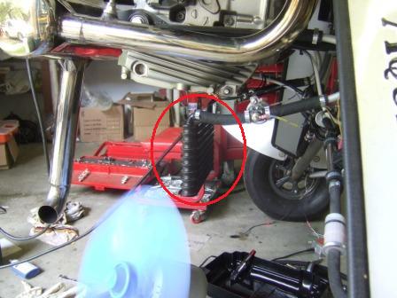

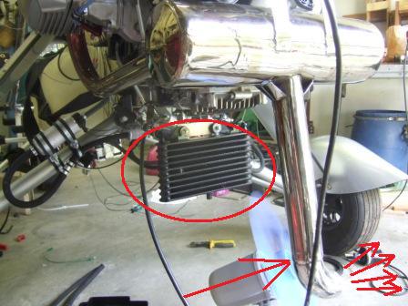

Some more photos as promised...

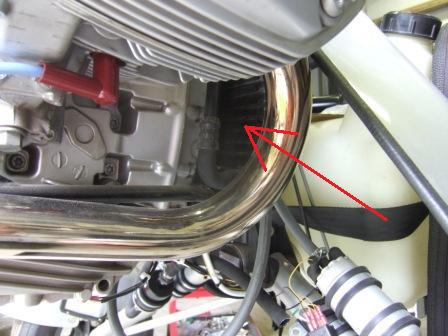

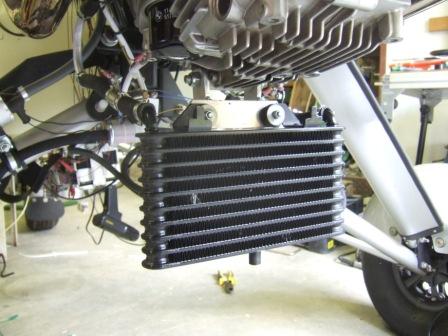

The oil cooler has been situated in the stock (BMW) position, which is completely wrong for this application.
I have moved it below the engine to a position where it will enjoy more airflow, which has entailed some plumbing modification of course.
The arrow is showing a fan that I used to blow away the exhaust fumes generated (small arrows) when I was running the engine- it gets a bit uncomfortable in the workshop otherwise!

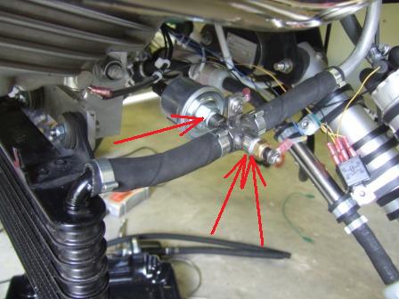

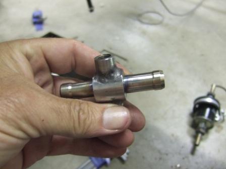

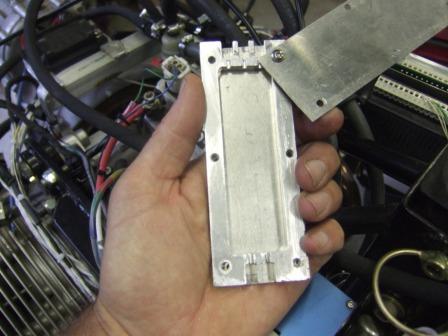

We used these new plumbing arrangments to add some sensors, for which I made some custom housings
These have been used for oil pressure (single arrow) and oil temp (double arrow)
We have put oil temperature measurements on both sides of the cooler so that we can monitor how the cooler is working. I recall a story on a replica Spitfire that was built using a Jaguar engine where they had huge cooling problems with the engine- they eventually figured out that most of the radiator had been virtually blanked off so that there was no cooling from the radiator at all. These sensors should help us to figure that problem out should we have cooling issues.

What is the reason for the three into two arrangement on the fuel manifold??

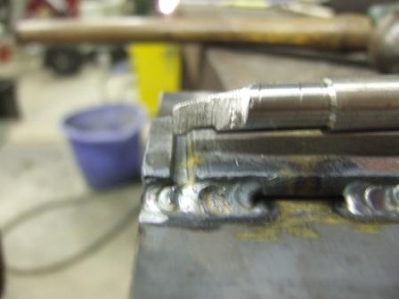

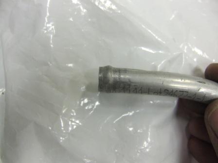

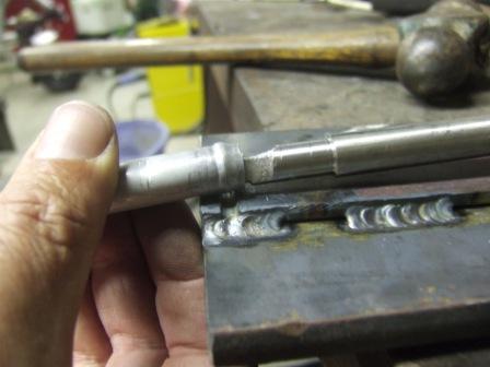

Whilst adding the new plumbing I was concerned that simply clamping onto a straight pipe might now be enough to hold the pressure in the oil system, so I made a beading machine/ jig/ fixture to put a small bead onto some 1/2inch aluminium piping.
Here is the final bead
