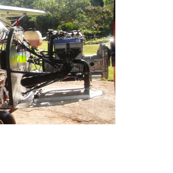

next, post pics of the exhaust/engine installation. have a look at this pic, is it mounted the same?
there should be minimal flexing between the engine and the exhaust. Copper Slip is used on the ball joint.

Hi Morph
I have attached a pic below. I can't remember what oil it is offhand (I'm at work) but I bought it from Aviation Engines in Jhb.
The premix as per the Rotax manual for the first tank is at 100 : 1, ie: half (not twice) as much as normal plus whatever the autolube puts out. I'm thinking that I over primed the engine using the primer pump and that probably contributed to the fuel only partially burning and being pumped into the exhaust. Being the first time it had started I was loath to give it a burn above 3000 rpm either.
Have a look at the left side installation. What is your feeling on the fuel pump and hoses sitting above the exhaust outlet and should I fit some sort of protective plate in between? This set up was copied from other BB installations.

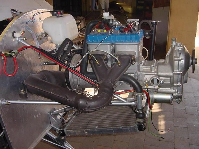

Jip. Here I am!! Sorry, I went walkabout for a while.... Your installation seems ok. You can pull the front part of the baffle plate up though. Just make very sure that all the air coming in the front MUST exit thru the radiator. IE: must cool something down. I will give some of my pics to help clarify. Not the the "venturi-like" lip on the bottom of the cowl. That is very important, as this creates a low pressure area below the engine, helping to get rid of the hot air. Enjoy the pics, and fly safe!!

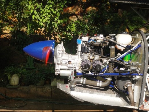

Also note that I pulled the silencer up higher, and thus further away from the radiator, lessening the effect of radiated heat towards the water radiator. You must remove the WHOLE rope-starter system. You will not have any use for it in this installation. Ever. Save weight too.

Thanks Boet - nice pictures.
I am happy that my cowling seals properly and air will be forced out through the radiator.
Please give us your thoughts on whether I need to put some sort of insulation between the fuel pump assembly and the exhaust to protect it from heat and also in the event of a fuel leak. Secondly, what do you think about the "blow back" of oil / fuel from the join of the elbow to the exhaust manifold (see first post above).

I would be nervous about that. Additionally once you switch off, the radiated heat from the exhaust will cause the petrol in the pipes to boil and this could cause vapour locks.
I would definately route the fuel away from the exhaust, or add protection to the pipes

I also have only used proper fuel hose but the piping for the primer pump doesn't look like it will last too long in a high heat environment. The carbs are not near the exhaust but the fuel pump sits above it. I am going to have to do something about that. Thanks for the input.
Re: Rotax 582 Exhaust Issues and oil burn
I have done a large number of these installations on the 582, and it is a trouble-free system. Never had any petrol related problems, but have completely stopped using that blue pipes. You get it in 2 grades. VERY good, and lasts a long time. Shit grade that starts cracking and breaking off after a while. As the two products are identical, and COST THE SAME PRICE, you never know what you are getting. I have changed to proper black rubber petrol hose. One gets spoiled however, beiing able to SEE the petrol flowing, so all the pipes from the tank, and in the cockpit area is 8mm od semi translucent nylon tubing. When you heat up the end of the nylon tube with a lighter*, it pushes a nice "hose barb" ring. I use short lengths of rubber tube to join the nylon at the petrol taps etc.
