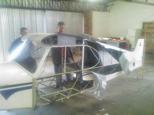

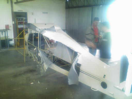

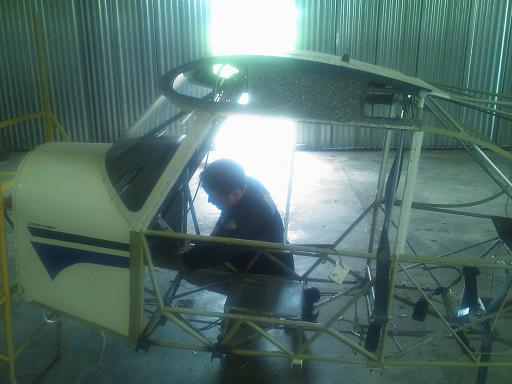

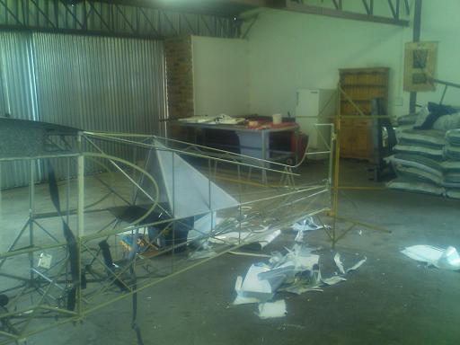

We are now busy rebuilding the plane. We decided to take the opportunity to convert her into a taildragger like the J43 CUB. We are lucky to have the support of Kobus Van Staaden (The founder of Cubby) and his son Manus who is assisting us with the rebuild in Secunda.
Here are some pics of the stripping down... Bad Cellphone pics...
Bring out the Blade!!!
Will this thing ever fly again????

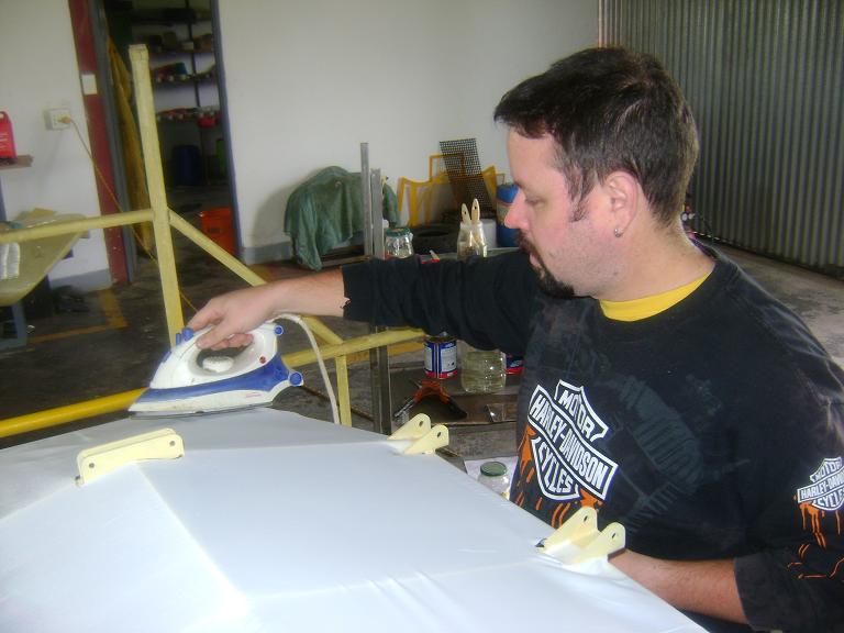

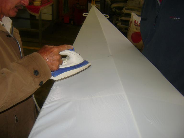

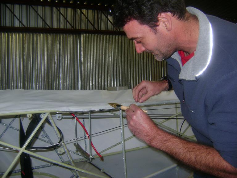

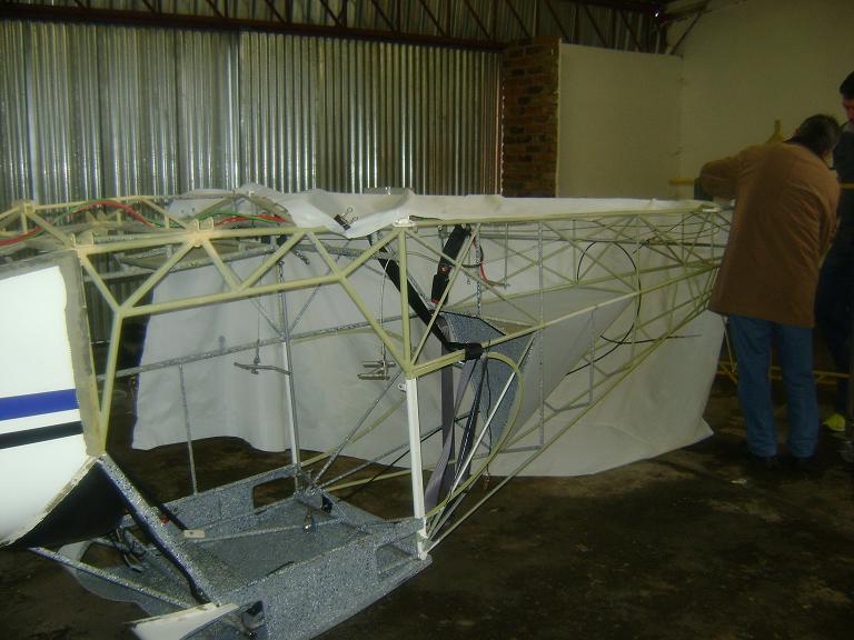

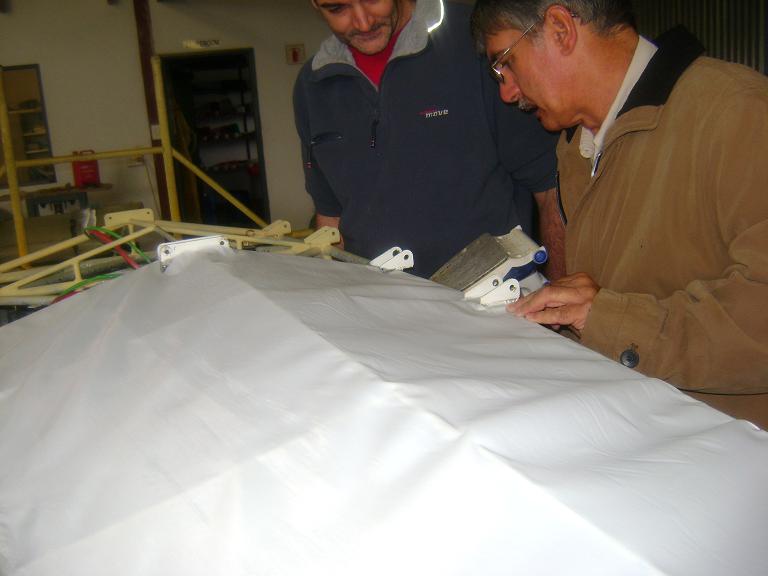

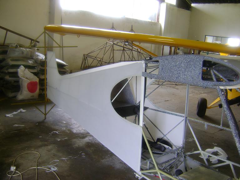

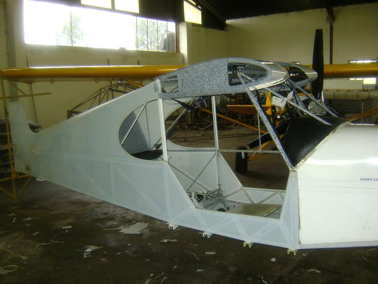

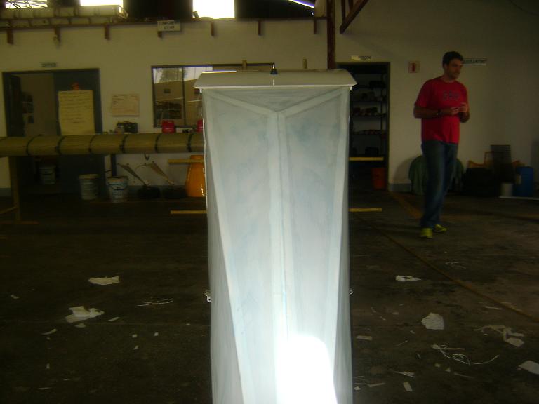

After stripping the Cubby last weekend, Kobus and Manus finished off the welding/priming of the mainwheel brackets (moved forward for the tailwheel conversion). Hans and I then headed up this weekend to get to work on recovering the fuselage, under Kobus' supervision. The material is absolutely amazing! We where sceptical at first as to how loose it was when glued into place, but the initial 250degree iron tightens it right up. The process was: Glue fabric in place, iron glued setion at 250deg, iron rest of fabric at 250deg, reinforce sections with patches and Ceconyte pinking tape, iron again at 350deg and then begin Nitrate sealer.
Complete with 2 coats nitrate.
Covered, patched, 2 coats nitrate.
Hans applying nitrate sealer.
Finished covering, now to patch/reinforce
Me doing the initial ironing at 250deg.
Showing the fabric before and after ironing
Gluing the fabric (note how loose it lies)
Gluing the fabric, Hans was pretty quick by the end of it.
Laying and cutting fabric

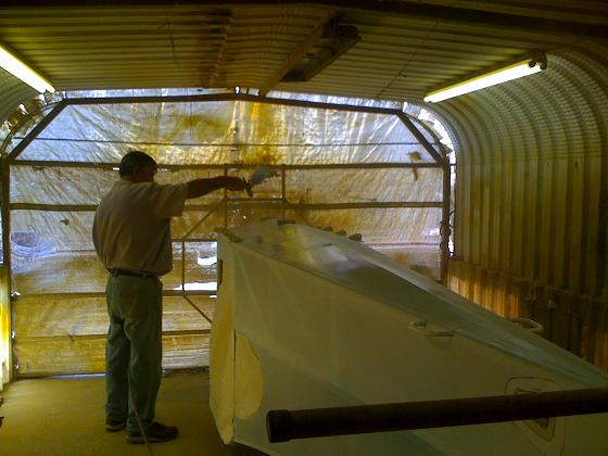

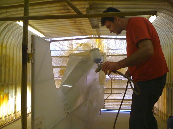

Postby GlennW » Mon Nov 30, 2009 10:39 am
Some pics from saturday...

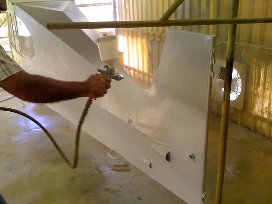

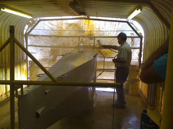

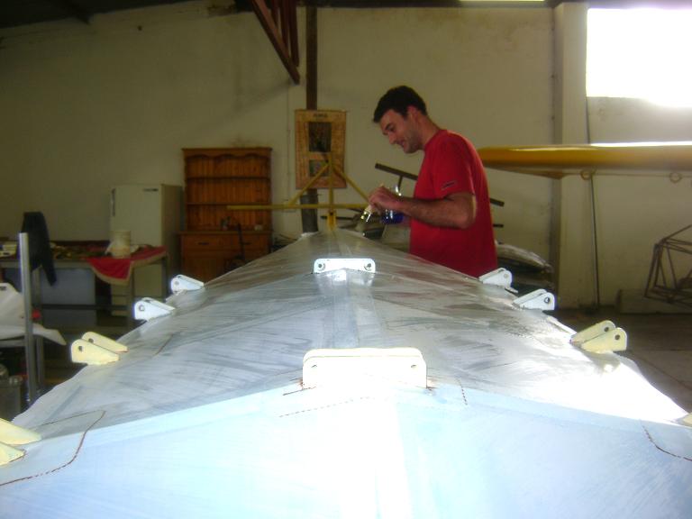

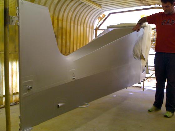

'Steady Hand' Hans got to know the ways of the spraygun and added a few coats of Nitrate, then a few coats of Buytrate, then a few coats of Buytrate with the Ali-paste mixed in, while I stripped and started re-covering the vertical and horizontal stabilizers, elevators, trim tab and rudder.

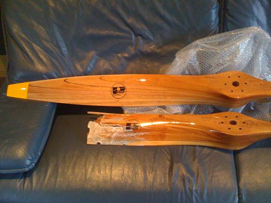

Our brand spanking new P-Prop :-)

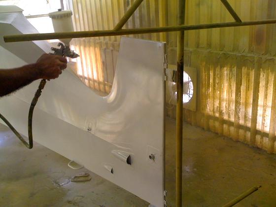

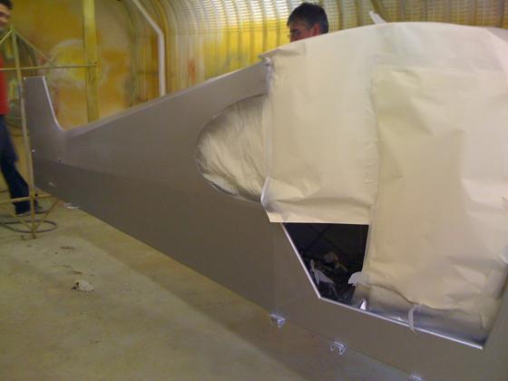

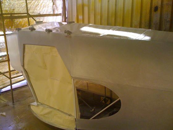

Work from saturday - Paint vhpy (^^)

pprop
Posts: 25
Joined: Tue May 24, 2005 8:26 am
Location: 387 Long ave, Ferndale, Randburg
Re: Cubby ZU-DXU Rebuild Project
Postby pprop » Sun Jan 24, 2010 2:59 pm
Aaaag asseblief toggie kyk mooi na die propeller en onthou om die "tracking" van die propeller so na aan 3mm te kry as moontlik. :) :) :) Hoe nader jy die tracking kan kry aan 0mm hoe gladder is die propeller want dan skep altwee lemme ewe veel kubieke meters lug per sekonde. Die reel geld vir enige propeller wat nog ooit gemaak is of nog gemaak moet word - 2 lem, 3 lem, of soveel lemme as wat jy lus is voor. As jy die boek lees wat saam met die propeller gekom het dan sal dit wragtag goed gaan met die prop. Enige probleme en ek sit maar hier om te help so ver ek kan.
Beste hoor en moenie lat die ding jou per ongeluk a vriendelike klappie gee nie hoor!
