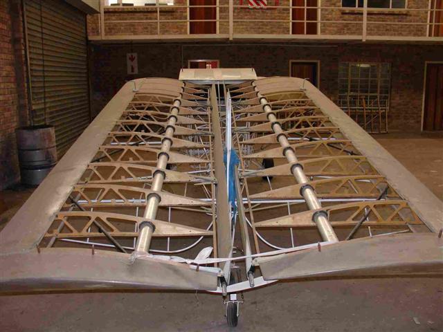

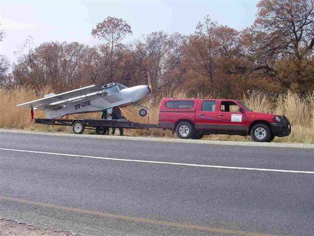

I have seen plenty of the open (flat bed type trailers, but does anyone in SA have something like this?
This is what lives inside...
Looks like I will never get that hangar at the Coves (Price is double again... :x :x :x :x ), so was thinking along the lines of a mobile toy box for the animal......
I know boet is anti trailering, but this would be more to store it in (protect from wind, rain and expecially hail) and maybe once the kids out the house to drag behind the winnebago :lol: :lol: :lol: :lol: :lol:

Now in the tricycle version, the swinging of the wings back makes the weight move backwards and the front wheel lifts off the ground. (this makes a nosewheel version difficult to move around and tie down. The tailie version doesn't have this problem.
The trailer doesn't have to have double axles because even though it is large, an aerie only ways 350kg max. Same weight as your average Harley or Honda Goldwing. It's just needs to be about 6 meters long.
I know of guys who have taken existing trailers, that are already registered and then altered them. No worries about the Natis system then.
I would put a hand/power operated winch at the front and pull the aerie in tail first.

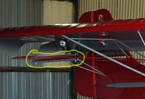

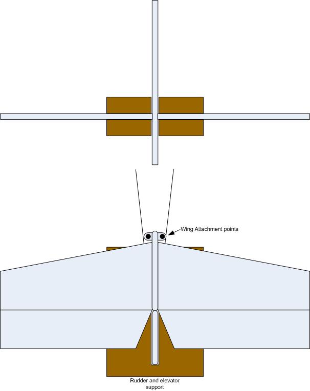

with the wings swung back the rudder can't move much, and the elevator only down. I would make up some supports that you push on from the back that fits above and below the tail wings and elevators that is nicely padded and supports the wings.
Secondly your wing is now suspended on a single bolt. There are two attachment points on the fuse next to the rudder. I would fashion some sort of support between that and the main wings so that the wings don't move up and down in transit and cause chafing.
