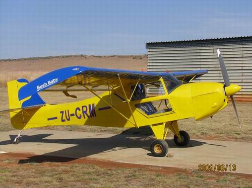

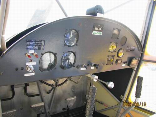

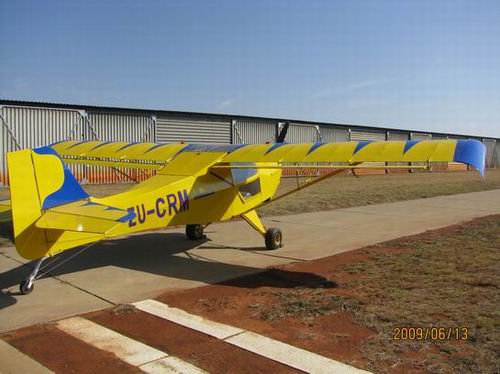

Bush Baby Serial 33 is finally complete and ready to fly after 15 years. (^^)
This Bush Baby has quite a history as it passed through a few owners over the years. :? After the original builder passed away it shifted from one owner to another and some tried to complete it but without success :? . When I took ownership it was not in an airworthy condition, although it had a current ATF, :shock: so I decided to recover and rebuild it.
I’ve just completed the weight/balance and have to repair a leaking fuel tank and then she will be ready for final inspection. ##

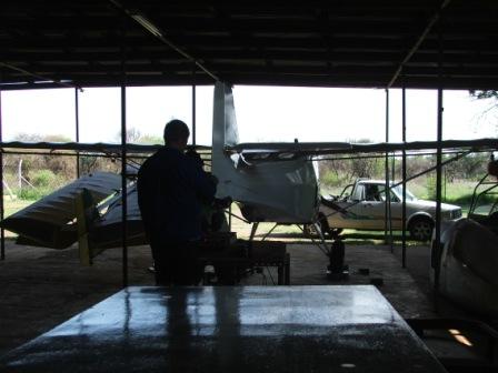

From the photo’s I can now see where all the wasp nests came from, I spent many hours digging out mud from just about every hole in the airframe ## ##

The wasp nests was there when we fecthed it from Petit. It was standing alone in a hanger with the master on fore many years(Hobbs) :(
