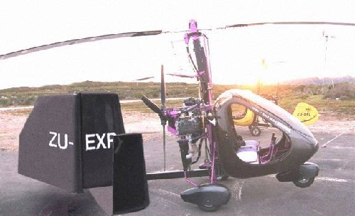

I eventually buckled under the pressure of not having an h stab on my RAF and so conscripted a third party to build me a nice big h stab to give me complete stability in pitch - see photo attached...
My new H stab
Unfortunately, it is just a bit too bulky and I just can't take off, try as I may, with all the additional weight. That's the last time I, for one, try to put a H Stab on my RAF gyro! :wink:

Hi Mikemat
I have often wondered about the horizantal stab on RAFs but now i can see just how they work and increase safety. If you cannot take off then your chances of having an accident are limited to taxiing at high speed from the airfield to your home after a good few drinks at the clubhouse. I wonder why it took so long to think of them. vhpy

Good one Mike. I'll try mine a little smaller and fit it on straight!! vhpy
