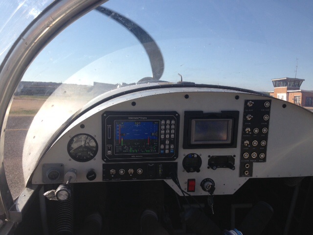

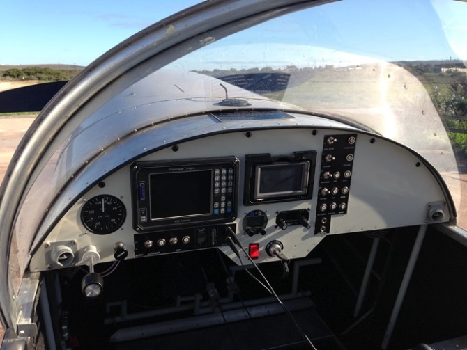

Hi there,
Today has been another productive day. Sorted some small issues, installed all missing locking wires, secure the panel, installed vents, installed fuel valve and piping and closed up cowling.
With the cowl installed, the temperatures are also looking good. I also broke in the new hydraulic brakes and they work really well. The aircraft manages tight turns with it, and this is exactly what this taildragger wants...!!
What is left to do is installing the AOA and pitot tubing and complete upholstery. Leon has been very kind in organising high density foam seats cutout and used his Zodiac's seats as templates. thanks leon!!
J

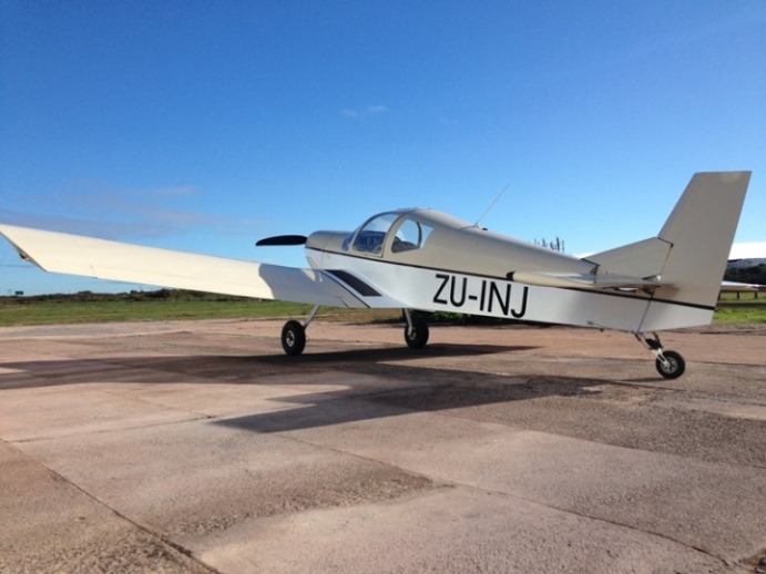

What can I say, i am ecstatic!! The aircraft is ready to fly, just need to wait for the PFA application to be finalised and then we will take it to the air!!
I did some taxi test for the past three days. The rudder is responsive and the Grove main gear feels nicely dampened. Dont feel any of the normal vibration that the ravens with tri gear have on their main wheels while taxiing.
All the temps and pressures are well within specs on the ground. Still have to check propeller pitch to adjust full throttle rpm, but will have to tie down the tail for this tests.
I will post some more pics soon..
J

The tailwheel steering is also very good and assisted with the hydraulic brakes i manage a very tight turning circle.
The tail comes up at around 30-40mph. The rudder becomes very light as soon as the tailwheel clears the tar. Directional control is also good. Seeing that we have a 1200m runway, it is perfect for these taxi tests. Also had a light crosswind at some stage, which also gave the opportunity to test the crosswind capabilities.
Now just the paperwork, then the test pilot can do his thing..!!!
