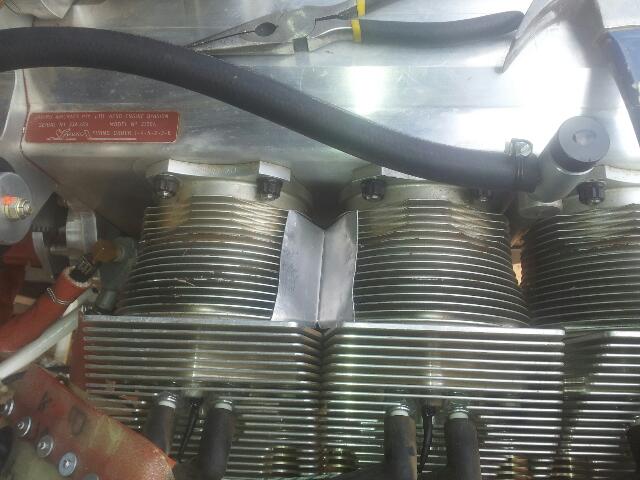

Still fighting with temps. I have now installed EGT probes on all cylinders, so I have a much better idea of what is going on. Turns out the main problem is at full throttle, where there is little turbulence from the butterfly. In this condition the EGTs just go crazy. Len has a simple solution though - just close the throttle a tiny bit, and everything will come right.
#5 CHT was also borderline, but I think I may have it sorted now. Fitted some inter-cylinder baffles (formed on top of the cylinders, but installed underneath):
Makes a massive difference on the ground runs - still need to see what it does in the air though.
Unfortunately, until I have the temps safe, the test pilot will not sign it out. So this testing is horribly slow. Need to wait for a weather break + test pilot to be available at the same time. And now he is away until January - so will not be much more progress until then.

Justin those baffles are called "forget-me-not plates" and with good reason, you have now discovered why
I know Jabiru does not come with them, but I am 100% convinced if all Jabi engines have them , there will be no more cylinder and head issues
Jean
Jean

Yup. The Jabi installation manual doesn't really want you to install them... Says only to install them if you have CHT issues without them. But then, it also says you must install them on top of the cylinders!JeanTree wrote:Justin those baffles are called "forget-me-not plates" and with good reason, you have now discovered whyI know Jabiru does not come with them, but I am 100% convinced if all Jabi engines have them , there will be no more cylinder and head issues
Jean
Hammered some 1020 sheet to tightly fit the contours of the cylinders - so they have a much better fit than jabiru's recommended angles...

OK - tried every trick I could find today - all in one go. Added ramps over the vertical plates in front of #1 and #2. Drilled the air dam above #3 and #4 into swiss cheese. Added lips to the cowl exit area.
Not sure which worked, but temps are OK now. With an OAT of 27C, I climbed 1000' with the highest temp at 175C. Temp was fine at all cruise settings, and only 165C at best cruise (2750RPM, 88KIAS).
Still some work to do. #1 and #2 are too cold, so I need to raise the ramps a bit. #4 is also a bit cold, so cut away some of the air dam. But at least I can safely fly the plane now.
EGTs are OK ish. They go all over the place at full taps, but Len says this is normal. Just reduce throttle a hair and they all come back. At cruise settings, everything is pretty even.
All in all, I think I am getting there.
