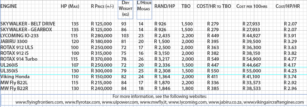

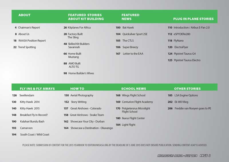

See the engine review story in the latest Microflight Africa - page 185
https://www.dropbox.com/sh/rbgj9nha84h ... sHnc0Nurra
