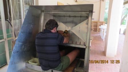

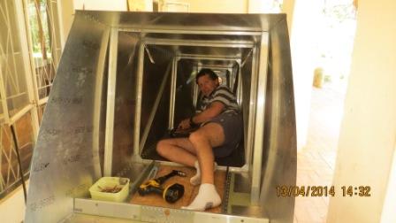

Crawling inside the rear fuselage section to rivet the corner gussets into position. Not the most spacious place to be working in vhpy

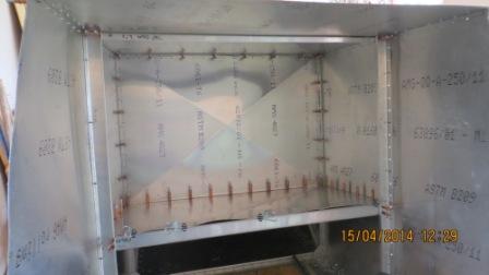

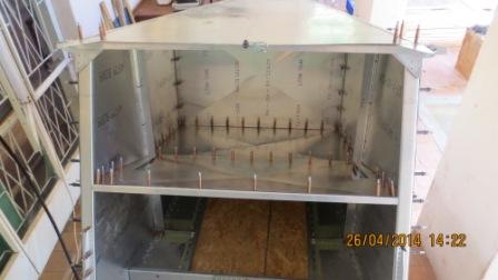

62B Extended baggage compartment completed.jpg (25.65 KiB) Viewed 21188 times
Completed the extended baggage compartment today, still only at cleco stage, so will dismantle prime and rivet assemble according to when the build instructions indicate riveting can begin on this section.

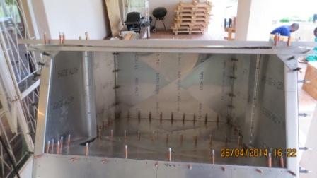

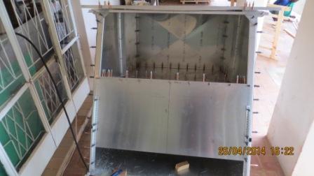

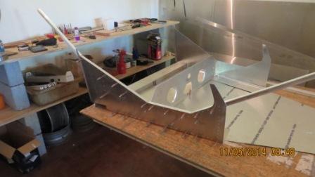

Just finished fitting the baggage compartment panels and side skin uprights and up right doublers. Now to strip it all down, deburr, prime and rivet.
Next section to tackle is the front fuselage section and firewall assemblies.

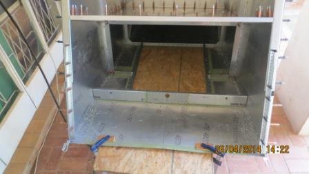

Completed re-installing the baggage compartment panels and finally riveted the assemble last nite. So the rear fuselage section is now complete as per the plans build instructions thus far.
Glad this section is done as it had to be assembled on the veranda so with winter coming and cold evenings on the way this was completed just in time. I can now move back into the lounge to build the forward fuselage sections.
I swopped the dinning room for the lounge with my kind wife as I need more working space xxx
Now starting on the forward fuselage section, most parts already pre made only left a few parts to manufacture then the fun begins when I come to join the front and rear sections,but before this happens there is lots to be done,including making up the firewall.
I am using the Rotax rear engine mount bracket. Zenith dont have drawings for the FWF mount to mate onto this rotax engine mount bracket but do have the jig to make up the mounting so this is on order from them along with a variety of other parts.

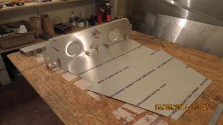

67A Cabin floor with seat and bootom channels.jpg (28.11 KiB) Viewed 21069 times
67 Cabin floor with seat and bottom channels.jpg (26.31 KiB) Viewed 21069 times

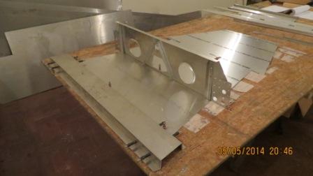

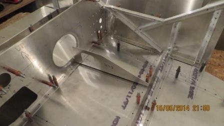

Started assembling the cabin floor with the seat channel and bottom channel fitted.
Now to make up the cabin side panels, couple of parts I still need to make before I can assemble side cabin panels,then join up to the cabin floor section.

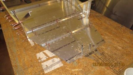

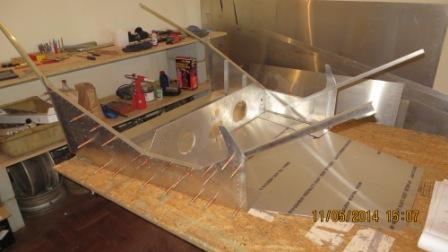

68B Both Cabin sides completed.jpg (29.83 KiB) Viewed 21031 times
68A Left Cabin side.jpg (25.88 KiB) Viewed 21031 times
68 Right Cabin side.jpg (28.82 KiB) Viewed 21031 times

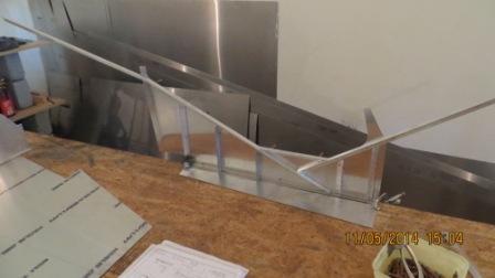

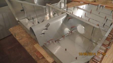

Making steady progress on the front fuselage section. Cabin side frames completed,now to fit them in the correct position on the floor skin section.

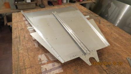

72 Tunnel fitted.jpg (27.58 KiB) Viewed 20995 times
71 Flaperon bracket installed.jpg (28.15 KiB) Viewed 20995 times
70 Front lower longerons and centre stiffner fitted.jpg (29.45 KiB) Viewed 20995 times
69 Cabin floor stiffners fitted.jpg (31.63 KiB) Viewed 20995 times
Now its startin gto get interesting, looking more like a plane everyday now. Cant wait to get to join the front and rear sections of the fuselage.

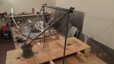

It has been awhile but the build has progressed all be it a bit slow due to pressure of work which then pays the bills so I try give work a bit of time as well :lol:

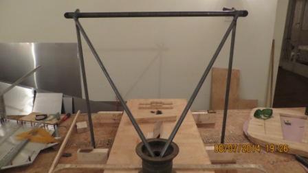

Here are the photos of the cabin frame which has been the most DIFFICULT part to make so far,but its done now. Now to make up the firewall and attach the components to it.From there we can now join the front and rear fuselage sections.

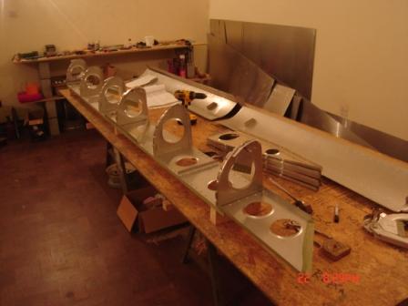

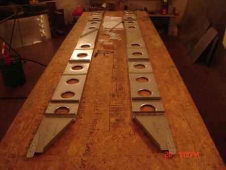

Next major step completed, both Main Spars assembled and riveted. Next is to convert my huge pile of wing parts into WINGS vhpy vhpy vhpy.
Unfortunatly I cant mate the front and rear fuselage sections until the wings are completed as the distance between the front and rear wing mounting points is required to set the mounting distance on the cabin frame assemble wing pick up points.

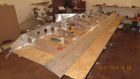

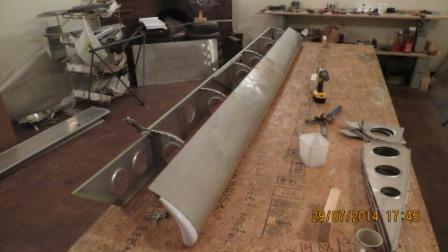

76A Nose-Rear ribs fitted.jpg (27.73 KiB) Viewed 20779 times
75C Trial fit flaperons.jpg (29.21 KiB) Viewed 20779 times
75A Trial fit Slats.jpg (30.17 KiB) Viewed 20779 times

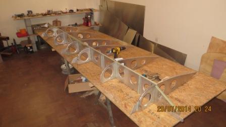

Right wing assembly progress, starting to look like a wing now,long way still to go to complete the wing frame work.Sure the left wing will come together quicker once I know how it all fits together. Still got to make a few very simple jigs to progresss the wing build vhpy

Z-MRP
Posts: 190
Joined: Fri Jul 25, 2008 11:35 am
Re: CH 701
Postby Z-MRP » Thu Jul 31, 2014 8:43 am
Hi Hennie, can do, but I have not got all the brackets fitted for attaching the slats. It was just a dummy check to see if everything lined up as I had a small issue when making the slats,slat attachment brackets ended up 10mm off where they should be. Looking at the dummy assemble its going to be very simple to correct this error so am pressing ahead on the wings now. I was so clever ## ## I duplicated the error on the opposite slat as well (**) .Lucky with a plans build some of the minor errors you can build then out as you go as nothing is predrilled as with a kit assemble.So most times you can move the attachment holes to suit and problem solved.With the slat bracket error 4 flat washers split over 2 brackets corrects the error.
