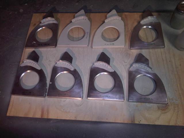

I had a terrible "building week" last week but plan to play some catch-up this week. The nose rib brackets are complete and the right wing skeleton is well underway. I now need to organise my wing strobes before I skin the wing. I also need to install a fuel sender unit on each wing tank (the thought of which keeps me up a night - something about cutting into a perfectly good fuel tank that scares me).

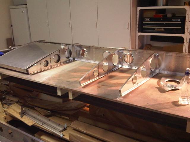

Nose Ribs - decided not to prime the whole rib and wait until the wing skeleton is finished

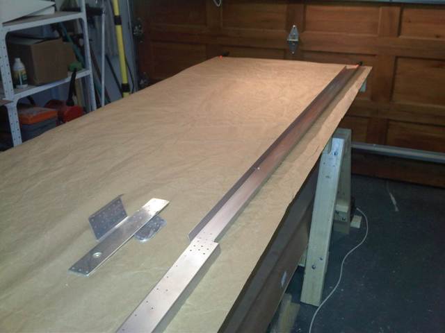

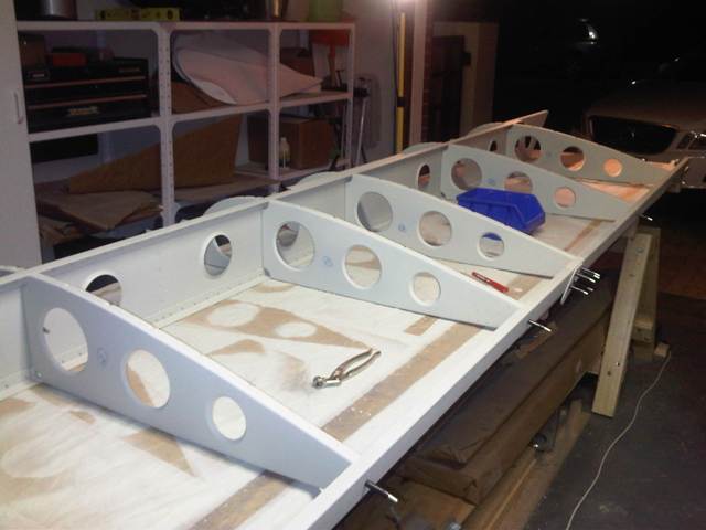

Wing skeleton clecoed together and the edges and corners deburred and rounded.
Right Wing Skeleton

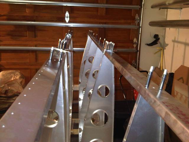

Another photo of the wing.

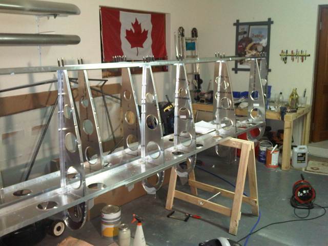

The guys on the build video build the wing on a pair of steel tressles (saw horses). Anyone know where I can buy these? I have been to most of the big hardware stores, but can only find the cheap pine ones. I would like to build both wings in tandem to save on time.

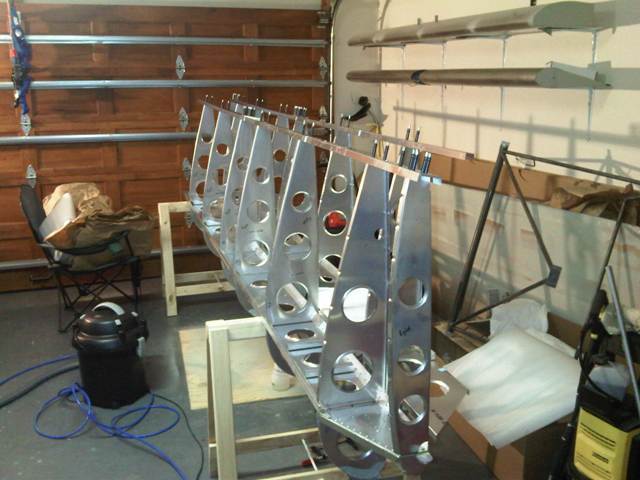

Another milestone complete - finished construction of the wing skeleton (both wings). Now I need to disassemble, debur, clean, prime and rivet together.

The wing skeleton is held together with A5 Rivets (the big ones). I may need to organise some more black A5 clecos - used every last one I have. :?

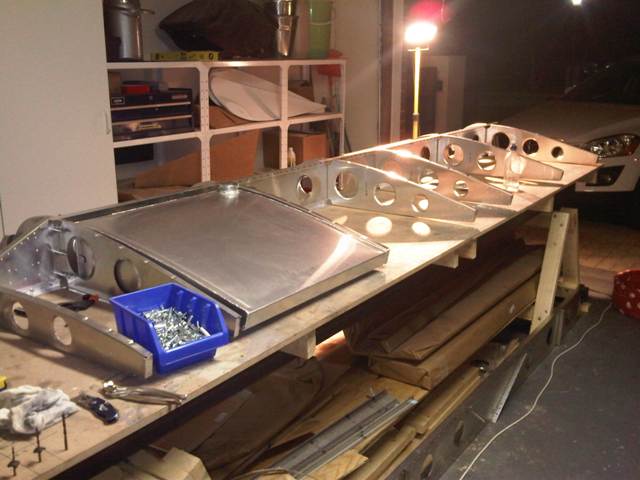

After a weeks break, I am back in the swing of things. Finished priming the right wing skeleton last night.
Table set up for spray painting

Wing skeleton finished - will rivet together tonight. I'm glad I kept all the wrapping paper to use when spraypainting.
All done.
