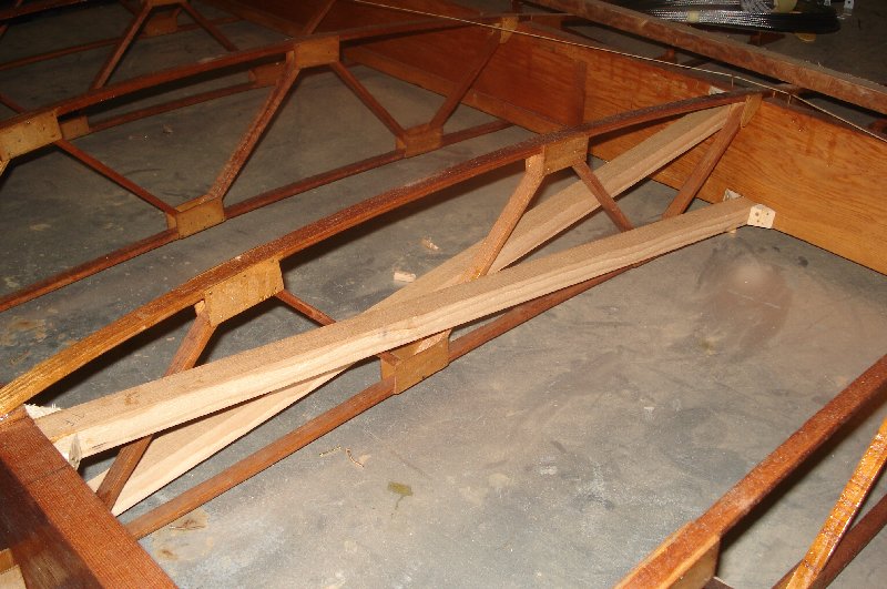

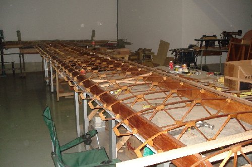

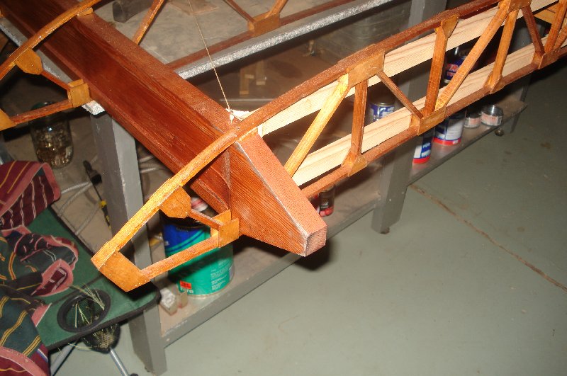

Re: Pietenpol Aircamper
Bryan,
Yes, I've been very slack with updating my build report.
I have assembled the main wing ribs on the spars and temporarily joined the spars in the middle with off-the-shelf DIY bolts until I can get the proper AN bolts in the correct size. Does anybody have six AN6x51 bolts with nuts lying around somewhere, not Placo nor RAP has any in stock.
I have also stripped all of the metal parts off the fuselage, painted and re -fitted them.
I have fitted the elevators and will fit the rudder this coming weekend.
Also for installation this weekend is the drag- and anti-drag wires inside the main wing.
I have fitted the center struts on the fuselage and had to remove some plywood covering over the instrument panel housing in order to fit the bolts. I will have to replace the playwood in a way that can be removed easily without damage for future maintenance.
The next big issue will be to "Steam and bend" the 1500mm long Spruce wingtip formers. I plan on using a 110mm PVC pipe fitted over one of the wife's cooking pots and made to stand over a gas burner. I will make one or two test attempts before placing the final pieces in the steamer.
I also need to source a stronger tailwheel coil spring as the bigger external spring that I have does not nearly take the weight I need it to take. It collapses fully under the aircraft own weight, even without the full empennage fitted. I will have to look at something with a 38mm diameter x 150mm long coil spring constructed of min 6mm thick wire.
Unfortunately all of the photo's taken during the past couple of weeks are on my VERY unreliable friend, or soon to be EX friend' digital camera. He is currently on a work trip into the Northern Cape and should, for his sake Hopefully, be back within the next couple of days. As soon as I can get him to download the pictures I will post some.
