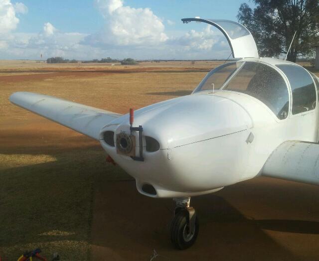

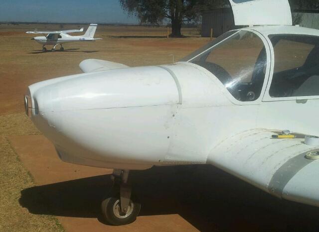

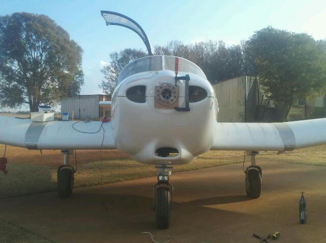

First, fit the cowl, with clamps, centring everything on the prop hub, and positioning with fibre tape:
Once everything looks good, the bottom cowl is drilled, and screwed to the fuselage (you can also see how the top cowl has been extended - by Arthur - so that it now fits):
Once that is all done, the top cowl is trimmed to fit flush, then bonding/reinforcing strips epoxied in, hinges flocked and riveted in place, joggles formed, and NACA duct cut in and bonded. One sentence that took a solid week of work to complete...

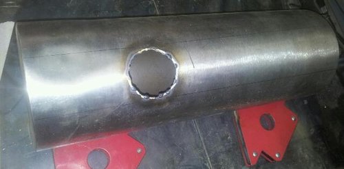

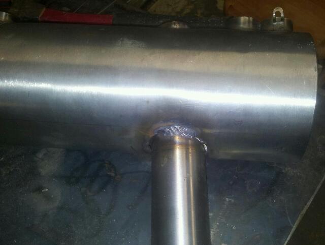

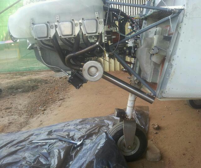

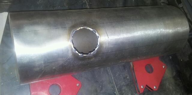

Next was the exhaust. I was not 100% sure how to do this. Cutting those big holes out with a dremel was just not working, Neither was drilling out the 30 18mm holes in 1.6mm stainless steel for the tailpipe. That stuff is tough! Fortunately, someone mentioned that they had the holes burned through at an exhaust shop - so I thought I would have a look-see what a TIG could do. The tests on some scrap stainless looked perfect, so it was time to try on the real thing. 180A in one spot resulted in a nearly perfect hole of around 18mm in diameter. So for once I managed to put my best welding skill (burning holes through anything I try to weld) to use... A few minutes later, and all 30 holes were neatly burned through. A little work with a grinder cleaned them up and removed the slag. Unfortunately, I forgot to take pics of the tail pipe, so you will have to take my word for it! (I did learn an important lesson here though - when you crank up the amps on the welder, remember to set the helmet to shade 15! Doh!)
The muffler was easier, being of relatively thin steel. A steady hand and a low current, and I could cut out a fairly (round) hole...
Repeat on the other side, and out to the air field for a trial fit. Perfect:
Tack it in place with some epoxy, and then back home for welding:
In the end (as usual for me, welding thin sheet to thick, I spent more time chasing and filling burn-throughs than actual welding. So in the end, I just tacked it (as above) and took it to Noise Boys for a full weld. Really wish I had just finished the job myself - the Noise Boys weld looks mechanically sound, but is ugly as sin. Fortunately no pictures...

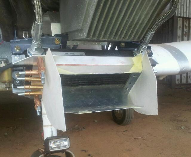

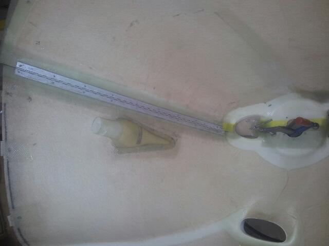

The last fairly time-consuming bit of work is the baffle to duct the standard Jabiru oil cooler to the cowl (which was intended for the oil cooler that Jabiru Australia uses). Here is a picture of the basic frame:
Making the sides ended up more difficult than expected - so I just wrapped the whole thing in fibreglass. No finished pics, but it looks quite good, and fits perfectly.

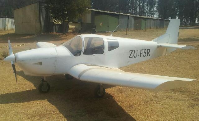

And finally the finished product:
Actually, not the finished product yet - the factory sent me the wrong prop bolts, so it is just tacked together for show. But SOON!
Hopefully get the new prop bolts this week, and do some test runs over the weekend. Inspection the week after, and away we go!

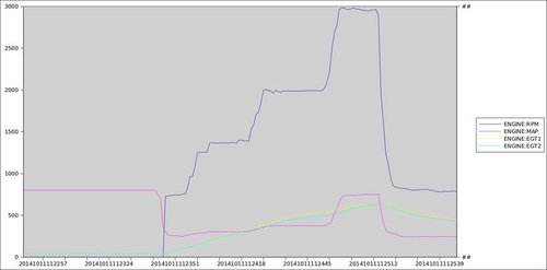

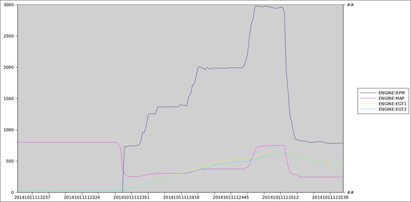

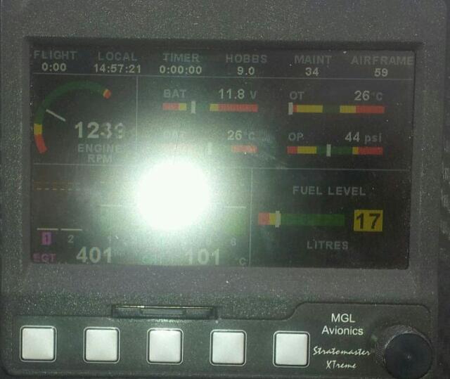

OK. Did some work, but Wx prevented further test flying.
1) put a vertical flow divider in the induction pipe
2) figured out how to get MGL Xtreme data recording working (turns out you need to switch recording off and back on, if you replace the SD card).
Did some brief engine runs. CHT limits preclude any extended full power runs, but got this plot:
Can see the following:
1) always starts immediately and settles into a smooth idle at 730RPM.
2) EGTs are well balanced at low power and at full power. Seems to be some divergence at around 2000RPM - but no idea how they would settle with time.
3) Full throttle RPM just a hair shy of 3000.
4) MAP (in mb) - can see the induction restriction is quite bad, but apparently normal for Jabs.
