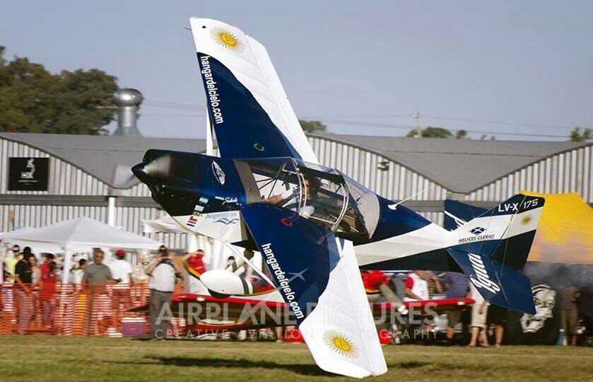

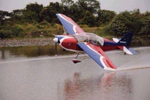

Johnorr wrote:Found the main wing spars severely corroded .
And this is probably why it happened
- IMG-20140403-WA0002.jpg (23.76 KiB) Viewed 907 times

Re: Rans S 10 Sekota
And more reason to make sure the wings are strong
- IMG-20140403-WA0001.jpg (4.25 KiB) Viewed 907 times
I do not plan to fly like this I might do the same style, the difference will be the altitude.
I will not do this kind of flying under 3000Ft AGL. I will leave it for the Argentinian guys Ernesto and his team.
I was just thinking about steep pull ups where the G's might become high.
You are kind of lost with a broken wing, I rather rebuild the wings then I know it should be good.
