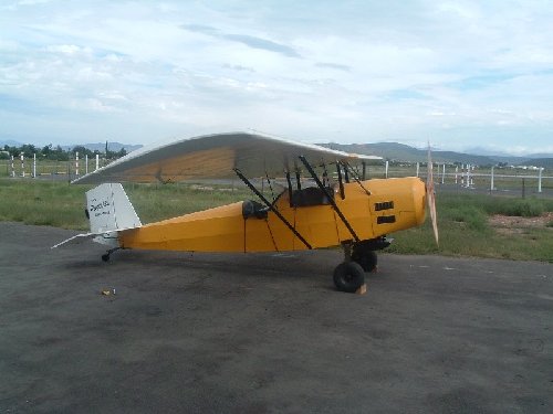

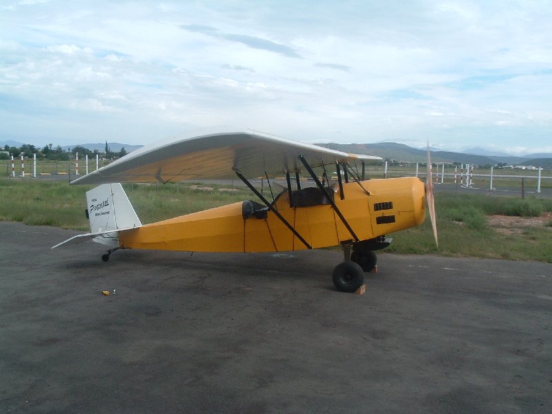

Toyota 2C Turbo Diesel Pietenpol Aircamper A La Coenie Otto of Oudshoorn, hope he doesn't mind!!
As Coenie told me a while ago when he sent me the photo's he believes he should have used the 3C Turbo instead as it is slightly lacking in power.
The fundi's out there should be able to say what HP the two engines deliver as I don't have the foggiest idea!

Radiator is in a pod between the main undercarriage legs. On the complete plane picture it can be seen painted black.
I will see if I can find close up pic's of the radiator pod.

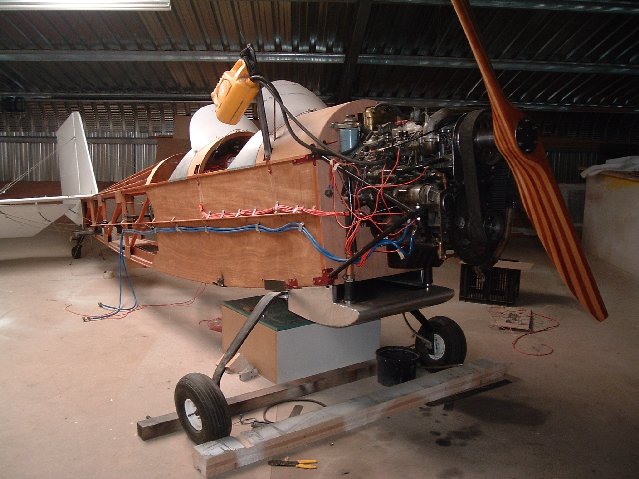

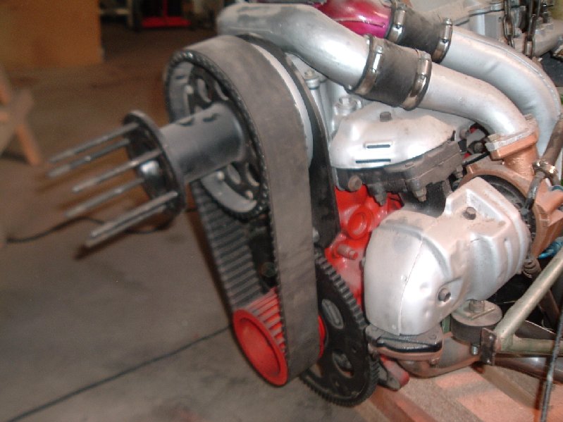

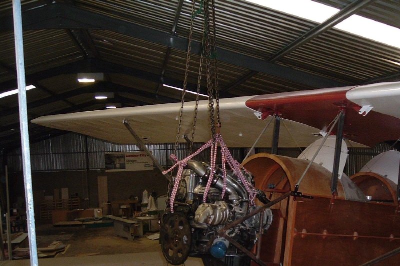

What concers me is that the flywheel has been replaced by a drive plate used in the automatic cars. This will definately be too light for a diesel motor and will cause the reduction belt to break prematurely due to torsional vibration.

I see you have a substansial reduction ratio,
can it be that you are simply be running out of usable RPM ?

IMHO Ithink the ratio of reduction, size of prop and, more specific, the pitch of the prop might all have to be included into the calculation before making a final call.

The reasons for the diesels are simple. I wanted to be different and keep things as simple as possible. There are a less flammible fuel on board, electrics are simler, no plugs etc. A lot less that can go wrong.
The Pietenpol was designed to carry a heavy motor so the closest in my price range for an engine was a 2C turbodiesel which can still be bought for around R 5500.00. There are a lot of newer diesels from all the different car manufacturers available now that were not so freely available when we started building in 1998.
Horsepower according to the salespeople on the 2C motor is around 70 to 80 hp. With the reductiondrive there is enough power to cruise at 75 to 80 mph. I have flown her straight and level at 100 mph. Fuel burn still needs to be checked but an estemate is 6 - 8 l per hour. I will confirm that at a later stage.
The flywheel was a expensive little excersize as a previous person commented on. After 2 beltbreaks we fitted a flywheel and have no more problems. Luckily they did not break in the air.
