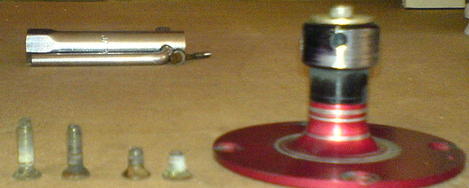

OK - here are some really cr@p camera phone photos. Impossible to see if the bloody thing focussed correctly until you load it on the computer, and then it is just too late!
Here is the trigger magnet assembly. Note the varying length bolts to the left. They all started out the same length - the rest is still in the flywheel. All but one had sheered completely. All the roll pins had also sheered. As a result, everything was a bit wobbly. As you can see on the trigger magnet to the right, it had been rubbing against the sensors.
The entire flywheel was also wobbling, and as a result the stator was also rubbing. You can see a nicely polished piece here:
The same for the primary ignition magnet and pickups.
I don't really know how to check how much damage was really done - I am sending off a post to aeroconversions now to ask...

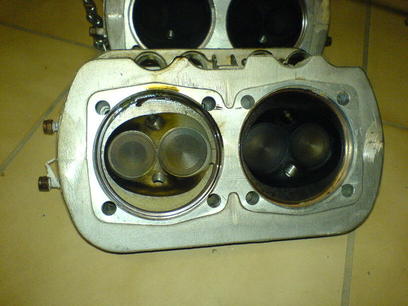

And more bad news...
Pulled the heads, and got a beautiful view of what detonation does to a cylinder:
You can see the classic yellow deposits in the centre, as well as the melted, and eroded aluminium on the right. In the right-hand cylinder, the hone marks are still perfectly clear (although the piston crown is carbon coated - running waaayyy too rich).
The cylinder bore is heavily scratched. I get the distinct impression that this engine must have seized, or come very close to it. I can't believe the previous owner didn't realise he had trucked up the engine...
The cylinder head:
Head gasket melted, and burned away. And a nice trench burned into the head, on the side of the combustion chamber...
The cylinder head:

JôJôJô!! Ai man, that's not the thing one wants to see. But you have two excuses now; rebuild the engine and you know it's new or buy another brand.....
Luckily the previous owner wasn't flying above the sea. Could have seized up completely and then something about a boat anchor accordingly to someone there in Moerlandspan

Yeah. I reallise that I am waayyy too trusting to be in this business. This is the second time I have bought a dud from supposedly reliable people (or people with good references).
I don't think this was the engine builder's problem. The compression ratio checked out correctly as 8.0:1 - the engine was probably run on mogas and/or not maintained correctly.
I will get my AP out to give a second opinion. If he is also of the opinion that the owner must have known there was damage, then I will contact him. It is vaguely possible that he just did not know...

At 8:1 compression you will have to run really massive timing advance to cause detonation even on mogas. Somebody got the timing setup way wrong.
- Posts: 1234
- Location: Pretoria
Re: Justin's Raven
Hmmm... The timing is pretty fixed. It can only change by a degree or two. It could have been bad fuel, or possibly a chicken-and-egg situation.Stephan van Tonder wrote:At 8:1 compression you will have to run really massive timing advance to cause detonation even on mogas. Somebody got the timing setup way wrong.
I just got an email on the AeroVee list, where someone had a similar problem. It started with a loose head stud, which allowed combusion gas to seep past the head gasket. which then melted. For some reason, it seems that once the head gasket is blown, you also get detonation (or at least the same results). No idea how, or why though.

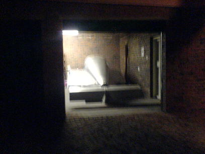

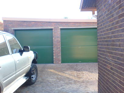

On a side note, I finally finished installing the new garage doors this morning, and got the Raven safely stowed in her new home!
Some more cr@ppy cell phone shots: The Raven is 2420mm wide, and just does not fit through a standard garage door at 2400mm. Had to widen the opening, and fit the biggest standard doors I could find.
And more good news. Got word today that I have indeed got a hangar at Rhino, and even got someone to sub-let it until I am ready to move in! Many thanks to the Rhino guys!!!
