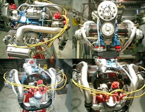

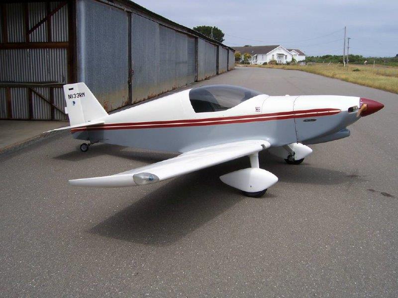

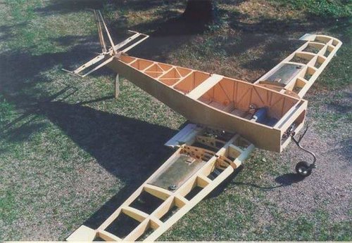

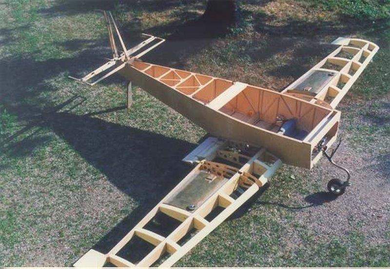

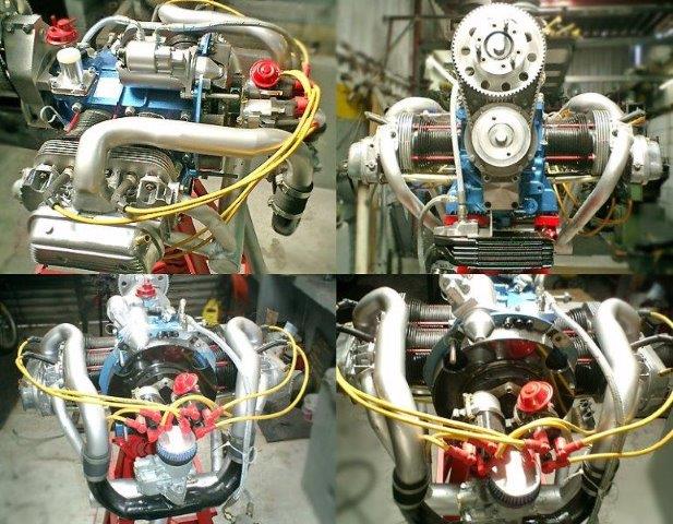

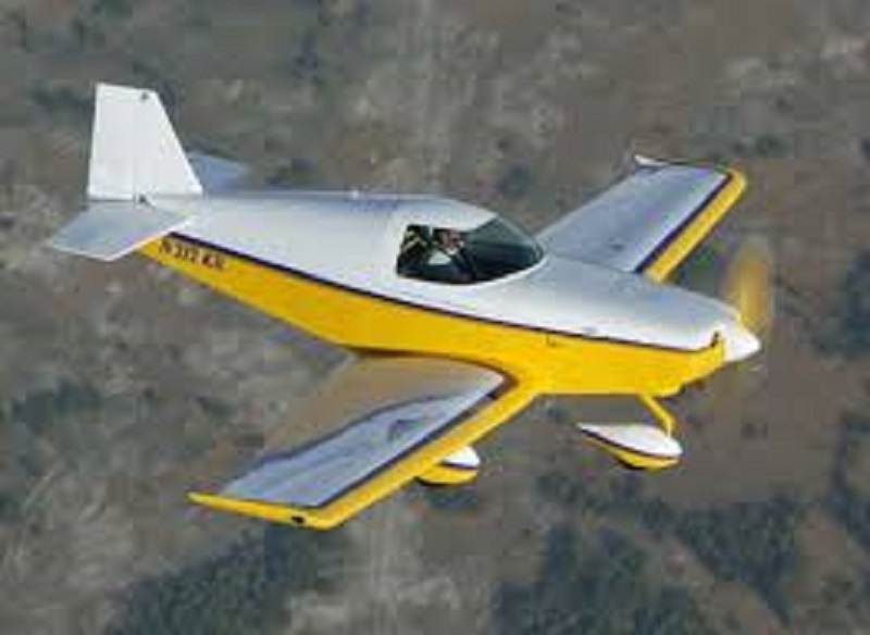

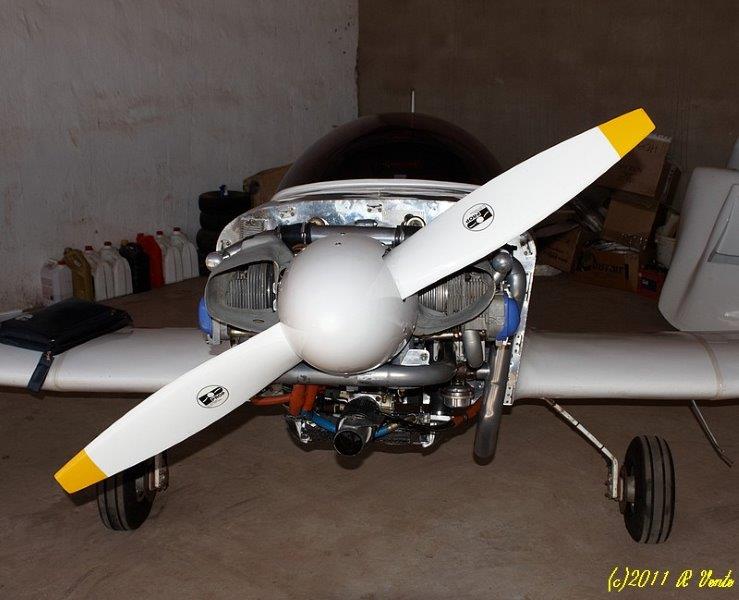

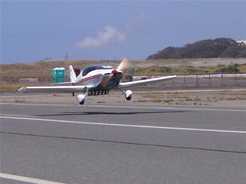

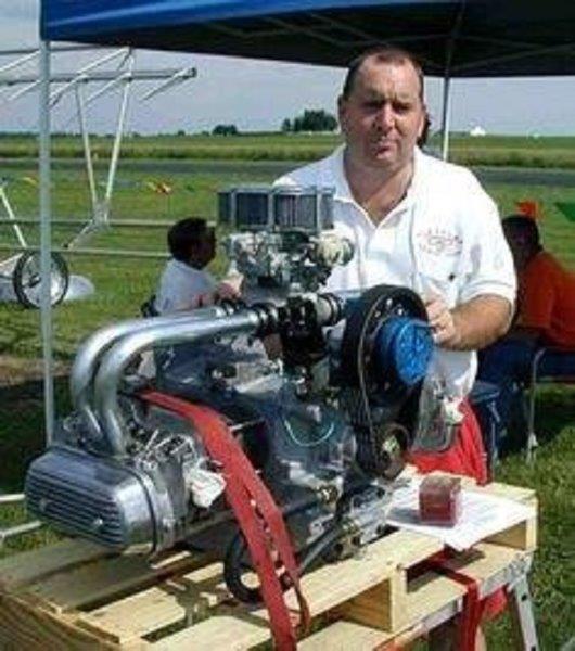

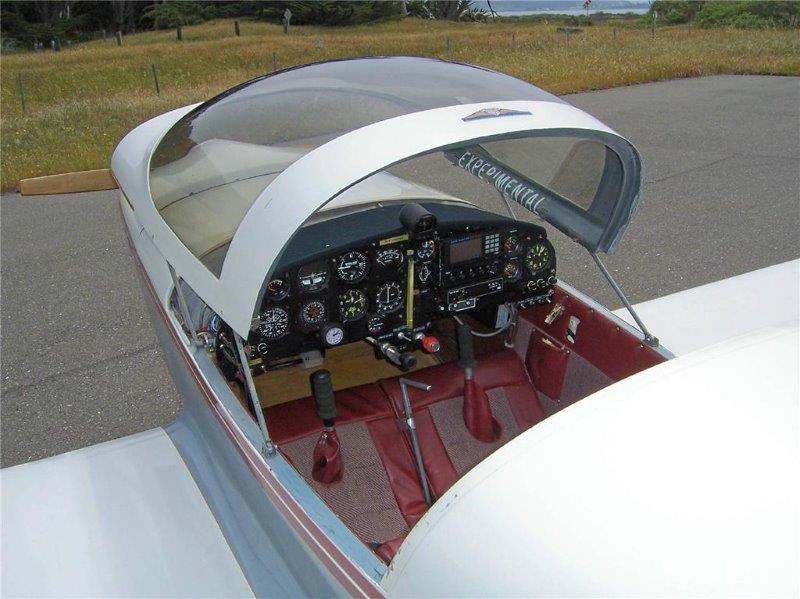

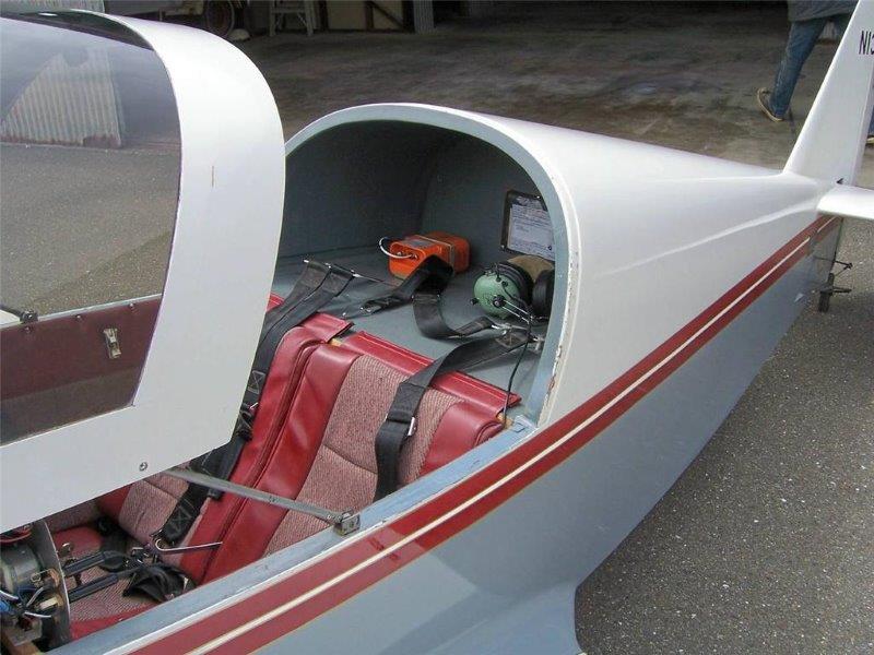

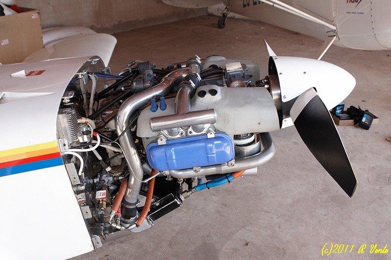

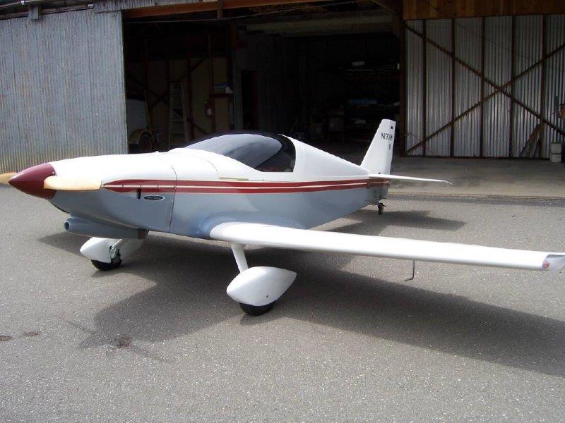

Herewith some pics of the KR2 that cruises at 192mph with a turbo VW engine. My dream was to build the lightest KR2 ever. The engine would be the main factor to achieve this. As it stands, a non electric VW with magneto would be bulky & the mag seems to be heavy. Although still for sale, The Rotax 583 that I intended to use initially is currently out of my financial reach. I can only go ahead with what I can afford for now. However, a turbo Type IV VW that I will build up myself is within my immediate reach.
Thus I'll change my goal from the lightest KR2 ever built to the fastest one ever built. I'll still keep the weight as low as I can. My ideas for the fuselage will remain unaltered. Only this time I'll change the plain flaps to the slotted type & will disregard my initial idea for using piano hinges on the tail feathers. Plans for the slotted flaps fitted to the exact KR2 wing I plan to use can be found here. My wings will only be shorter & not as wide at the root. And my wing spars will be built from wood as per the original KR2 plans.

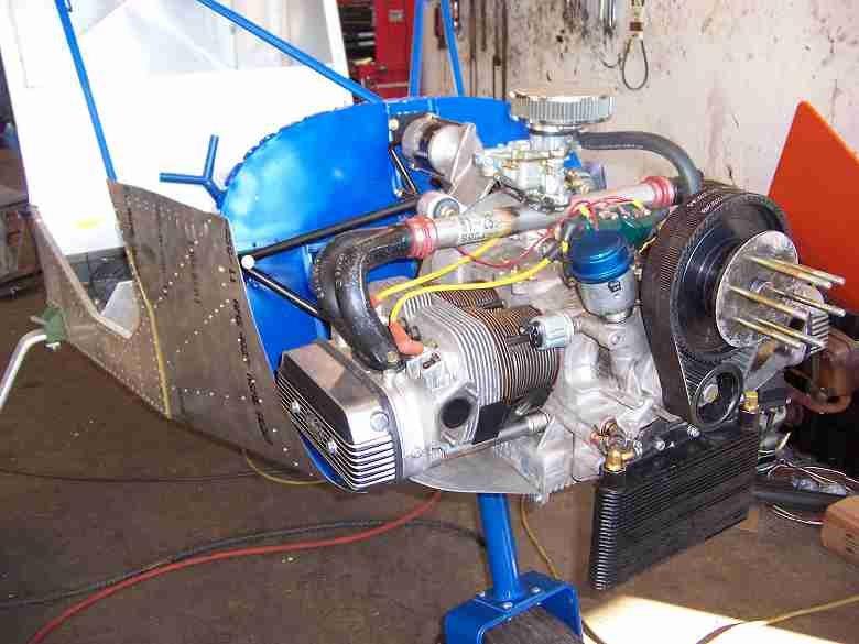

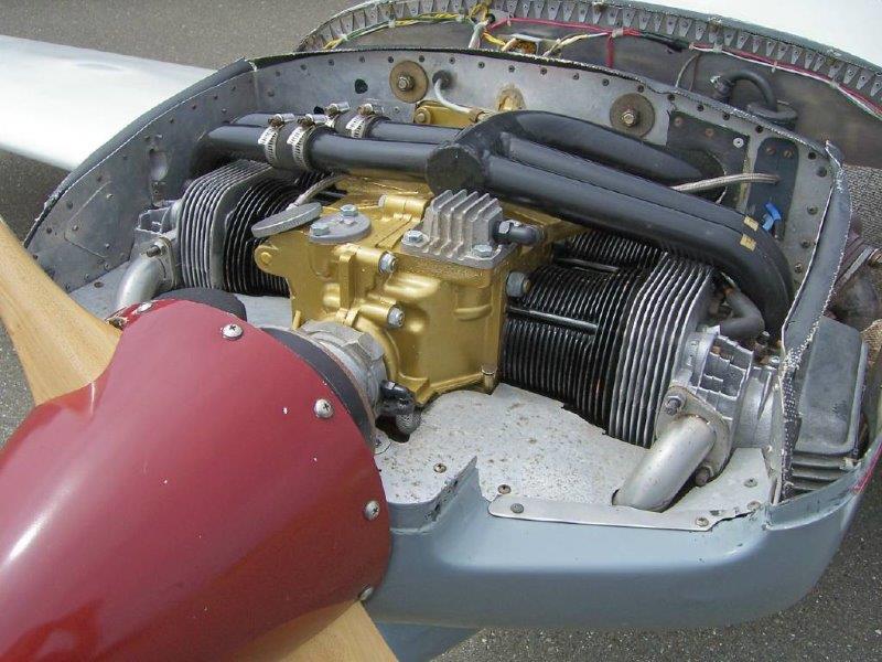

Note the Type IV engine installation right at the bottom. This standard plans built KR2 managed an average speed of 185mph in a recent race with a Pioneer 300. This included flying in both directions, so a tailwind did not influence these numbers.

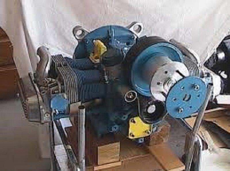

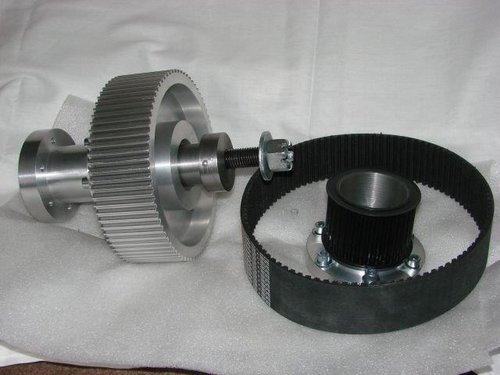

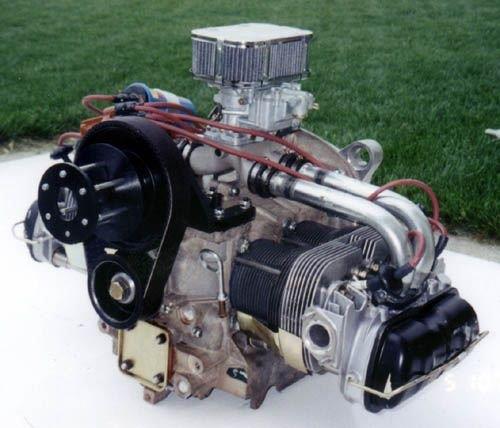

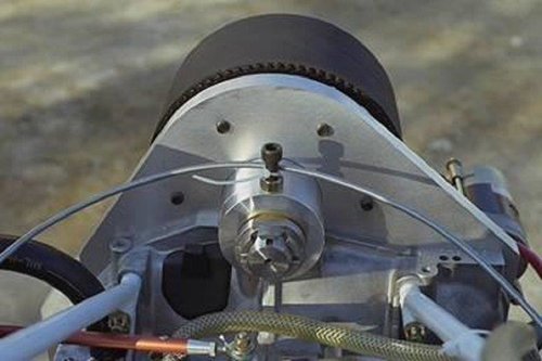

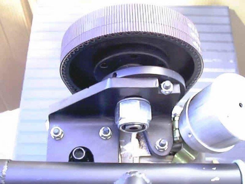

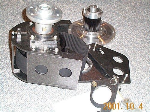

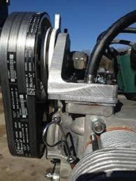

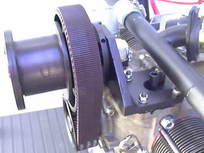

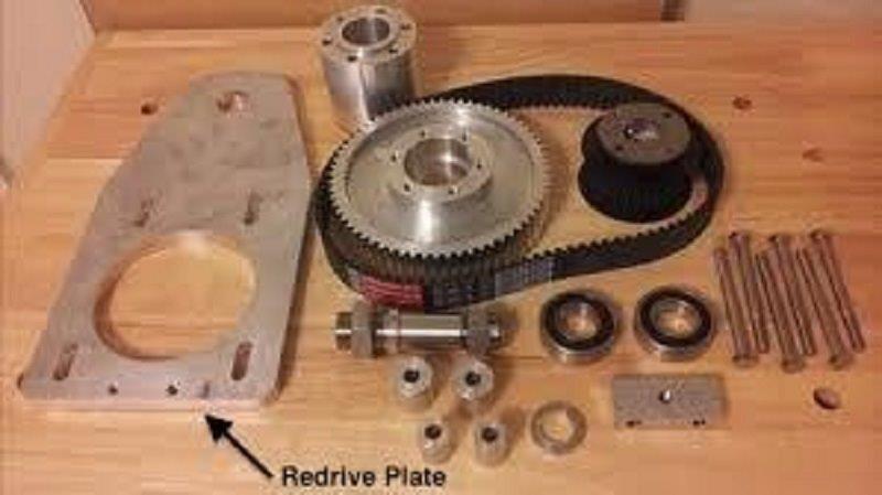

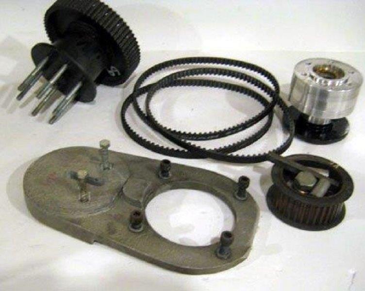

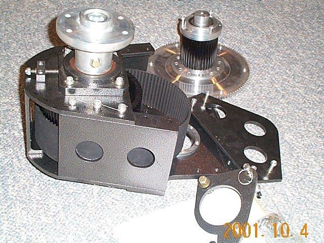

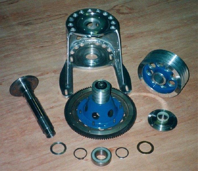

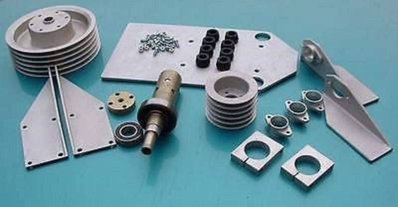

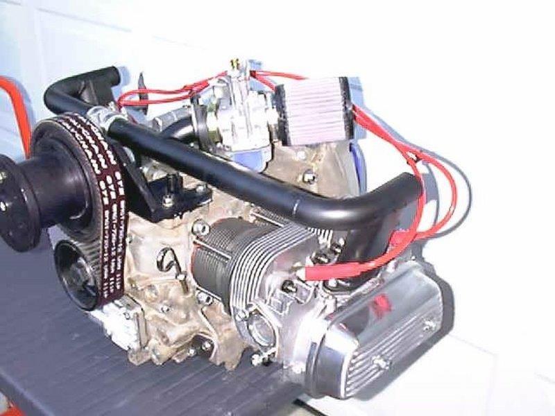

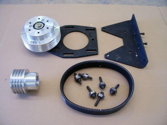

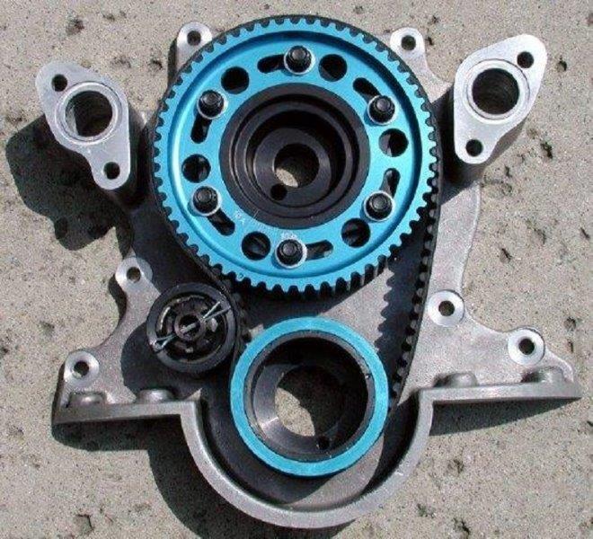

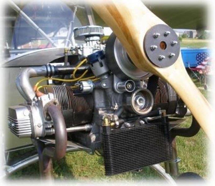

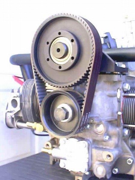

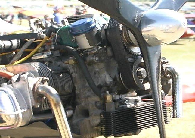

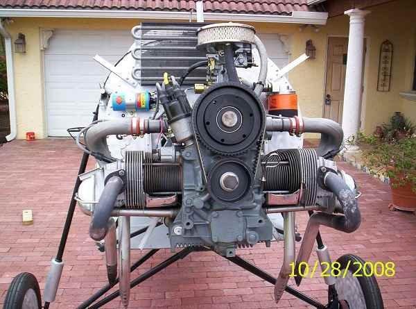

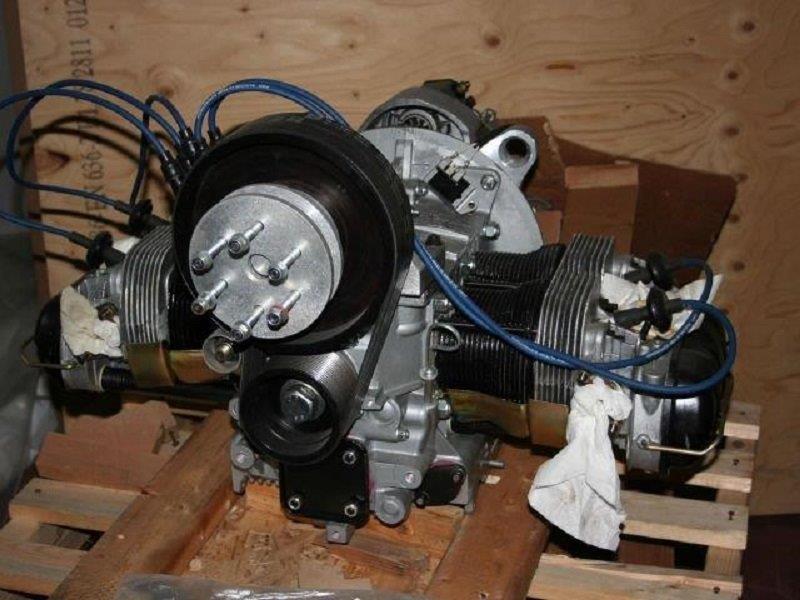

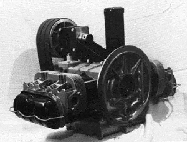

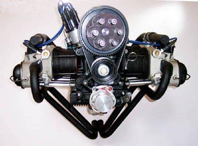

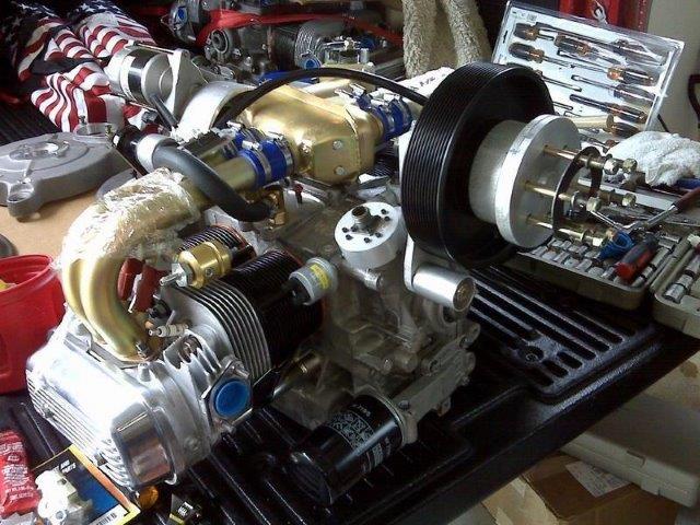

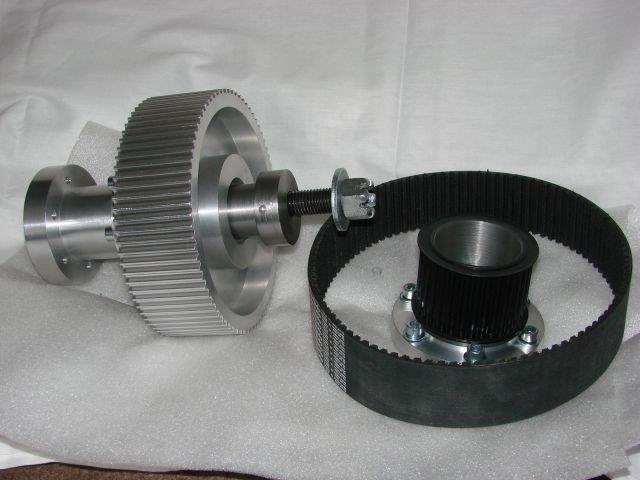

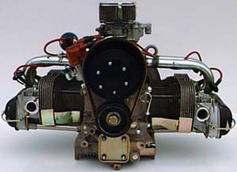

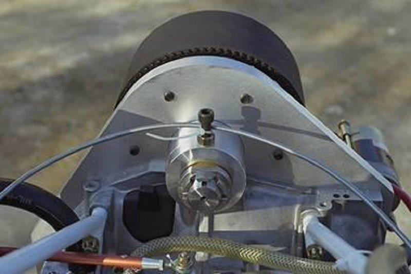

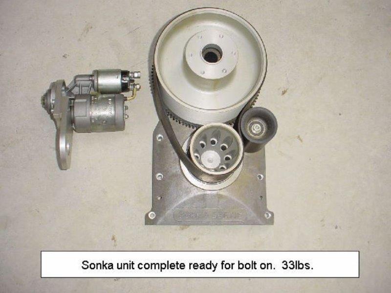

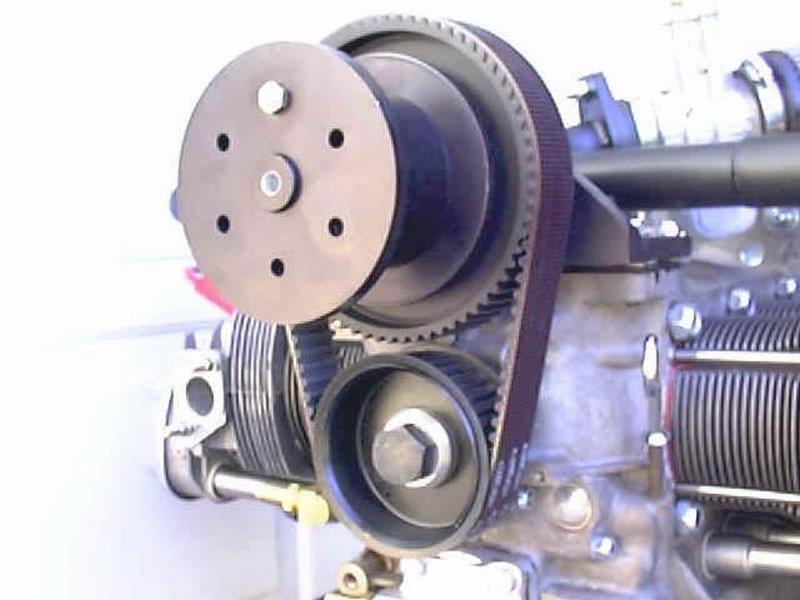

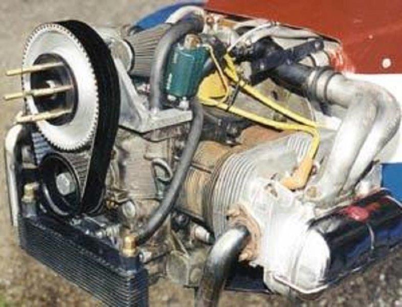

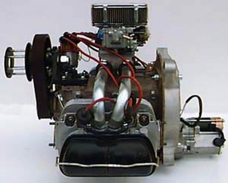

Different PSRUs on VW installations.
Which one is used on the Cubby?

Henni, daai eerste KR het n Revmaster Turbo engine in.

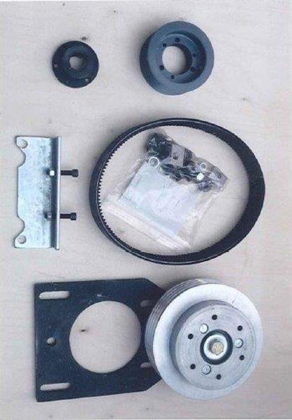

As for the re-drives, none shown is what the Cubby used....note "used". All new Cubby aircraft are developed for acknowledged aircraft engines, not converted engines with belt re-drives
If I could recommend any belt re-drive I would suggest the one from Valley Engineering. It has a multi-V belt with a tensioner, not a tooth belt. I have a re-drive like this in stock.
Henni contact a company called Aerontech , owned by Graham Blythe,...yes, Mike Blythe`s brother
. He will advise you on the correct epoxy to use for your project, also glass cloth and resin.
Jean.
Jean.
