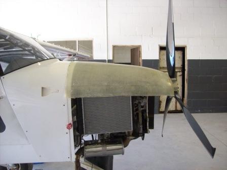

Prop confirmed delivery Wednesday prop was tested on a stol type aircraft fitted with a 80hp ecoyota engine,5750 rpm static 6200rpm take off run,3blade ground adjustable composite .

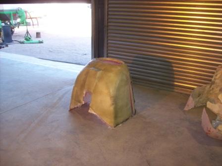

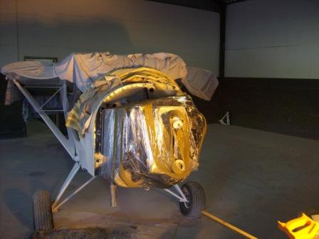

Cowl plug is covered with 3 layers of glass fibre 2 layers to go.

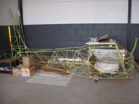

this is where it all started

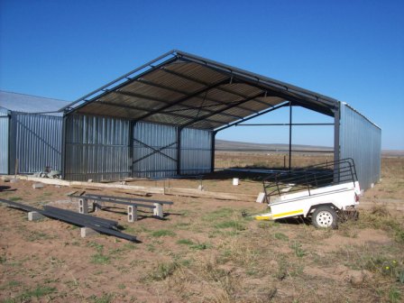

a home for the explorer

Is the hangar at Saldanha?

Oupa G hanger FASD.

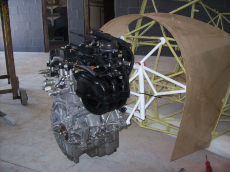

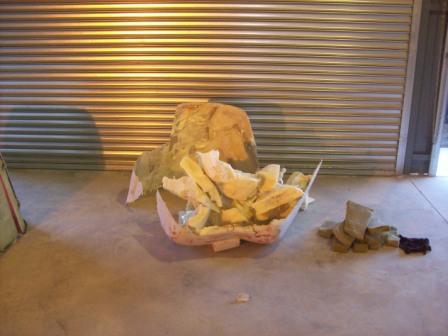

Removed the plug this morning ## ## ## ## ## ## ##
total destruction

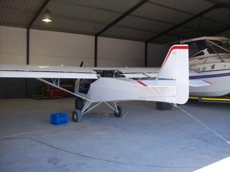

Jaaaaa swaer. Maak die "geentaliges" n man se moermeter waaaaay in die rooi in. Daai geel raampie is nou ook n errouplyn. Vlerke is 90% klaar, romp klaar geverf, nog net trim kleure doen.
Wanneer gaan jy die cowls trek? Ek is nou baie nuuskierig oor hoe die enjin gaan vlieg.

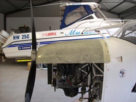

Have been busy not much time for working on the project,top cowl pulled from mould ,bottom cowl laid up one layer,

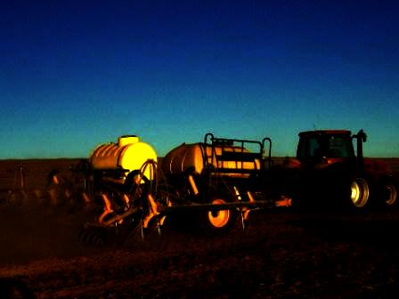

hard and dry burning 64lts per hr

And then they worry about fuel consumption.

Oupa-G you are correct regarding the fuel consumption especially if we consider what farmers realise for their produce on the market ,no GOV subsidies ,not exactly a level playing field as we compete against cheap and mostly inferior imports ,food security is not high on the agenda of the governing party.Farming is not recommended for the fainthearted .

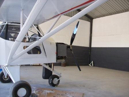

Fitted the prop and did the first full power ground run today max static rpm 5200.
tied down for first ground run
ready for start

So nou kan jy hom al gebruik vir n "wind maak masjien" op n filmset waar hulle n film maak oor n orkaan?? vhpy Ek sou reken die enjin moet so 5400 gee static. Stel die pitch bietjie fyner.

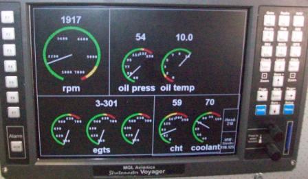

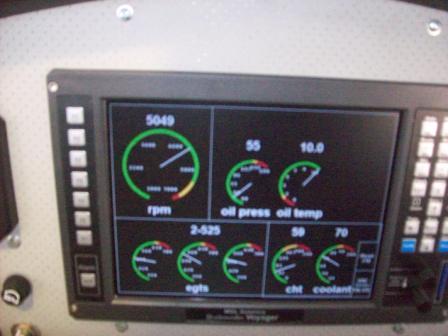

Changed the pitch of the prop geting 5650-5700 rpm static now ,the engine feels smoother through the rev range.
SPOT THE MISTAKE

Diesel dog congratulations I see your Oil temp is back to front. Were you at Anton Tallie's fly-in?

Postby diesel dog » Sun Apr 18, 2010 8:08 pm
That did not take long, very observent Oupa-G,no unfortunately I could not make the fly-in, had to represent the WEKUS branch of SA hunters at a anual shoot at Atlantis at least our team managed a bronze medal and our ladies kicked dirt in the eyes of many hard bearded men

The top photo above worries me a bit, in that all of the props I have seen with tip strakes have the strakes trailing towards the rear, whereas in this photo, they appear to be facing forward. is this right?

These props have the tips curling forward. Very pretty, very smooth, and very quiet. BUT also damages very easy and most times can not be repaired. vhpy
