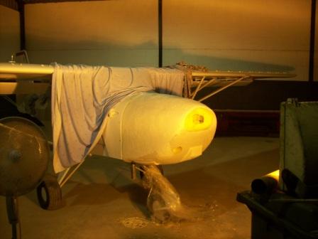

dit is nou regtig ploeg tyd van die 8ste april af gaan ons n bietjie diesel brand ,die planter is klaar gehak sal maar min tyd he vir vlieg tuig bou- Attachments
- 003.JPG (48.54 KiB) Viewed 4395 times

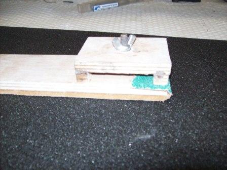

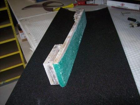

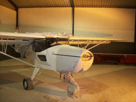

After getting an ear full from boet i made this sanding block,which has become an extension of my arms over the last couple of days

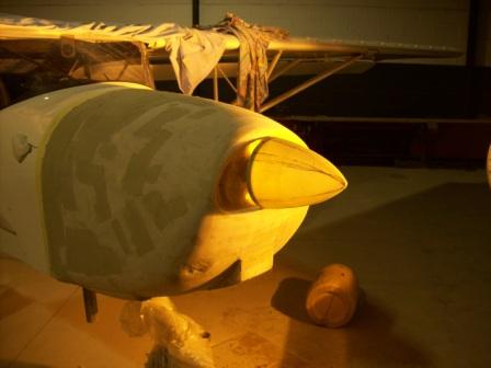

My eyes are starting to deceive me ,put on some contrasting colour to make finding the low spots easier.
Re: TOYOTA YARIS ENGINE
This just have to be the purdiest cowl for a Yaris engine ever. Diesel Dog you amaze me. I never knew you have a sculptor hidden somewhere inside....
Welcome for some more earfulls if you battle.

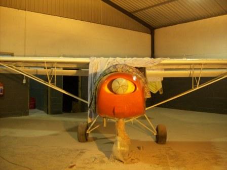

Mmmmm. En waar kry jy daai mooi spinner??
- 004.JPG (19.16 KiB) Viewed 4199 times
Verbeel my ek het onlangs ````n soortgelyke een by Loeriesfontein Aircraft Industries sien le
- Passed radio course
- Posts: 68
- Joined: Thu Nov 19, 2009 7:29 pm
Boet dit lyk vir my asof een van jou handlangers dit spinner gemaak het want jy herken dan nie jou eie handewerk nie.jy moet daai man n klop op die skouer gee die spinner is pragtig/

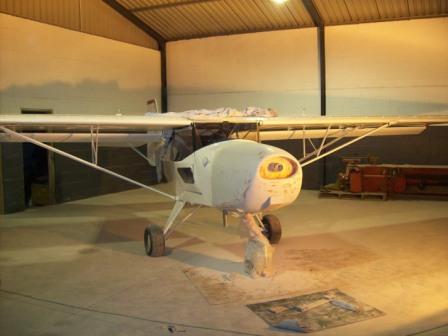

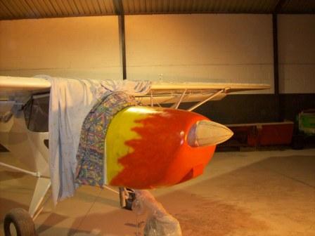

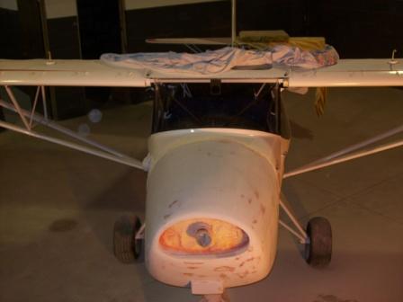

So when I landed I scrutinised the Jabi with my eyes closed,ripe watermelon for sure ,
Are my expectations un realistic for a hand made composite cowl.
The plug is now ready for spray filler
If I remember correctly from art history the impressionist movement believed to make bold brush strokes and not to rework your creation to much.
]002.JPG[/attachment]
- 002.JPG (39.35 KiB) Viewed 4119 times

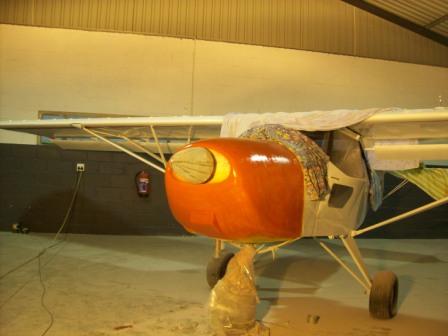

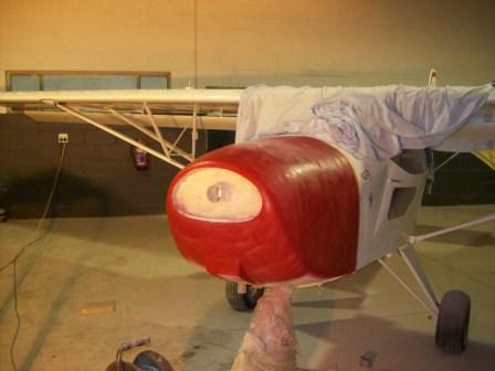

This is the last time we will see the cowl plug , going to pull mould next ,working late is starting to play mind games with me I could swear I heard music tonight coming from beneath the cowl .I WANT TO BREAK FREE , I WANT TO BREAK FREE.I think i should lock up now and go home.
- 001.JPG (38.3 KiB) Viewed 4053 times
- 002.JPG (39.17 KiB) Viewed 4053 times
- 005.JPG (34.7 KiB) Viewed 4053 times
