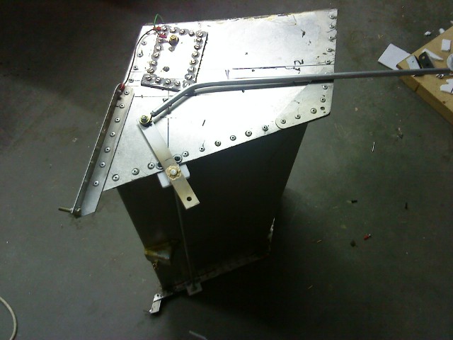

Another week, and not much to show for it. In amongst the ongoing work, I have been redoing some stuff the AP did not like (to be honest, I did not like it much either, which made redoing it a bit easier).
Firstly, I had a rather intricate cable operated throttle mixer bolted to the inside, bottom of the firewall. It worked well, but was finicky. Disturb the cable routings slightly, and throttle friction becomes unpleasantly high. After discussingwith the AP, we desided that the only option was to do something in the 20mm (eek!) gap to the sides of the fuel tank. This is the result:
The entire mechanism is slick and smooth, and incredibly solid. Uses rod end bearings for the pushrods, and brass in teflon bushes for the torque tube. A massive improvement over the previous attempt.

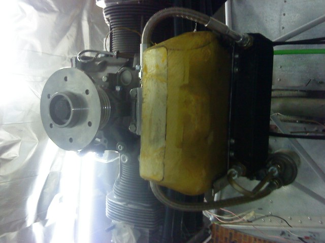

The big jobs tonight were the oil system. Fortunately I remembered to torque the drain plug before fitting the rest. Decided to add a safety wire, just to be sure.
Fitted the oil system. Nice, compact and simple - short pipes, and everything bolts on as one unit, which can swing free for oil changes.

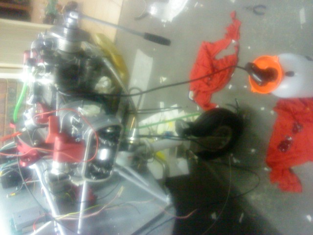

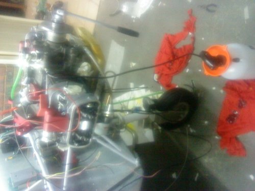

Pre-oiled the engine with a (RIP) 'Bob Hoover Pre-Oiler(TM)'. Get a cheap garden pressure spray, cut off the spray nozzle, and fit a 1/8" NPT fitting. Fill it with oil. Now pump the pressure sprayer, and hand crank the engine until oil comes out of the rockers faster than the sweat is pouring off your face. Since the rockers are at the very end of the oil galleys, you can be pretty sure the entire engine is well lubed.

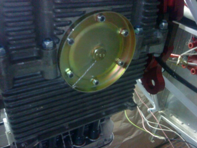

Was busy tightening the valve covers. Since they are aftermarket bolt-on covers (not the stock clip on covers), there is no torque spec in the service manual. And Aeroconversions aren't nice enough to supply one either. Now there are thick cork gaskets and rubber washers involved, so everything is hugely compressible. So I had the bright idea to just tighten it until the bolts start stiffening up (which should happen once the gaskets start approaching their compression limit), and then back it up a little.
What I didn't realise was that the cover itself was flexing - until it cracked... Going to have to take some time off tomorrow, and hunt for a new one

Justin I'm also a great believer in pre-oiling. With the tappet covers we always put in stops so that the stop is such that the the gaskets and O-rings are then preloaded.
