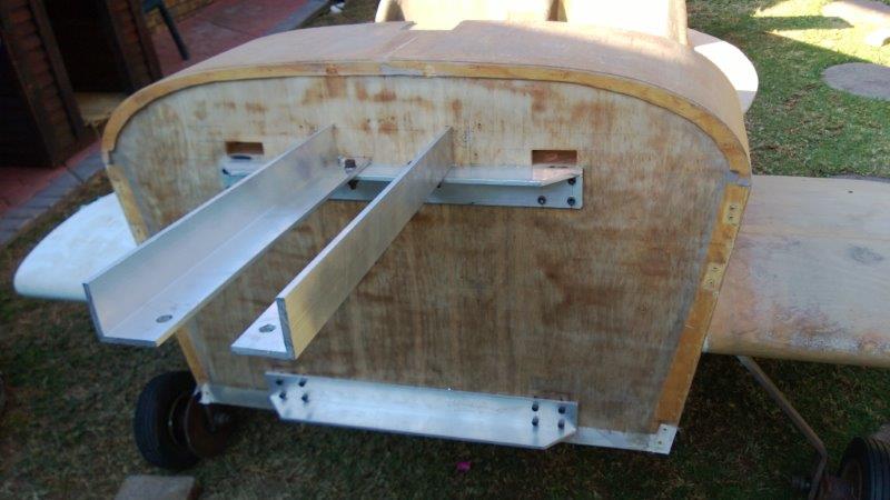

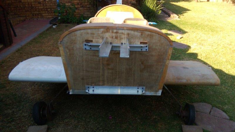

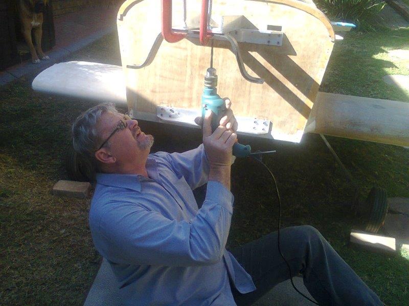

Re: Rotax 583 powered KR2
Hi all,

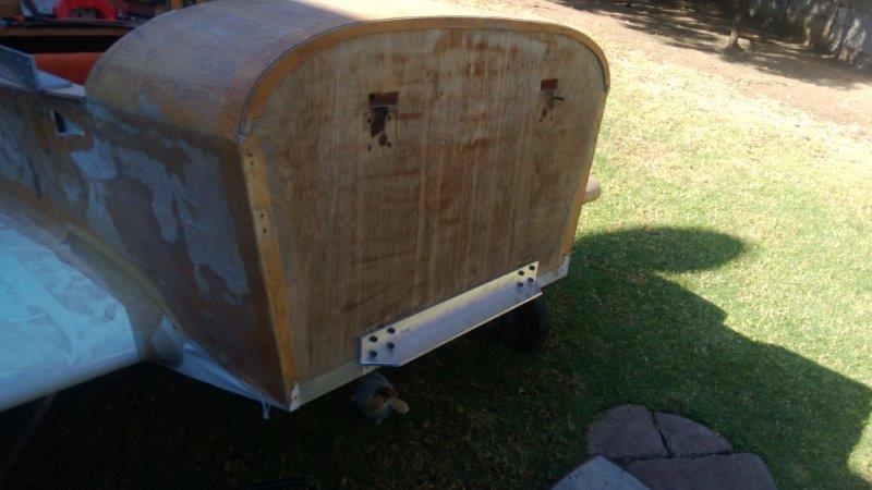

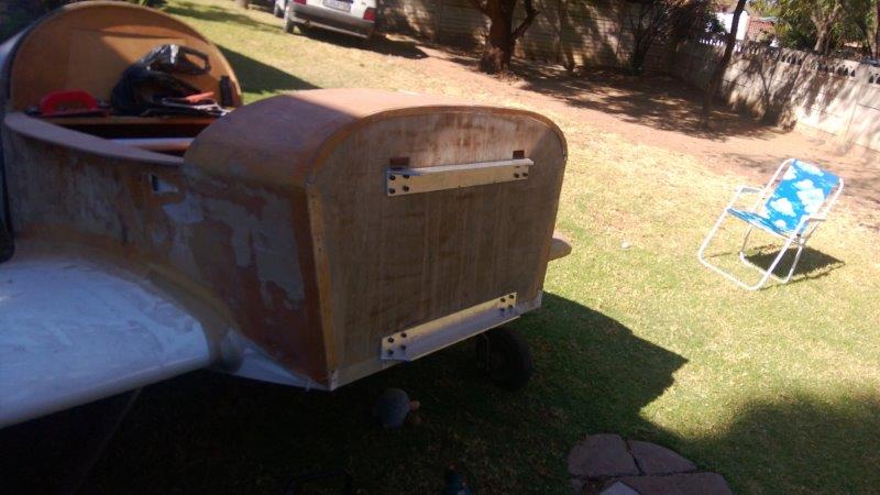

At last!!! Some progress again. Started with the engine mount today.
Keep well all my flying friends,
Henni
Henni

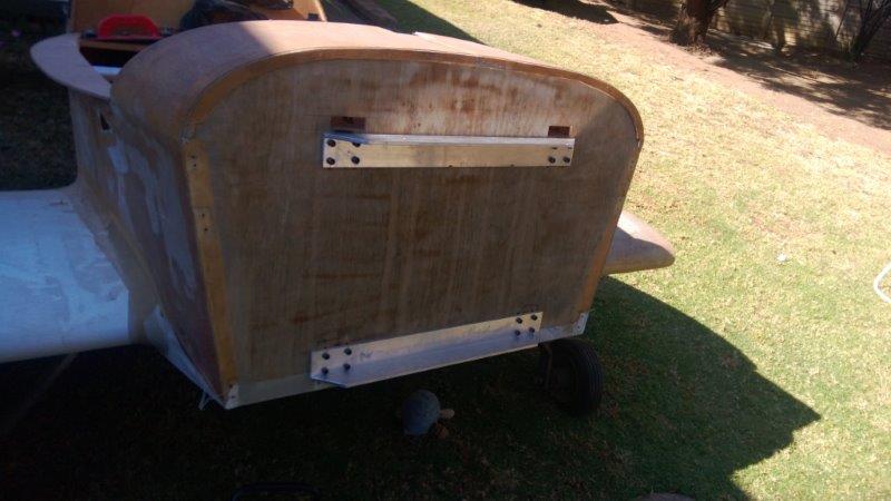

Hi Henni
Just my 2 cents worth.
U need to place fireproof material on the firewall and then place your steel sheet and cut out to shape of the firewall . The engine mount must be mounted directly onto the firewall with AN bolts and have steel plates behind the firewall in the cockpit to act as crush plates.
Have a look at what I did
http://www.avcom.co.za/phpBB3/download/ ... &mode=view
Craig
Craig
Hi Craig,
Yes, I agree. When done I'll unbolt everything from the firewall and put this stuff behind it. If you look at my pics of the Sling, you'll notice that they use some stuff that's glued to the firewall. I'm going to find out what is is and try this as a first option.
I can no longer wait till I have the required material to build. I've done nothing for nearly three weeks as a result of this.
Keep well my kind friend,
Henni
Henni

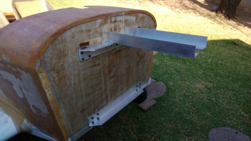

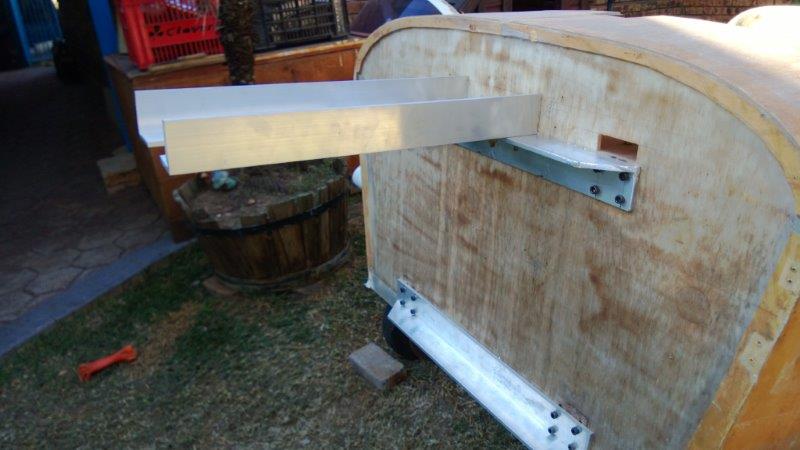

Hi all,
Making some steady progress again. Just two more holes, then I can start to hang the engine. I cannot make the bottom compression tubes before I hang the engine. It needs to fit somewhere between the exhaust, carbs etc.
Henni
Henni
