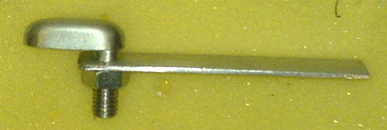

One of the last bits of the panel:
I needed a simple latch for the cubby hole, but as usual, I couldn't find quite what I was looking for at any of the hardware stores. I had some 10mm thick alu plate left over, so I thought 'why not?' and had a bash at making one myself. 6 hours, a hacksaw, a couple of files, a drill press, a die, some blood (not much, but just enough to make the work piece slippery - and add some aggravation to injury), lots of sweat, but no tears later, this is the result. (For some scale, that is an 8mm thread on the shaft.)
Not much, but I really like it - for a man with two left hands, it almost feels like I have created a work of art. I really do enjoy working with aluminium!

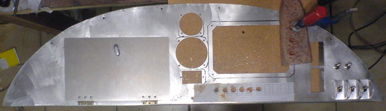

Postby justin.schoeman » Sun Nov 22, 2009 8:11 pm
As usual, I didn't get as much done as I intended... Somehow my weekends always seem to disappear before I can even blink.
Did get most of the panel finished. Decided to be kind to the neighbors, and not fire up the Dremel to cut out the last fuse holders (you can see them on the right of the cutting/drilling template).
Starting to look vaguely like an aircraft instrument panel now:

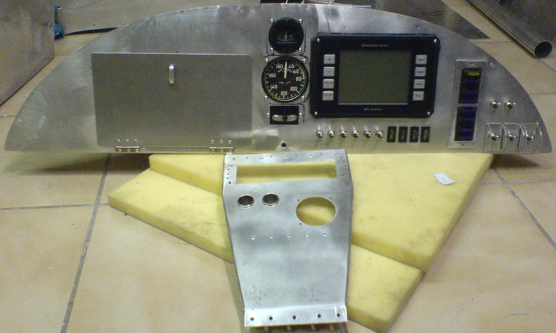

Postby justin.schoeman » Wed Nov 25, 2009 10:36 pm
And, the (nearly) finished panel:
Just needs two LEDs and the co-pilot's PTT fitted. Doesn't look as good as I thought it would, but functionally it is great.

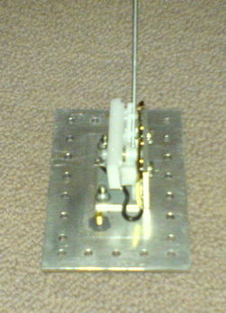

Spent the past two days fixing a mistake... Just about the only welded piece on my plane is the the fuel filler neck, which is already trimmed for a flush fitting cap.
Unfortunately, what I didn't realise at the time was that the standard tank position does not leave enough space at the top for the fuel level sender. Instead of trying to move the tank, I decided to try and put the sender on the side of the tank instead. This required the fabrication of a new bracket and flange.
Unfortunately, in a fit of idiocy, I did not know know how much torque I could get out of each bolt, and how well the flange would spread the torque. So I just put the bolts as close as practical - and ended up with 22 of them! Required an entire evening to drill, tap and clean all those threads.
Seems to work quite well though, as it produces a water tight seal, even without a gasket.

Postby Maybe » Mon Nov 30, 2009 10:12 am
justin.schoeman wrote:And, the (nearly) finished panel:
Justin, its looking GOOOOOD!!
Just as a matter of interest....Why is your panel set up for PIC on right hand side. ? Are you maybe left handed and prefer to fly from the right side....seeing the Raven have center stick?? (Maybe you have mentioned this previously and I've just missed it?)
Also, would your throttle position then be on the right hand side? or middle?
All the best!!

Postby justin.schoeman » Mon Nov 30, 2009 10:32 am
All the best!!
I am right handed, but I am setting up the plane for cross country flying. This means I want my right hand free for map work, and notes. Since I have a center stick, the only way I can do this is by flying from the right hand seat. There will be two throttles, one on each bottom corner of the instrument panel - although only the PIC one (RHS) will have a friction control.
Trim control is going on the centre console, and brakes on the stick, so the plane is fully controlable from both seats.
