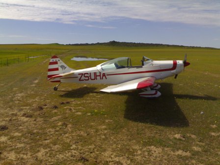

Hierdie nuwe plastiek errouplyns laat my bietjie kop-krap en vrae vra. How old is the oldest plastic aeroplane?? Not exactly time tested and proven, are they? With how much "dignity" will the, for example, Sting, age? My rag and tube and wood Turbi 2 is 25 years old. One of these days I will need to take a knife and cut the fabric off, give attention to everything inside, cover it with a "New Turbi", and off I go for the next 25 years. I will then be 78. Damn, my aerie will probably out live me.
Catch my drift??
Catch my drift??
- open invitation.jpg (31.57 KiB) Viewed 1907 times
