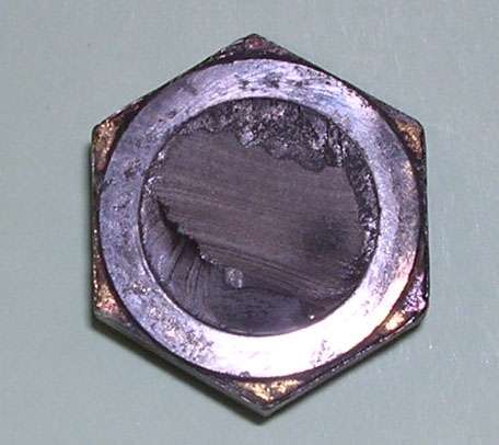

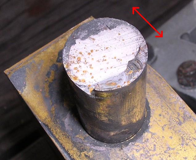

The below photo is of the other RAF 2000 which popped a hub bar bolt head (AN-12) and threw a rotor (N69EP ORTMAYER).
ZU-RHO's bolt head has never been found, but it will look about like this.
N69EP failed during an instructional flight, and in a bizarre fluke the separated rotor whipped back and brained the student.
The CFI/owner had run the rotor set past the 500 hour RAF designated life span, to ~900 hours.
Nonetheless, why can't RAF/RAFSA make a hub bar without a tensile bolt under improper bending loads which will fail <1000 hours?
An aeronautical engineer commented about N69EP's RAF hub bar, calling it "a bad design, poorly executed."

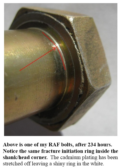

Have any of you RAF 2000 owners taken up my suggestion of checking your hub bar bolt torques?
Please report back to this thread with your results.
Meanwhile, I urge you all to check your hub bar/winglets like a hawk, with a 10x loupe pre- and post-flight.
Also, don't fly too aggressively, as the RAF rotor system is not robust (to put it kindly).

- N69EP ORTMAYER bolt head.jpg (81.21 KiB) Viewed 18037 times

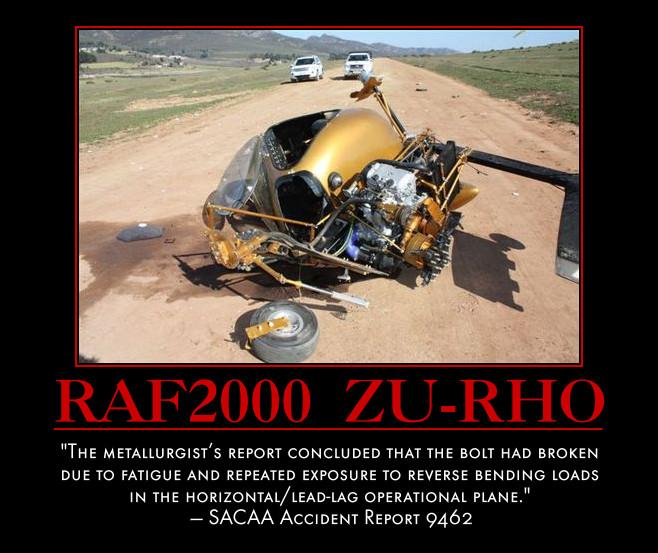

Below are my excerpts from the SACAA Accident Report on ZU-RHO.
http://www.caa.co.za/Accidents%20and%20 ... s/9462.pdf
I've not quoted the full report, but only the most relevant excerpts. Bold emphasis is mine.
Regards, Kolibri
Synopsis
During take off from Avontuur, The pilot reported that he felt a vibration and he was unable to control the aircraft. After climbing to a height of approximately 3.2m above ground level, the aircraft sank without warning and struck the ground, sustaining substantial damage. Both pilot and passenger suffered minor injuries.
It was determined during the investigation that the aircraft experienced a rotor hub bar assembly failure during take-off. The bolt installed between the rotor hub bar and winglet broke. Both rotor blades separated and were flung several metres to the left and right of the runway some distance from the main wreckage.
The rotor hub bar assembly was taken for metallurgical examination. The metallurgist’s report concluded that the bolt had broken due to fatigue and repeated exposure to reverse bending loads in the horizontal/lead-lag operational plane.
Probable Cause
Loss of control during take-off due to fatigue failure of the Hex head high-strength shear bolt.
Contributing factor: Improper maintenance due to the failure to replace old bolt with a new one.

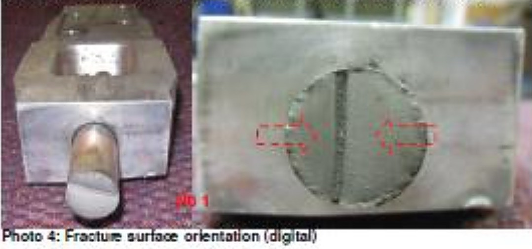

6.1 The visual inspection revealed a fractured attachment bolt of the No 1 Main Rotor blade (Photo 3, red arrow).
The fracture surface showed clear indications towards fatigue as the primary failure mode (Photo 4) while the direction of fracture progression (red dashed arrows suggests exposures to bending loads in the horizontal/lead-lag plane of MR (Main Rotor) operation. This was affirmed by orientating the remainder of the No 1 bolt similar to the still attached No 2 bolt, assuming corresponding fitment techniques.

7.1 The investigation results revealed fatigue to be the No 1 MR blade attachment bolt primary fracture mode while exposed to reverse bending loads in the horizontal/lead-lag MR operational plane.
7.2 The No 2 MR blade attachment bolt revealed comparitive indication of fracture intiation relative to position and orientation with bolt No 1.
7.2.2. Assembly/Design. The investigation results have shown that the washers (No1 and No 2) at both the bolt head ends dimensionally exceeds the slotted sections in the MR blade attachment brackets. During fitment this may render a "false" torque value. When exposed to normal centrifigual loads during operation, the washer mechanically interact with the MR blade attachment bracket with resulting bending damages noted. This may lead to lowering the applied torque with resultant movement of the bracket/bolt assembly in the shear direction (horizontal/lead-lag) as well as the inducement of excessive forces on the fracture prone bolt head radius.

3.1.12 The NAS bolt that broke was recovered for further investigation by a metallurgist, who concluded that it had failed as a result of fatigue due to reverse bending loads in the horizontal/lead-lag operational plane.
3.1.13 The other NAS bolt was also examined by the metallurgist, who found that it had indications of fracture initiation similar to bolt No. 1.
3.1.15 The metallurgist’s report indicated that closer inspection of the NAS hex head, high-strength shear bolt, heat-treated washer and attachment bracket interface revealed extensive mechanical interaction at opposite positions.

3.2 Probable Cause/s
3.2.1 Loss of control during take-off due to fatigue failure of the Hex head high-strength shear bolt.
Contributory Factors
3.2.2 Improper maintenance due to the failure to replace old bolt with a new one.

The bolt failures of N69EP and ZU-RHO occurred when they did due to extraordinary (although different) circumstances. However, those circumstances merely accelerated the timing of failures. They did not cause the failures. The inherent design did. The ¾" bolt (regardless of AN or NAS spec) so improperly used in a such a dynamic joint must fail eventually. It's only a matter of time, and I suspect that it will occur far before the 2000+ hour service life of the gyro itself.
Now — and this is the point which is crucial for you all to understand — such guaranteed failure cannot likewise be said of a properly designed hub bar with multiple bolts used properly in shear. Those bolts are not subjected to the RAF's bending lead/lag loads, and the hub bar is not jointed. Steel has an infinite service life if never stressed beyond its fatique point.
RAFSA can bloviate all they wish about their NAS bolt's tensile strength, as if the only forces acting upon the bolt were centrifugal, and as if these hub bar bolts were pulled apart. This is like a defensive attorney claiming that his client must be innocent of murder because he's never been convicted of theft. The RAF hub bar is not on trial for tensile failure.
My RAF's hub bar had only 234 hours on it, and both NAS bolts had fracture initiation rings at the head/shank corner.
Could my bolts have lasted another 266 hours? Sure, theoretically, but I wasn't going to keep flying it to find out.
Here is its broken AN12-34A bolt shank, protruding through the separated winglet.
The bolt head suffered bending forces in the lead/lag horizontal plane, just as ZU-RHO did (shown in the CrashLAB photo).
Both bolt heads were pried off in the same direction, by the same forces.

It was happening to my hub bar, and I didn't realize it until I'd removed/disassembled it for my Sport Copter upgrade.
How many of you have yet checked your NAS bolts for 180 ft/lbs of torque?
Confirmed that your hub bar and winglets are not deformed under the washers?
Please have a look, ASAP.
