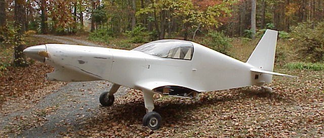

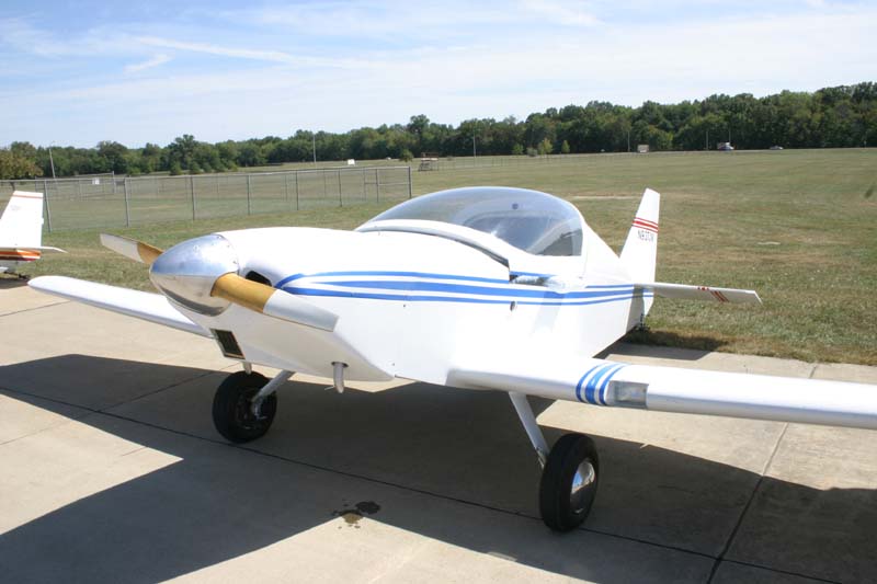

Tx for all the advice. Willie, I'm baffled by the KR2 with the Rotax 582 as per the pics above. I've studied those pics over & over. The seats are in the normal position, yet the engine is mounted only slightly forward. I do not for the life of me see what he did to get the cg in place. Note that he flies two up as well. My 532 is listed as 103lbs empty. Add to that a starter, battery & prop and the difference is not all that much. Yes, my intention is to mount the battery as far forward as possible. I'm also going to pad the back of the seats with thick material to move the seating arrangement slightly forward. I don't think I'm going to install the pre-molded header tank, so I should have much more legroom as the knees can go higher.

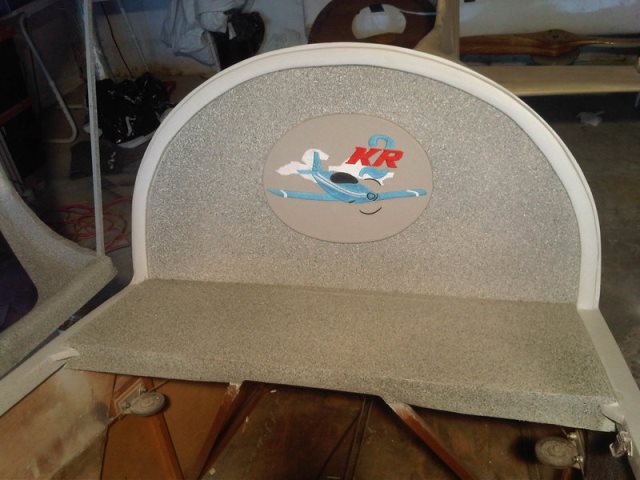

Note: Does anyone have the contact detail for Peter Eich? He used to make fibreglass instrument panels and also seat backrests that could be adjusted forward.
Also, does anyone know what type of paint Craig used to spray the interior of his recently completed KR2 & where this could be purchased from?
The caption below every pic says it all...
