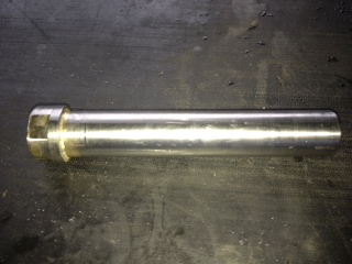

Thanks for the useful advise Mogas. We took out time on the joysticks and all other brass bushes. Had great difficulties getting me hands on a reamer but manage to find a adjustable one! Where the tube bushes are welded on makes it challenging but got it right without sanding the bush. As mentioned we made sure that bushes fit smoothly snug. Controls feel as smooth as butter with no sideward/ upwards play where applicable. Good to know the reasoning of play when using trim.
The blue nylon bearings were a mil to small, we got it into the lathe and took off to accommodate the 38mm control tube. It now fits snug, not putting strain on bearing ends. One think I did which not sure is 100% Is... Where the bearing fits on the control tube we removed the paint and polished up the steel, very smooth. We remove the bit if paint so that its covered flush by the bearing and is not exposed. Should I leave it?

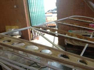

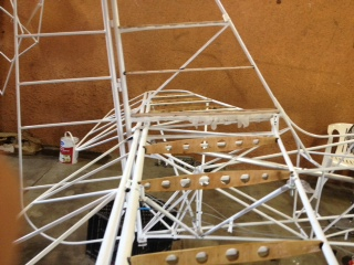

Ribs epoxy'ed and varnished in place

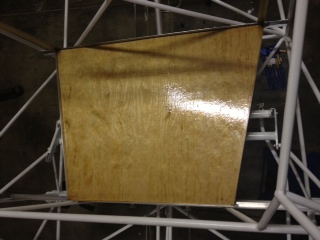

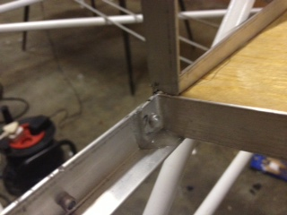

Re: Building the Safari in Maputo

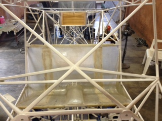

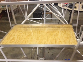

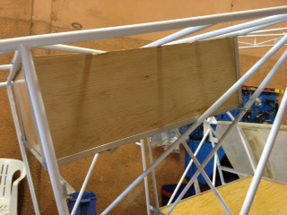

Luggage compartment
- image-4220924748.jpg (60.17 KiB) Viewed 2102 times

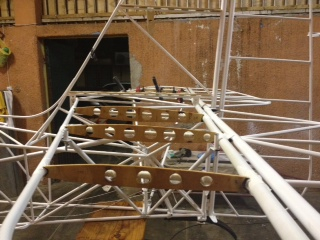

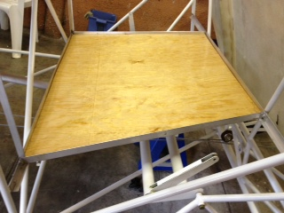

Secondary compartment almost complete

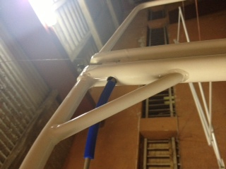

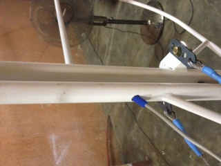

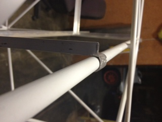

Jumping ahead here with the tail light cable installed. Thoughts?

If you come into SA as far as Nelspruit, pop in for a beverage, I am about as far as you on SN013, we can share ideas. Cheers, Rick oh8too 41ooo32Mozfly wrote:Thanks Oupa-G!
Yes, that's fine, I would lightly grease it as well, so leaving the metal bare is ok.

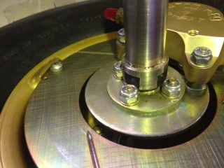

Matco disc installation

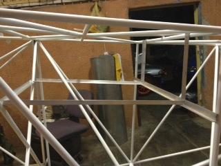

Luggage compartment

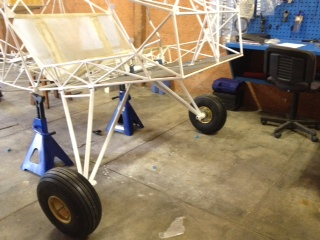

Landing legs dry fitted

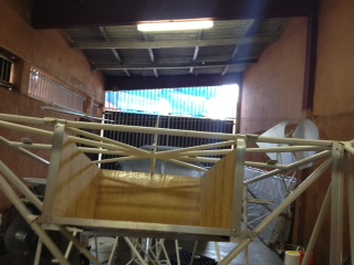

Luggage compartment. Still thinking of what to cover with.

what should be completed or dry fitted prior to covering ?
- KFA
- Posts: 2789
The luggage box must be completed, the mixer installed, rudder cable, floorboards and controls in and trim system fittings under seat and rear must be installed. Also a good idea to have the strobe wire in.
