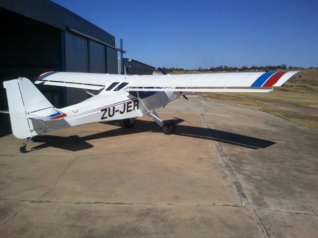

Well done Jerimi,
ZU-JER
ZU-JER
- ZU-JER.jpg (32.92 KiB) Viewed 4387 times

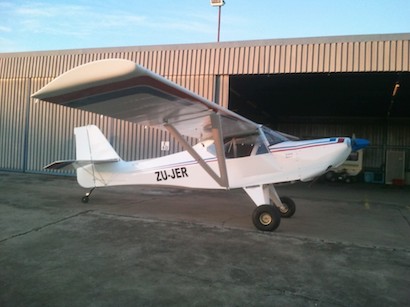

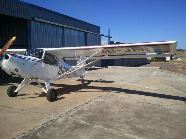

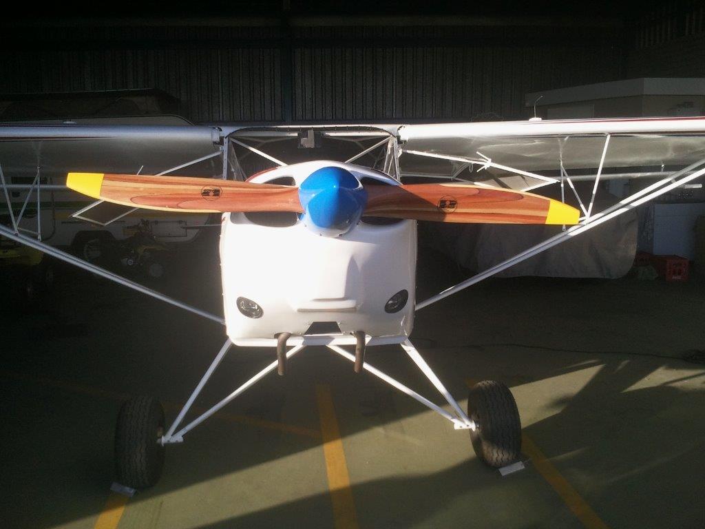

Hi all I have some recent pics of my explorer ,many thanx to Stefan for helping me with my paper work (PFA) had no problems at caa.
Its true what they say when the paper work weighs half the aircraft empty weight you're ready .My big moment arrived yesterday when the test pilot said hes happy with the plane and done the first test flight ,what a moment
.I have almost two hours flight time in it no issues with my exp
