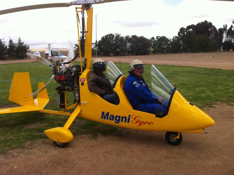

Had a pleasant visit today from Len and Ronnie. Despite the windsock being on honeymoon, Ronnie made a near perfect crosswind landing and takeoff!
Thanks for dropping in

How's that for service?
Ons kom haal sommer die monstertjie
Ronnie Excelled today. Very challenging conditions and he handled them extremely nicely.
Was fun.
