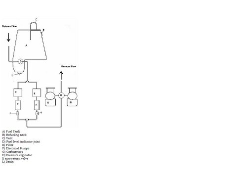

According to the Magni M16 Operators Manual:
Fuel consumption in l/h (USgal/h) 914 UL / F
at take-off performance 33,0 (8,7)
at max. continuous performance 27,2 (7,2)
at 75 % continuous performance 20,4 (5,4)
specific fuel consumption at max. continuous performance 276 g/kWh (0,458 lb/hph)
The fuel that is not used at the regulator goes back into the tank yes. The Fuel-Flow sensor/impellor should therefore be put in-line between the regulator and the carburetor. Most fuel flow devices then allow you to set up 2X on the machine, assuming that both carbs use the same amount of fuel. The MGL works the same. I know that the Optifuel comes with all the pipes and banjo-joints and instructions etc required to make it an easy job. Remember to be extra careful with cutoffs or dirt in the cut pipes - no filter between here and your jets. Also get an AP to do it for you or inspect your work and sign it off in your machines logbook - before you go fly it. please.
