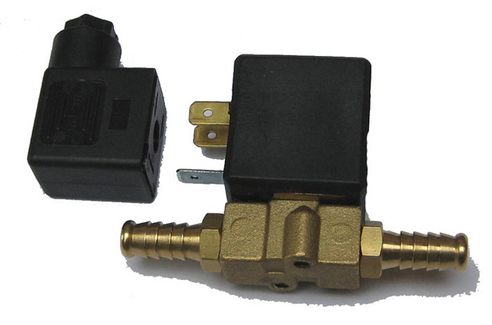

Anti-theft 12V solenoid valve for petrol and diesel. Cuts off fuel when not energised. Bore of 3.5mm. Pressure 0 - 3 bar, flow coefficient of 0.28. 8mm OD. Protected to IP65.

Now you just need a way to energies the solenoid in case of impact.If you install it between the fuel pump and the injectors with a back flow to the tank, it will probable relieve the pressure in the line before it could rapture and make a vapor. you still need to cut the power to the pumps in the same time.The positive here for me is the fact that the solenoid would be close under normal flying conditions and therefor the chance for malfunction in flight is minimize.

The other idea is to install normally closed electric fuel cut-off valves at the two outlet points on the tank. The idea is that when the electric power is cut, the dual fuel outlets on the tank is shut off. Dual redundancy, independent wiring, pilot lights indicating each solenoid’s energisation status as well as a fuel pressure gauge upstream of the electrical fuel pump will be required. Yes, the fuel will shut off in the event of a total electrical power failure, but so will the engine given electronic ignition/ECU as in the case of the RAF. Saraf has posted an example of such a solenoid valve. The search is on for the most suitable one on the market. Any suggestions? Ok, so this is the first line of defense – we must try and keep the fuel in the tank and then hopefully the tank holds together.
